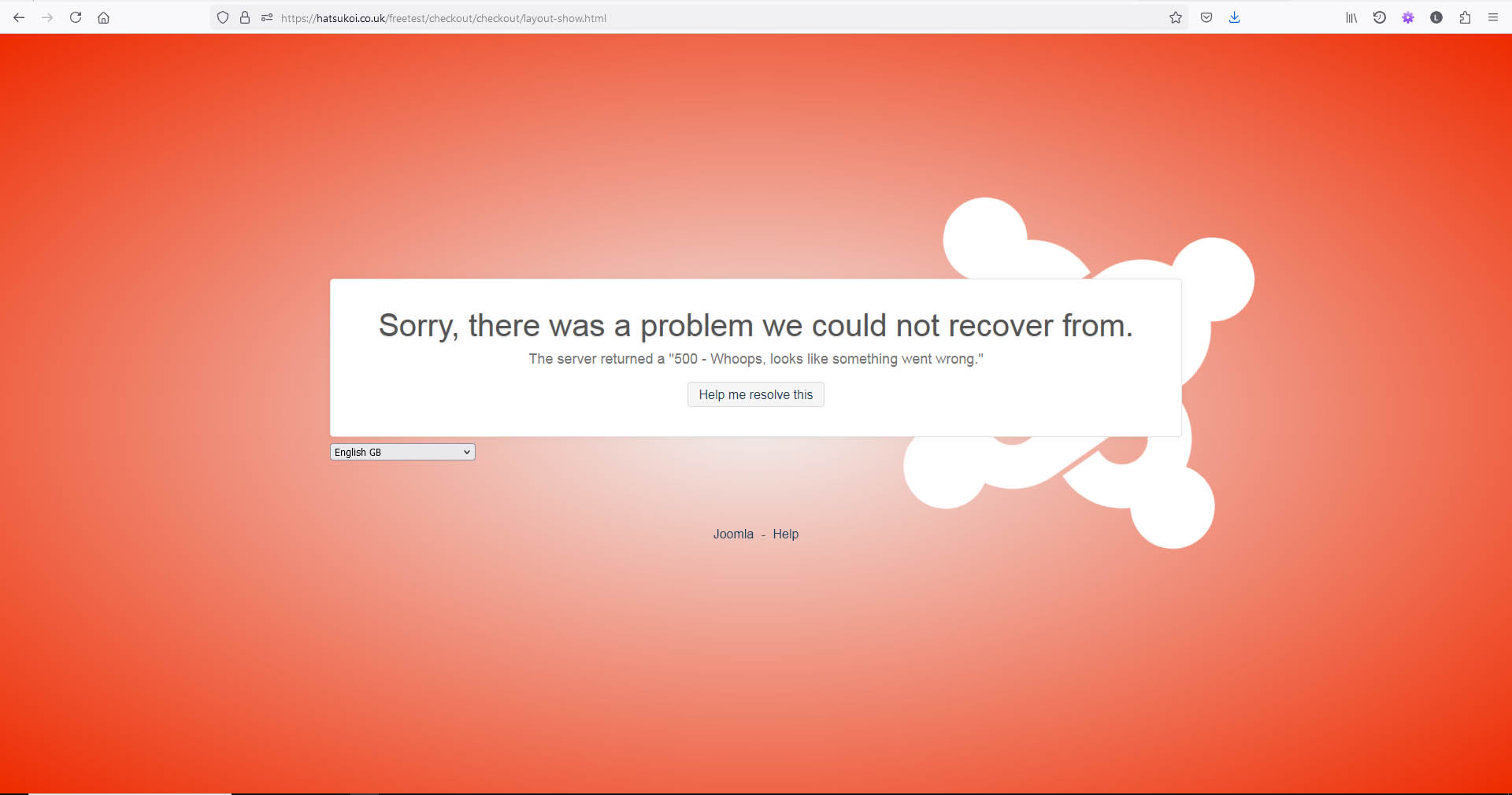

It all seemed to work OK until I noticed that if you come out of the checkout and then try to go back using the basket link, it causes a fatal error.
I am working this test site:
hatsukoi.co.uk/freetest/
You can add any items to the basket and then use the code FREE at the checkout to load the free product. However, if you click on the mini basket module, for example if you look at another product, you then get the red fatal error screen (attached).

1 year 10 months ago #362647
Your issue seems to be linked to your Google Analytics plugin.
Can you confirm that you are using the latest version of the Google Analytics plugin?
If you aren't sure, you can update to the latest version for free to see if it can solve your problem.
You can't get the latest version, here .

1 year 10 months ago #362656
Hi Philip
That fixed it! I updated the GA4 plugin and it all works well now. Many thanks for your help with that, I really appreciate it.
