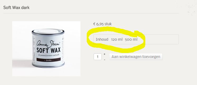

I went through the documentation but I have one problem and one question about it.
1. The problem is that if you set the Characteristics selection method to Radio Button and you change the css as in your example.
Then all other products that have characteristics (without image selecting) are no more user friendly. Because the dropdown or radio buttons are gone. See image: "dropdown-is-gone.JPG"
I Hope you have a solution for this, like a product class or something? But I see no option for that in Hikashop.

  • Posts: 86095
  • Thank you received: 14199
10 years 3 months ago #241491
I suppose that you're talking about the CSS from here:
www.hikashop.com/support/documentation/2...y-color.html#results
As you can see, it bases itself on the class hikashop_product_characteristics_table
So since you want to modify the show_default view file, you could simply use instead a new class that you would put in a div around the area where the characteristics are displayed on the product page.
That way, it would only affect the products using this new layout.
And regarding how to create that new layout, it's quite easy. You need to edit the show_default view file, and when you save your changes, you can enter a new name in the input at the top of the view file edition interface. That way, if will be saved as a new view file and you'll be able to select it instead of the "default" layout in the "product page layout" setting of the products.

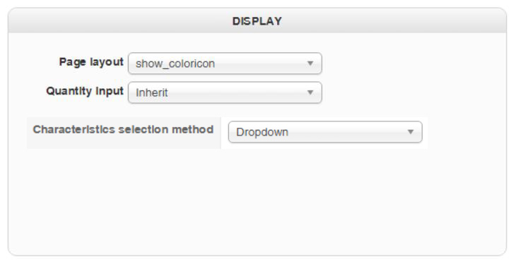

How can I fix this issue?
Or is it an idea that you can choose the characteristics selection method for the choosen lay-out on the productpage in the back-end?
Like the option to choose for the Quantity Input on the display area. See screenshot
Hope to hear from you.

10 years 3 months ago #241801
In each characteristic setting, you can change the characteristic display method so that it is more adapted to what you want for that characteristic. That should meet your needs as I doubt that you have different products using the same characteristic that you want to display differently. If nevertheless that what you want, it's also possible with a simple line of code at the beginning of your custom layout:
<?php $this->params->set('characteristic_display','dropdown'); ?>
Last edit: 10 years 3 months ago by nicolas.
