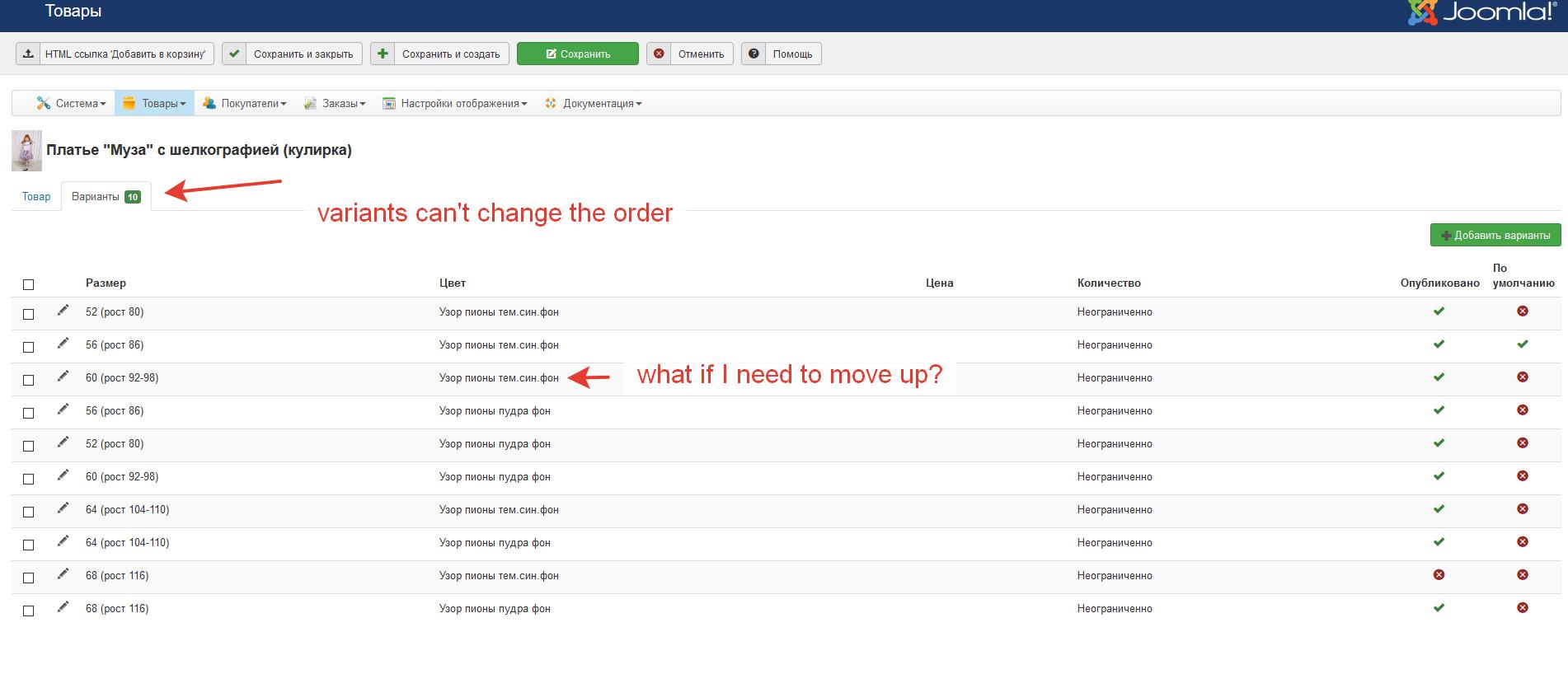

Hi !
When I add variants to product I can make a mistake or need to add one variant later...
What if need to change the order of variants? (for me - the sizes of clothers)
I think that this feature will be very helpful!

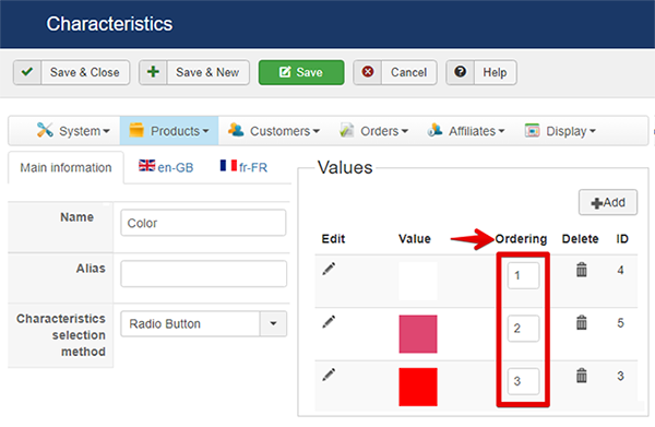

You can sort your variants in your characteristics configuration page, in Main HikaShop configuration in Products dropdown select Characteristics, and click on your required Characteristic to edit order like this :
Hope this will fit your needs.
