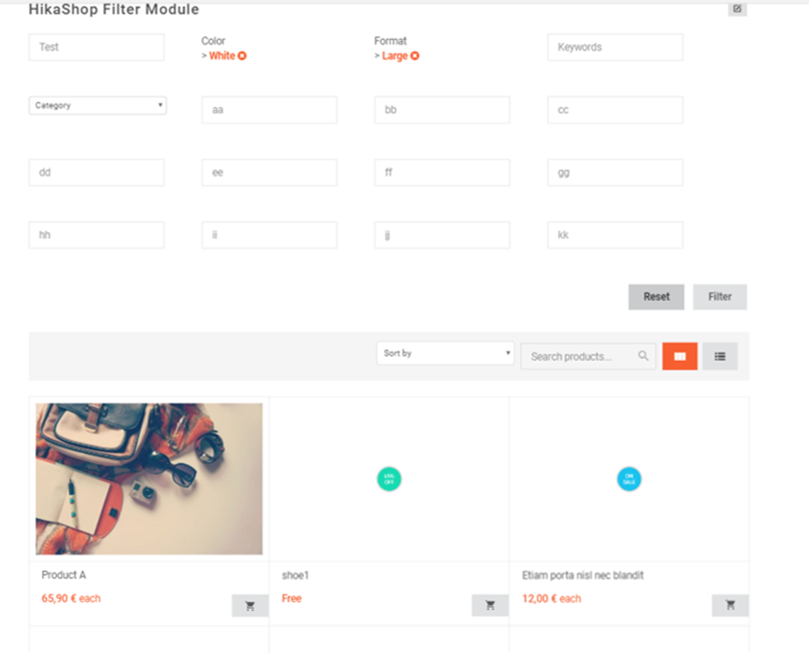

Hi, I have problem with proper functioning of filters – In fact with filters reset either using Reset Button or using mark “x” for deletable filters. I thought that the problem might be caused by the URL length as discussed on this Forum Thread and I have implemented proposed change in media/com_hikashop/js/hikashop.js – so URL address after filters are set looks like that
Code:
/shop/products
However I did test with more number of products which caused pagination of product listing. After I change the page from the first 12 items to see another page (for example to the next 12 items) URL structure is changing and include filter parameters and it looks like that:
Code:
/shop/products?limitstart=12&filter_Test_1=&filter_Color_2=White&filter_Format_3=Large&filter_Keywords_6=&filter_Category_5=none&filter_aa_7=&filter_bb_8=&filter_cc_9=&filter_dd_10=&filter_ee_11=&filter_ff_12=&filter_gg_13=&filter_hh_14=&filter_ii_15=&filter_jj_16=&filter_kk_17=&filter=1
– although this URL is very short and shouldn't cause a problem
Then after I use Reset Button filters are reset and full product listing is presented but filters in the Hikashop Filter Module are still presented as they were set (I am attaching an image).

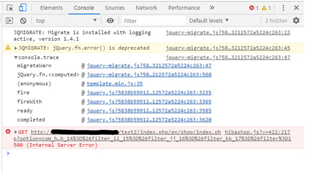

I checked message in Console and it looks like below (no error message is reported in everything.php file from System Debug):
I have no customization in filter.php. This problem also occur using Prostar Template.
I would like to ask for help in solving this problem.

6 years 9 months ago #313858 by Greg_C
Replied by Greg_C on topic problem with filters reset
Hi Philip, Please find below scenario to reproduce problem with reset button (I have sent new test site address using contact form):
Browser: Mozilla Firefox 71 (but it should be also possible to reproduced on Google Chrome 78)
User: Not logged
Scenario
- Set Filter: Category: Travel
- Click on Filter Button
- Click on Reset Button
- Go to Page 2 (pagination toolbar)
- product listing is reset but filter (in this case Category) in Hikashop Filter Module are still showing as set
Additionally I found another problem with functioning of filters - problem is related with wrong presentation of filters after product page visiting - please find below two scenarios how to reproduce this problem
User: Not logged
Scenario A
- Click on Reset Button (in consequence all filters are clean)
- Click on any Product Image to open Product Page (for example first image on the left - first row)
- Click on back button on browser navigation to back from Product Page to Product Listing page
- After returning to the Product Listing Page, instead of empty filters, we see filters that have been reseted before going to the product page
Scenario B
- Go again to Page 2 (pagination toolbar)
- After returning to the Product Listing Page, filters are not set (as they were presented before going to the product page) - we see all filters clean (reset)
Greg

6 years 8 months ago #314715 by nicolas
Replied by nicolas on topic problem with filters reset
Ok, I was able to get the problem on your website now.
Looking at the situation, I can see that the AJAX request sent to the server to refresh the filter module gets back a 500 error message:
monosnap.com/file/XHb5YE2WZ1lf2vKvTw46bMUnHfjHcx
So because of that, the filter area is not refreshed and thus you still see the filters set.
I don't know why you get that.
Could you check the PHP error log of your server ?
It should contain a "fatal error" message corresponding to that 500 error which should help us understand what is going on.

6 years 8 months ago - 6 years 8 months ago #314845 by Greg_C
Hi Nicolas, I have found that after deletion in product/filter.php the line 111 with the code
Code:
$submit = 'window.hikashop.refreshFilters(this);';
filter reset is working properly. So maybe the reason of the problem is the same as discussed on this Forum Thread #309158, which was solved by you by adding a patch for that
Greg
Last edit: 6 years 8 months ago by Greg_C.

6 years 8 months ago #314876 by nicolas
Ah ok, I see. I was looking at another file.
Removing that file from product / filter.php basically deactivates the ajax on the filter system.
Since you have them along with the products on a full page, deactivating the ajax is fine as it won't change much speed wise. And it will circumvent the issue you have with the ajax request for the refresh of the filter module area returning a 500 error.
So that can indeed be a viable solution for you.
