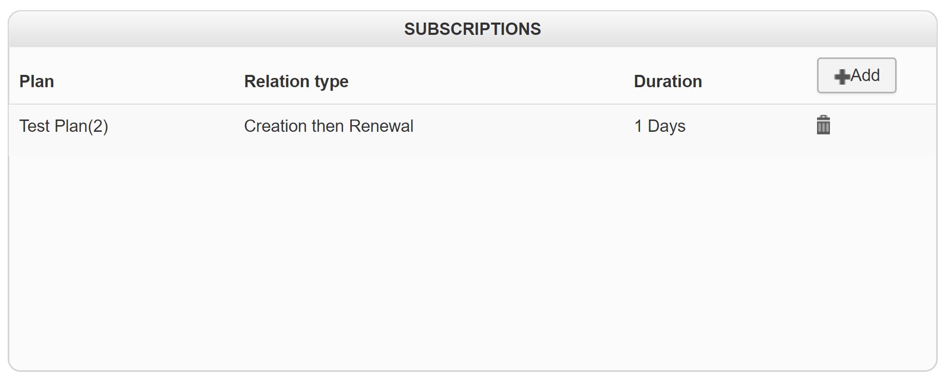

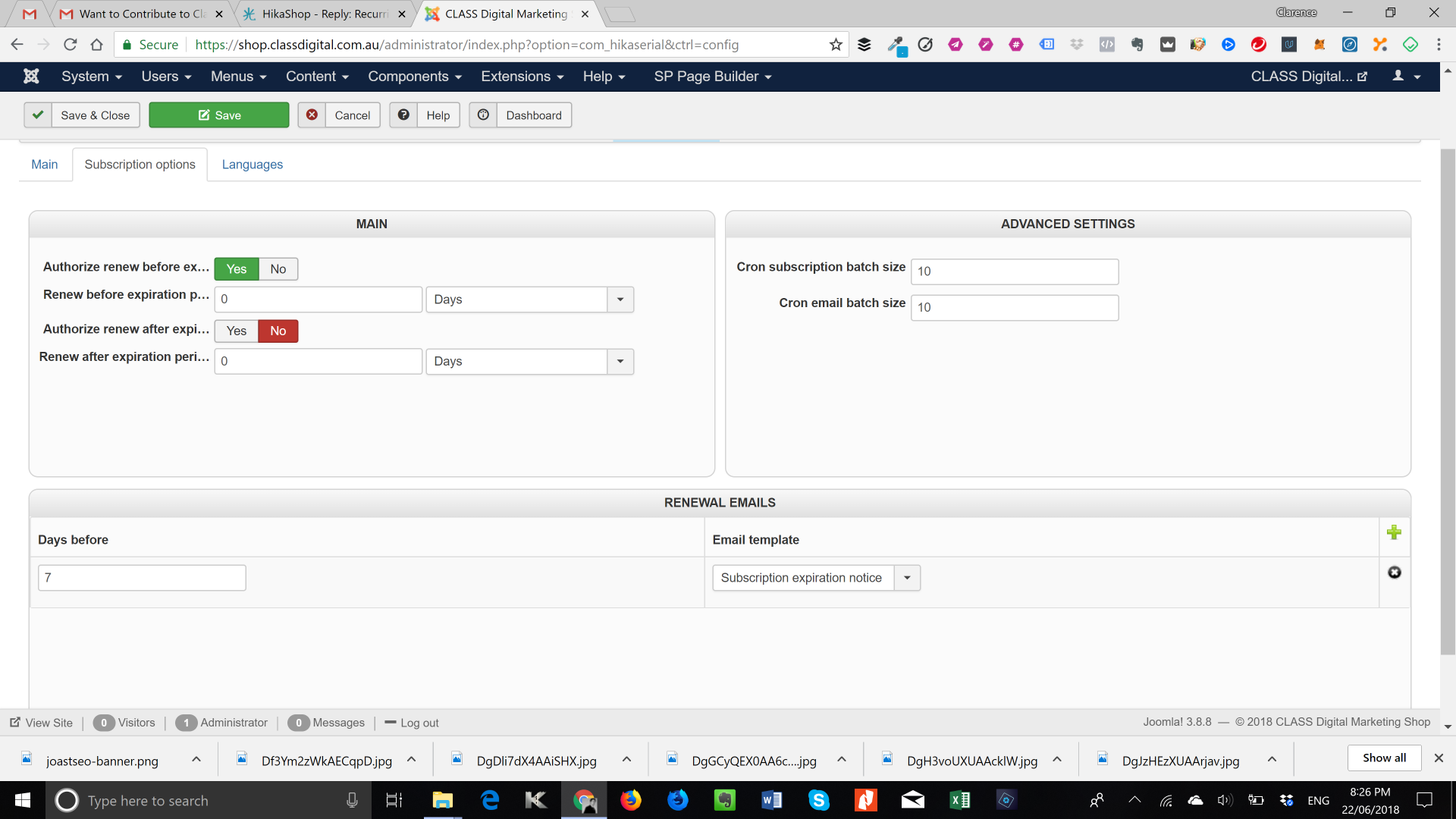

I followed all the instructions in the tutorial, as I explained. However, it doesn't work. Here is my configuration attached.
The PayPal recurring is not working. Do I have to manually activate PayPal recurring?

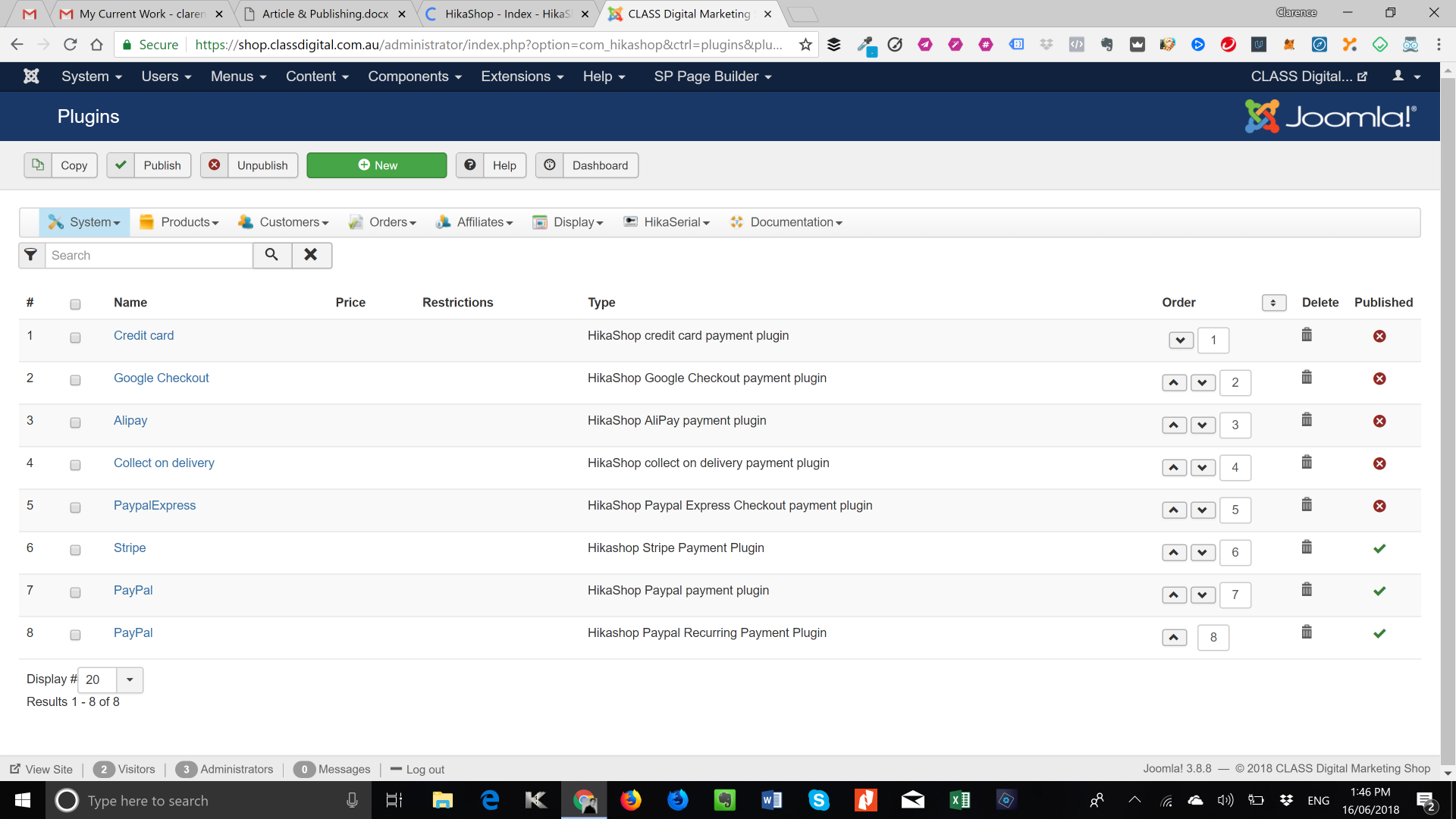

I have found and activated the PayPal recurring plugin via Payment Methods as instructed. However, the same problem remains.
Can you please investigate my website? See attached for reference. None of my plans are recurring.
Thank you.
8 years 2 months ago #294141
If you want us to understand the situation, you would have to provide screenshot of your configuration and details about the problem.
Since you had not any recurring payment plugin installed/configured, you couldn't use any recurrent payments (so there is no way than a subscription be renewed). Because I don't understand how you could confirm a recurring order without a recurring plugin and I'm not even sure that you're using the recurrent plugin to do so ; I can't tell you anything. I don't understand a thing, you do not provide a lot of explanations.
And in the case where you want me to have a look at your website, you know that I need some details to start, like a link to your test product ; so I could try to reproduce the issue.
But right now, with the current elements and details, please understand that you have to help me to help you.

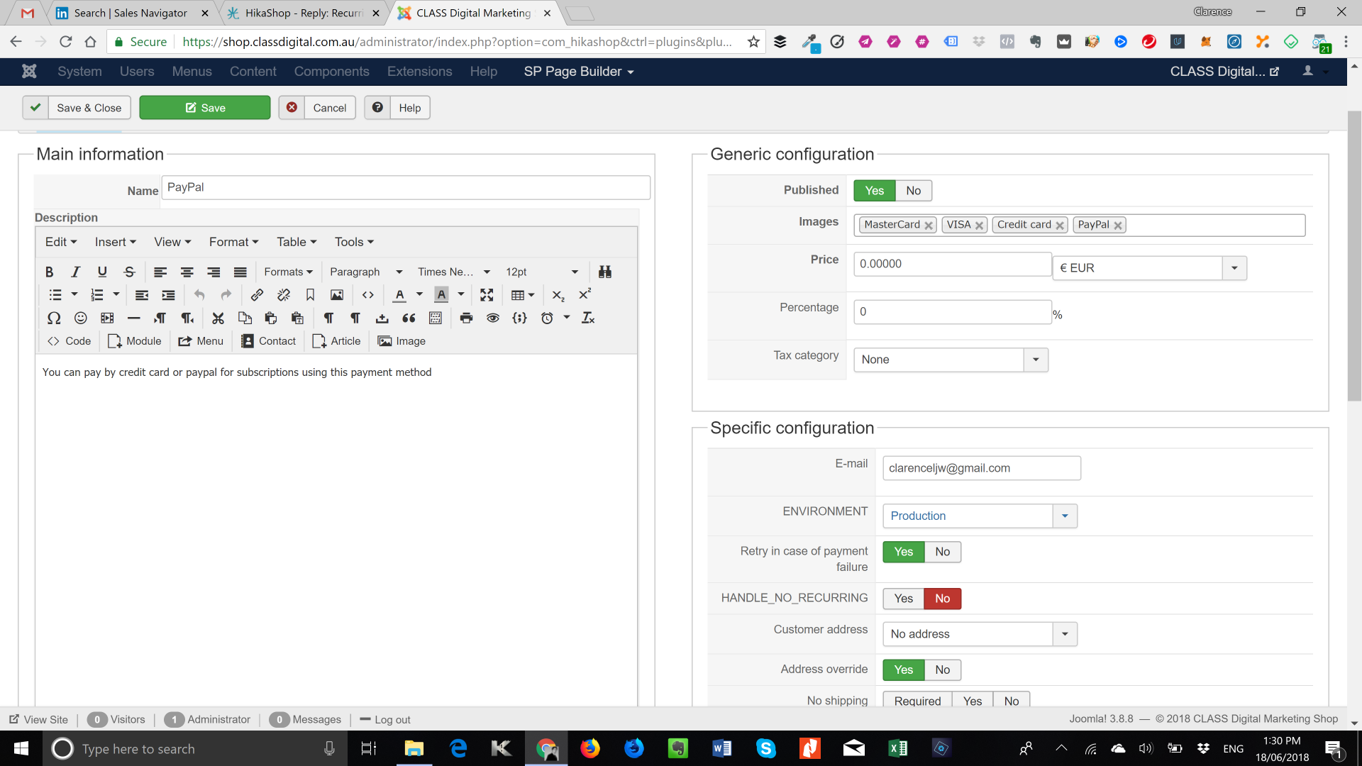

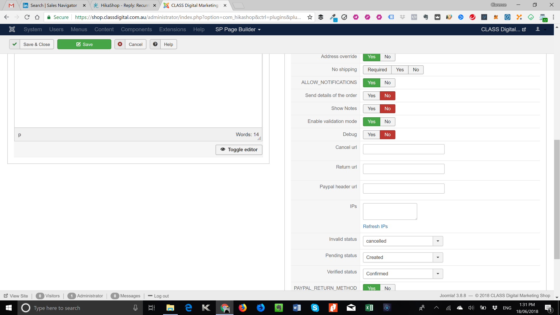

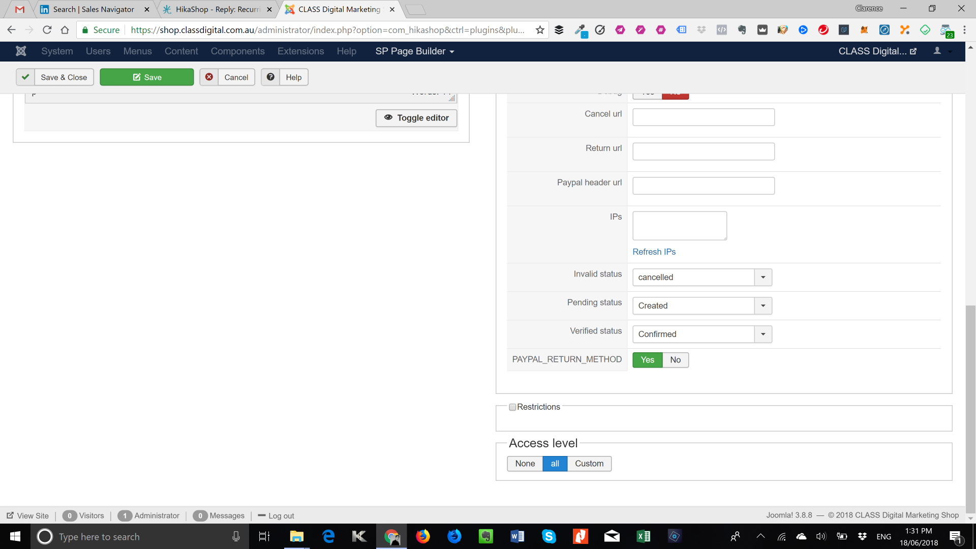

I am sorry I am taking so much time, and I want you to know I appreciate your help. I want to cooperate with you to fix these issues. Attached are photos with the settings for my PayPal recurring plugin, which I have activated with your help.
Please let me know if I am doing anything incorrectly. What are the optimal settings for the PayPal recurring plugin?
I look forward to your assistance. Thank you.

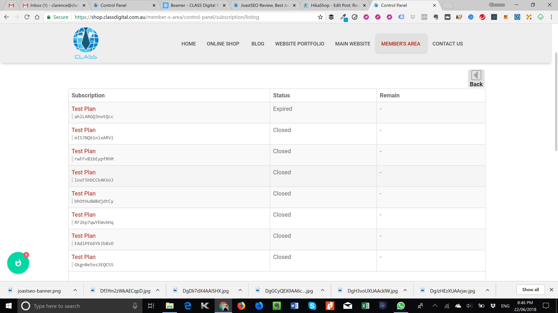

I'm sorry but it's still not possible to understand if you are right using "paypal recurring" during the checkout.
Please read carefully my previous message.

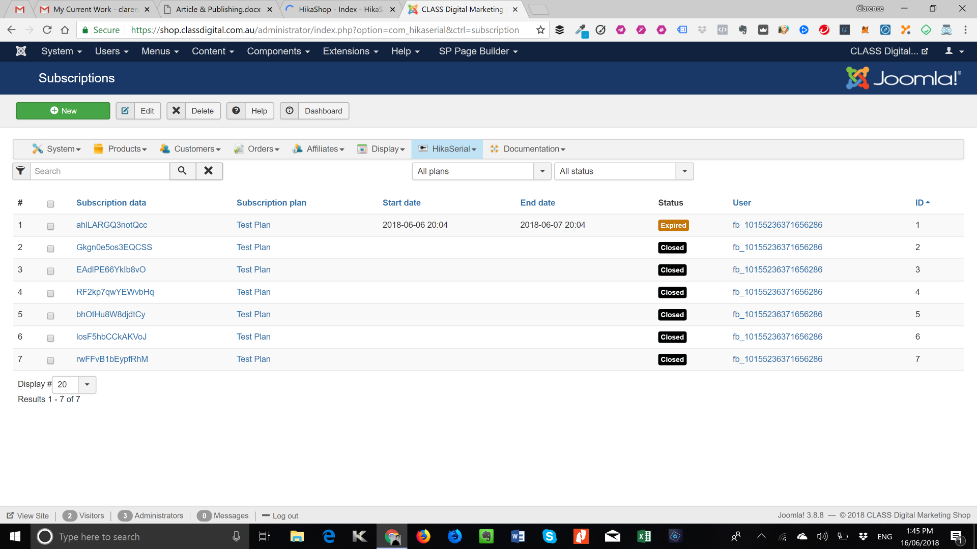

More than that, if you take a look at your subscription listing screenshot, you can see that only one subscription was really created (on 06/06), all other are just pending subscription where the order never been confirmed (otherwise you would have a start and an end date).
Since you just have one old subscription which haven't been renewed but you weren't using Paypal recurring that time (you activated the plugin several days afterwards) ; I don't have the impression that your issue is really the recurring.
Anyway, I do understand that you want to help and provide details but the paypal recurring screenshots are unfortunately not relevant with what I was asking you in my previous message.

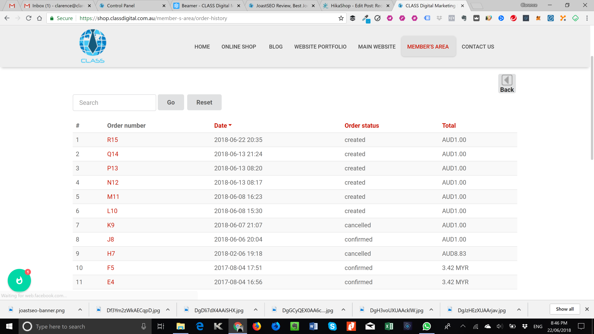

Despite creating a subscription plan, one 1 day and another 1 month using "create then renewal", with the PayPal recurring plugin activated, all my subscriptions expire after the term, e.g. 1 day. There is no recurring.
I also notice that subscriptions are not confirmed despite being created. I made these purchases via PayPal, see attached.
I hope this will help you assist me, please let me know if you require any more information. Thank you.

Your order never been confirmed, never been paid.
So your subscription never been active.
That's sure that they won't be renew since they are not paid.
