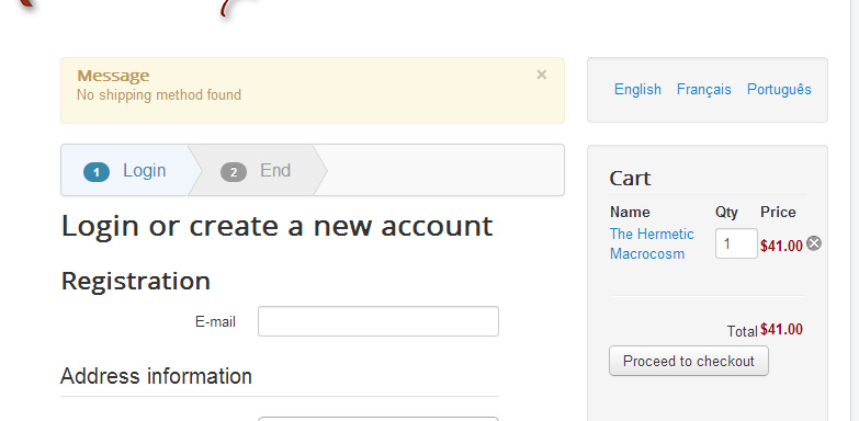

I am using Joomla 3.
All is quite ready but during my test I have always the message: "No shipping method found"
See below.

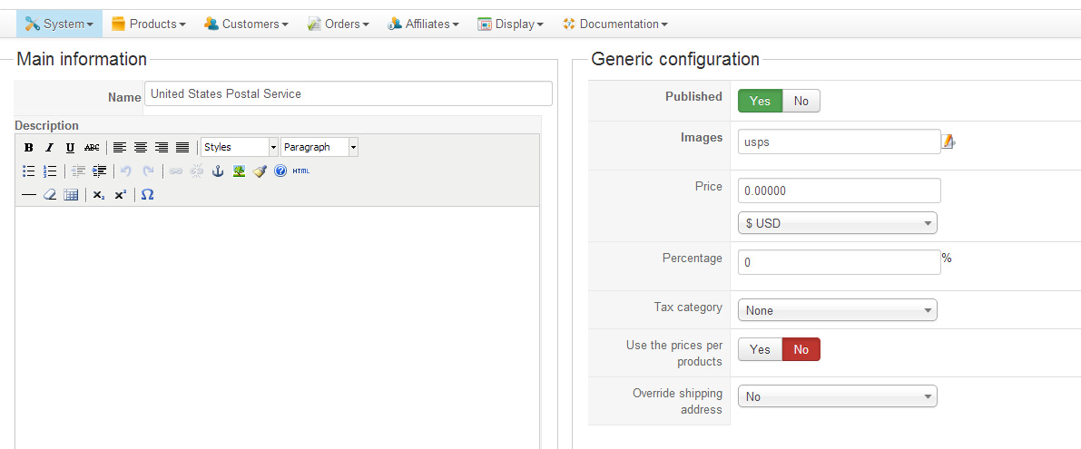

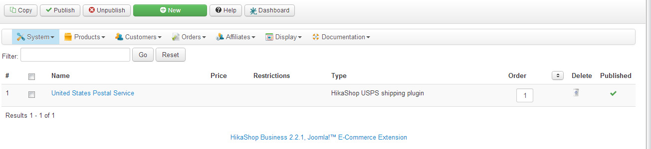

This is what I have. (If you want I give you access to the administration of the website)
Thank you for your help!

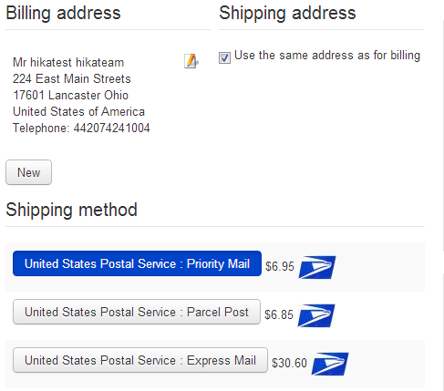

12 years 9 months ago #121058
I've done some tests and it seems like the shipping method is correctly displayed, so did you solved your problem ? If not, the problem is provably coming from the fact that your products don't have dimensions/volume or that your shipping address is incorrect for the USPS shipping method.

12 years 9 months ago #121204
I've done some tests with your product category / FRANLJAIS / Encens / Tradition de l'Aurum Solis / Encens de Purification - 1 product, and it seems to be working fine even without any dimensions.
So can you show me what is the shipping address that you are using ?

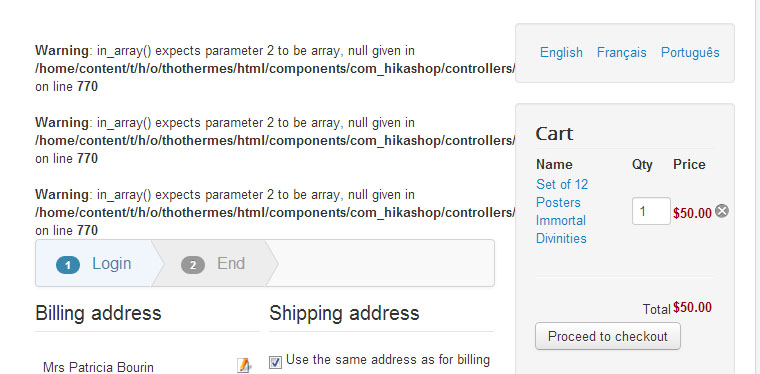

1- the system is showing warnings at the top of the page (See below)

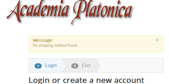

2- The message "no shipping method found" is still shown until the buyer is providing his address. That can be confusing. Is there a way to avoid this message at the beginning?

1. You'll probably find the solution through this thread .

2. My solution would be to :
- Go to "Hikashop->System->Configuration->Checkout"
- Put the "Login" action through the first step
- Put all the other actions through the second step
PS: I already done it but you know how to revert this change :).

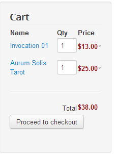

I did the change suggested in the thread you indicated, but then when I was adding a product, the page became white and frozen. I did that two times with the same result. So I came back to the original code of checkout.php... and then the "delete symbols" in the cart disappeared (see below)...
Regarding the warning codes, I will run a test in few minutes to see if they are still there but to change the code was unsuccessful.

Regarding the warning message you can maybe replace your "YourWebsite\components\com_hikashop\controllers\checkout.php" file by the following file :
