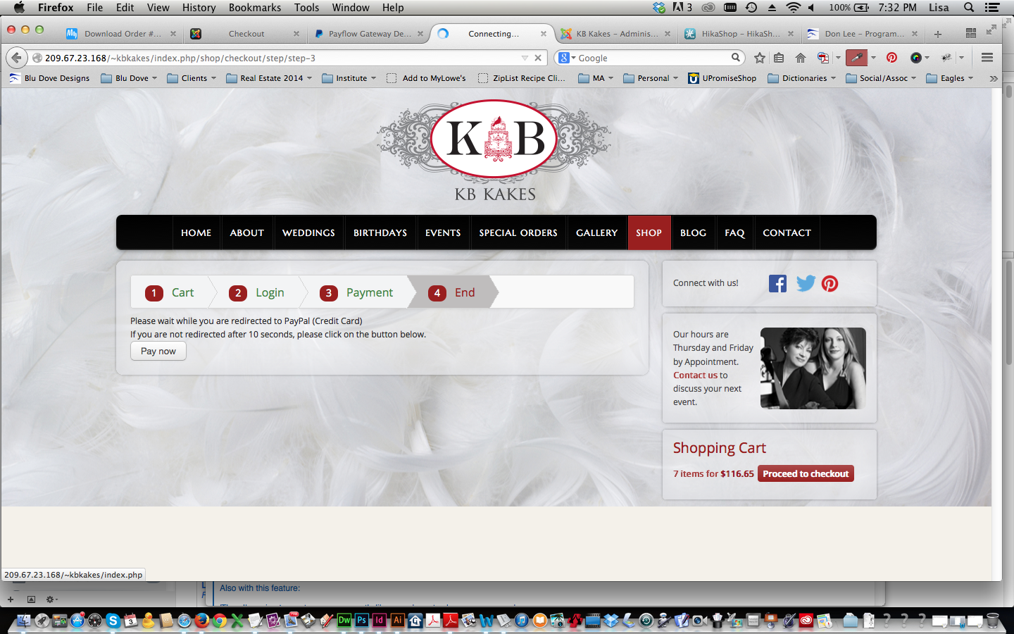

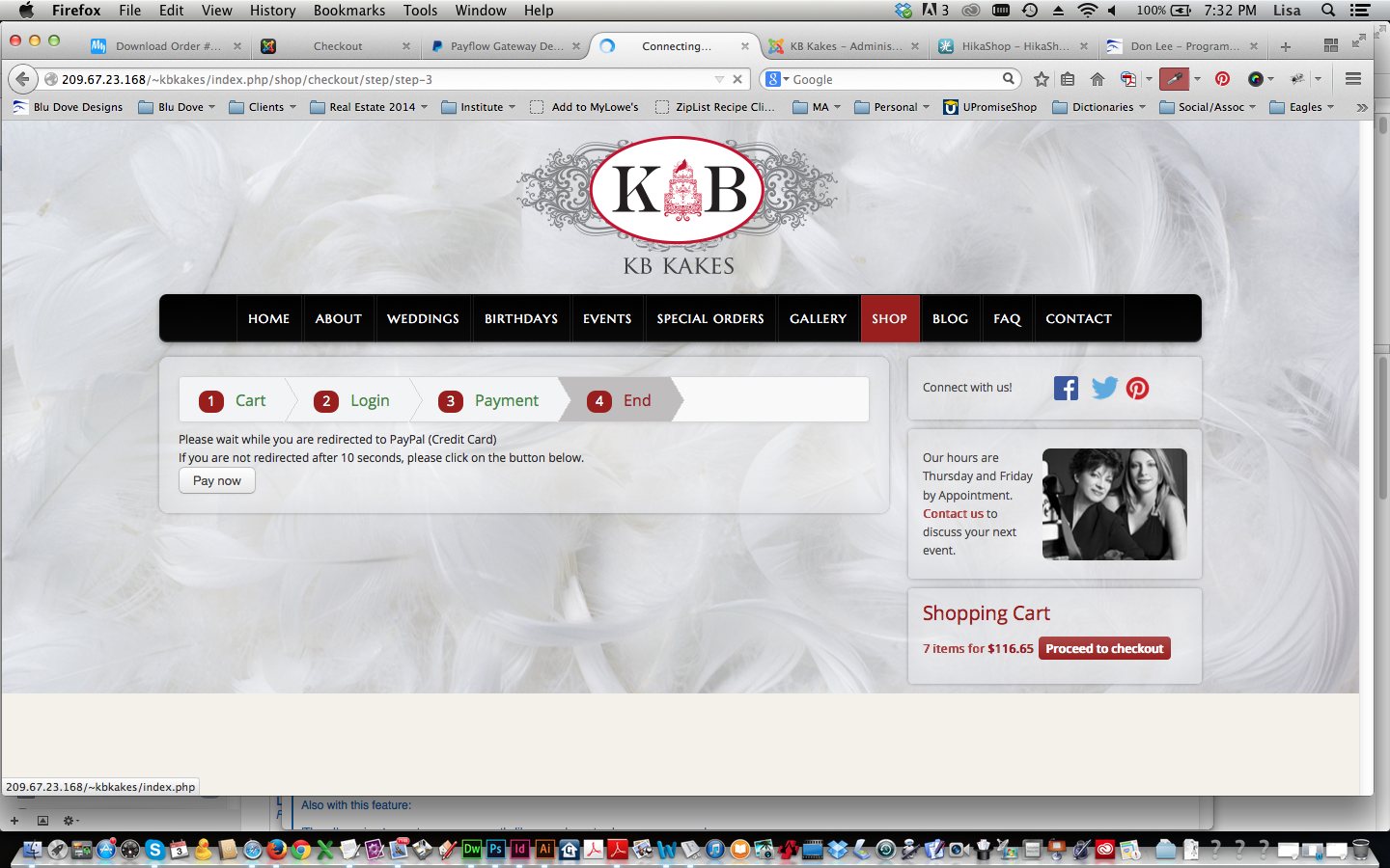

Everything works fine until I get to the "finish page" on the cart. When I click "finish" and it redirects to paypal, the footer portion of the page completely disappears. I try to firebug it but that doesn't work. Also I edited the CSS for the checkout process, however you will see that on the FINISH page, it changes back.

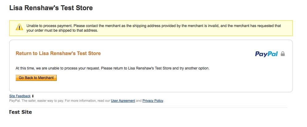

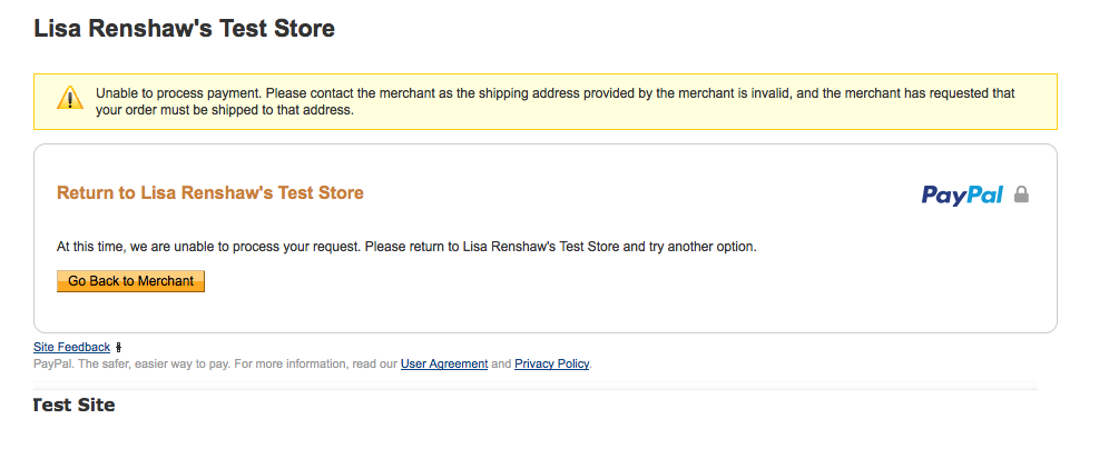

The second thing that happens is that I get an error on the paypal developer site. "Unable to process payment. Please contact the merchant as the shipping address provided by the merchant is invalid, and the merchant has requested that your order must be shipped to that address." I have checked everything I can think of. I'm logged into the developer site when I'm testing. I have the right credentials in hikashop and it still won't work. Though it worked the other day. I cannot find anything on the paypal developer site either.

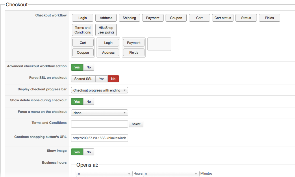

1. Reading that thread will probably help you : www.hikashop.com/forum/4-how-to/61472-fo...age-of-checkout.html

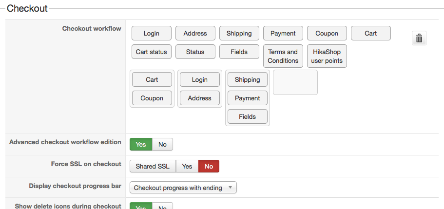

2. Do you have a address step through your checkout workflow (you can check it through "Hikashop->System->Configuration->Checkout") ? If not can you add an address step, and test it again ?
Thanks.
  • Posts: 61
11 years 11 months ago #163272
I do have an address step. I would have figured you would have had a look at my process. What do I do since I already have the address step?

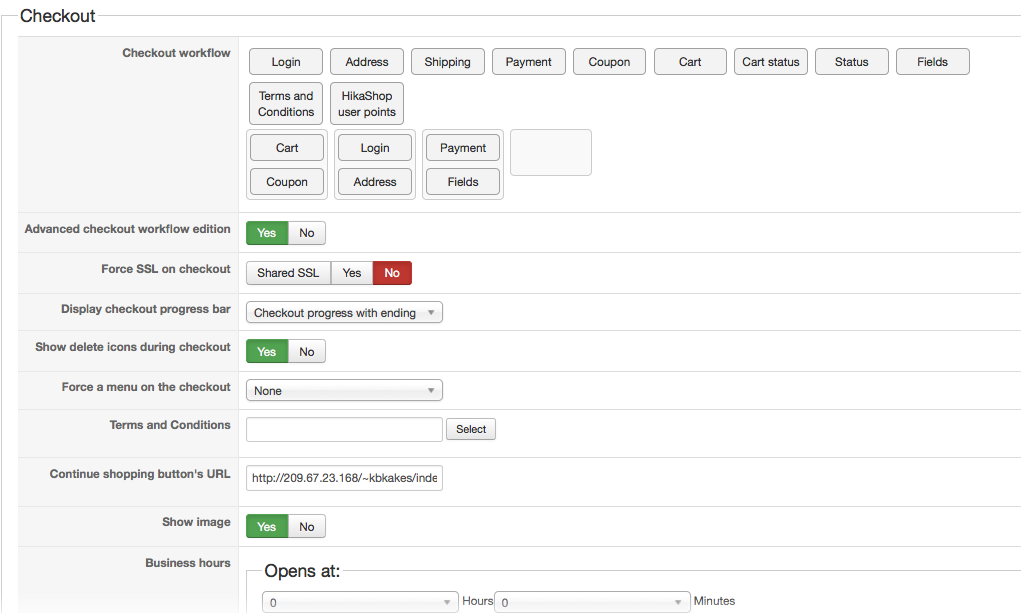

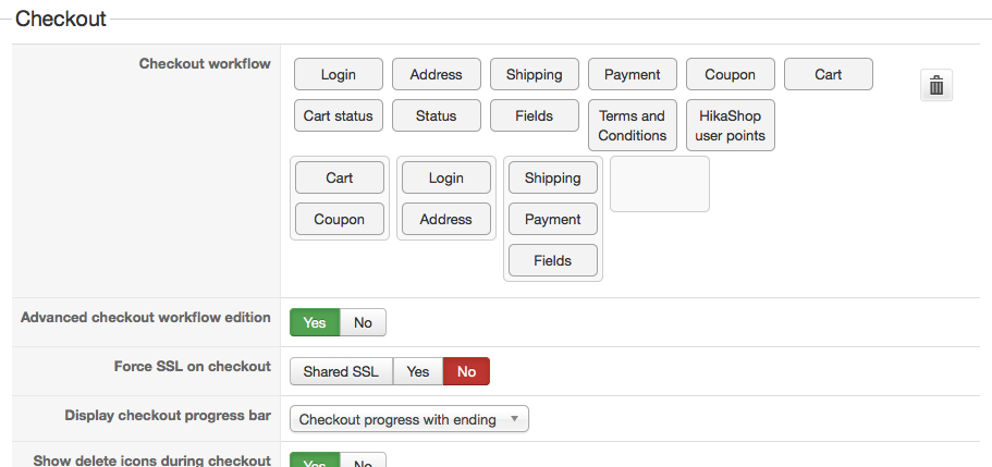

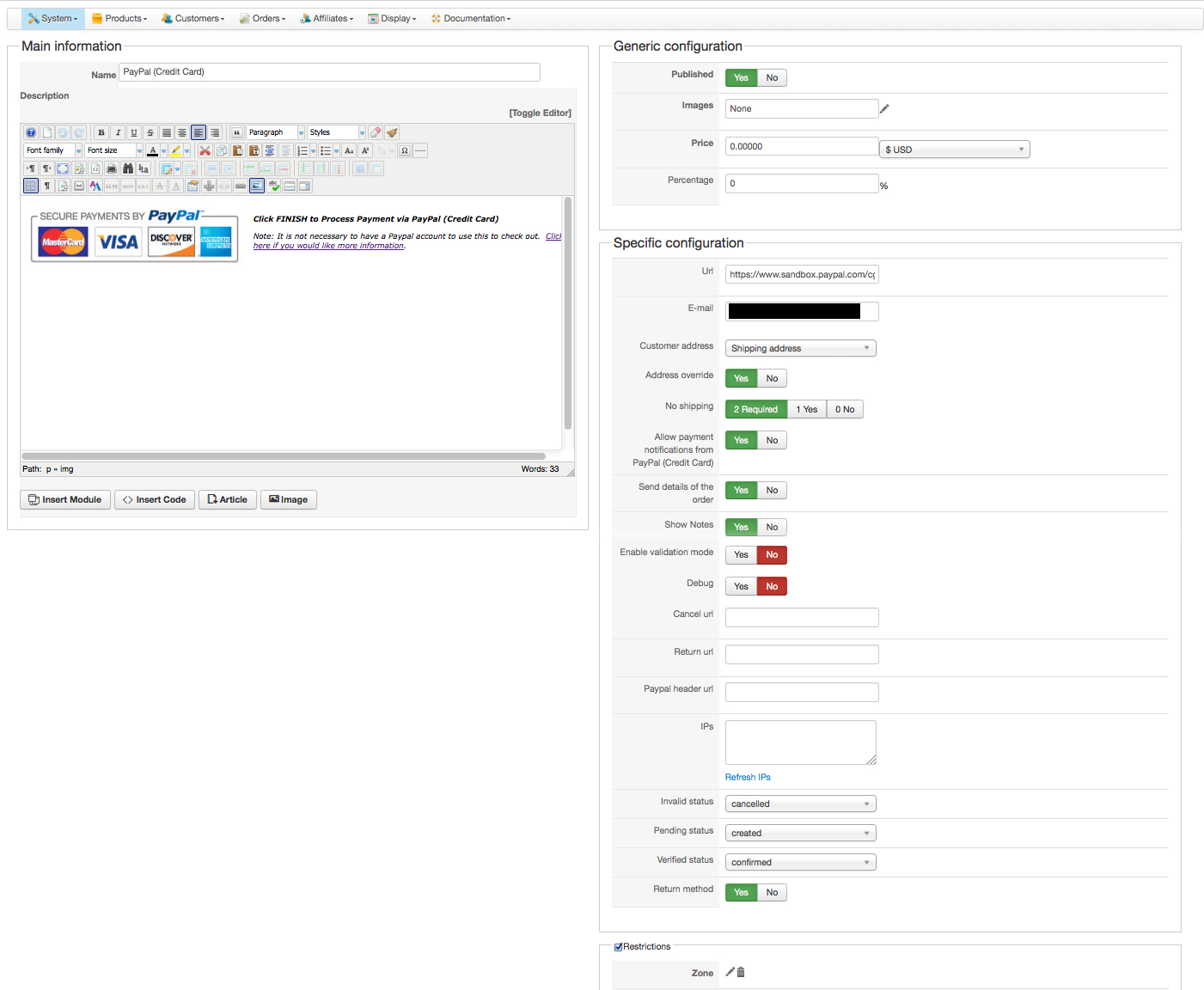

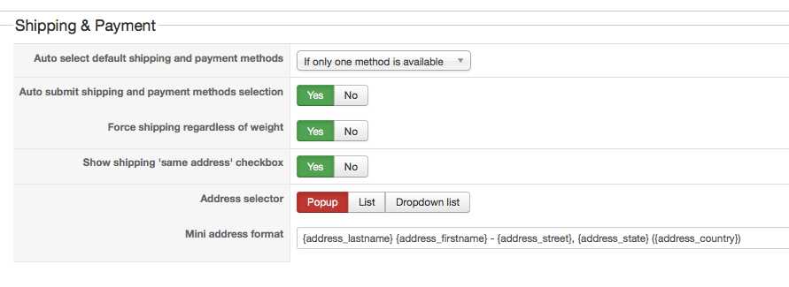

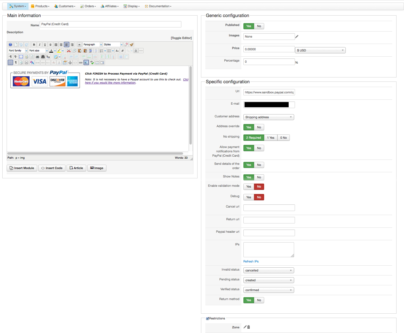

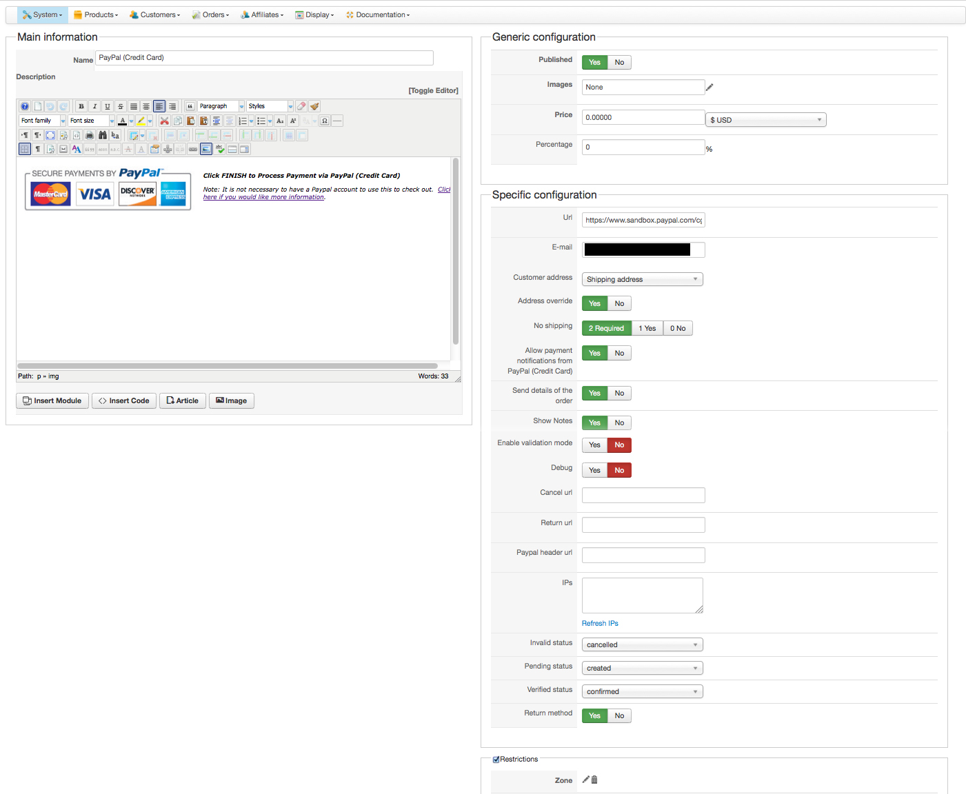

Could you give us more details on your address params, like some screenshots of your custom fields of the address table ?
And a screenshot of your PayPal payment method configuration ?
  • Posts: 61
11 years 11 months ago #163355
Since I am not sure what you are exactly needing so I'm sending you what I can think of with the paypal email blacked out. Note: I am in test mode so I have the sandbox url for the paypal url. I have tried the test process while logged in to my developer account and while I wasn't logged in. I've tried it on safari, and firefox and I get same errors.
If you would like I can private message a Joomla Admin if you need to take a look further.
11 years 11 months ago #163370
In the paypal payment methog settings, could you click on the button "Refresh IPs", enable the debug mode and then try to create a new order.
After that, go in Configuration > Main > Files, and open the payment log file, thanks to give us the returned error message if there is a message.
  • Posts: 61
11 years 11 months ago #163599
I did what you said and have successfully run 3 test orders. So it looks like it is working now. Thank you

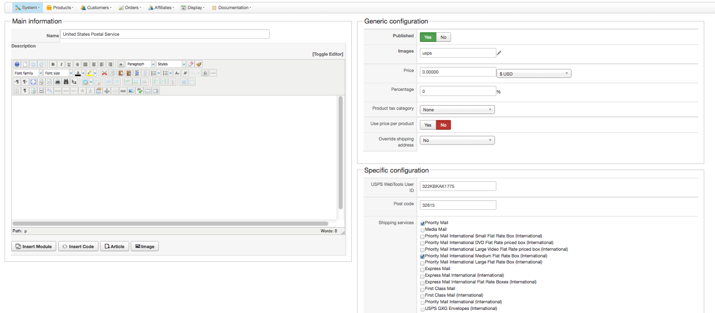

1. This seems not to be related on the previous problem. Do you have create valid shipping methods for your products ?
Are they covering any weight, zones, etc ?
2. Have you tried what Mohamed suggested here : www.hikashop.com/forum/install-update/86...sappears.html#162917 (part 1) ? If your footer is a module, you have potentially to assign it on all pages, or in Configuration > Checkout, select a menu with this module for the option "Force a menu on checkout".

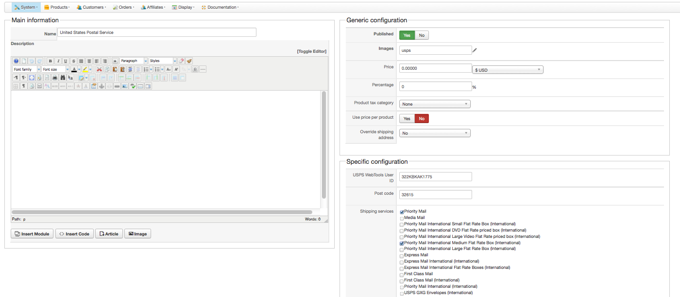

1. yes, I have shipping set up. As I stated, during my testing everything was working fine. I added 3 new products (by copying the 1st one) and then switched the paypal to the live paypal and that's when I got "no shipping method found" My USPS shipping is configured and published.

1. I made some tests and I didn't have the "No shipping method found".
Please provide some information to reproduce the problem and some details about your shipping methods.
2. I saw the footer in all pages, even in the last step where there is the redirection to paypal.
The paypal end page contains a script to redirect the user to paypal, it can cause the end of the loading and the page and some browser won't display the rest of the page because they stop the loading and start the redirection.

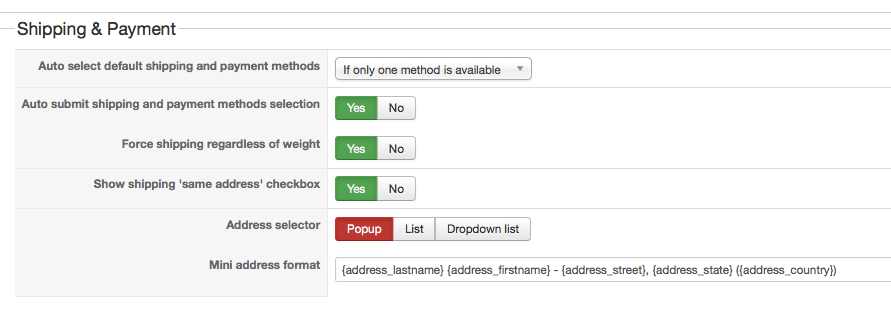

I worked on my cart last week. Everything was running perfectly. Today I added handling to the shipping and then tested an order and go the following error:
I am attaching a screenshot of the checkout flow.
