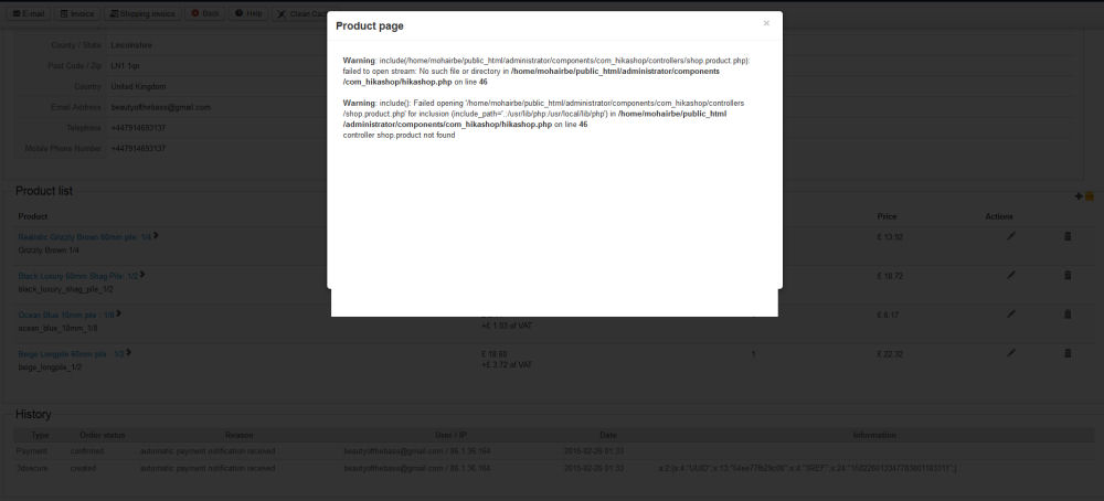

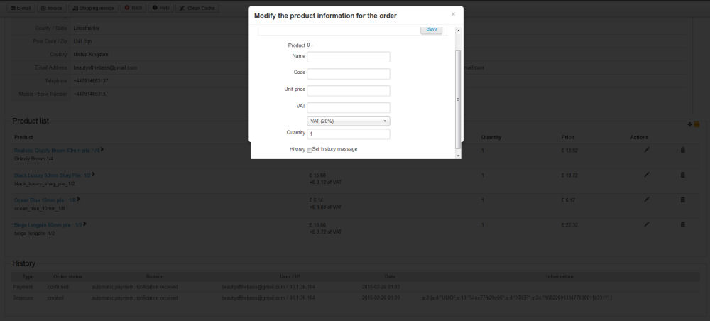

Also, i was testing your demo Hikashop. On demo site, i can easily change order status and let customer know by email.
In my hikashop its different. When i choose change order, pop up will appear and i can see my website in pop up window. Not order status option:
ctrlv.cz/shots/2015/02/25/h313.png
and popup:
ctrlv.cz/shots/2015/02/25/UASv.png
I cant change order status.
Please help me. Thank you very much.

Hi LudwigVan
I have the same problem.
You can change status vía edit order in the back-end, but the process via select "drop down" not work find, When I select drop-down status in the back-end, It open a popup window width the website the front-end and the process send email to customer not work
It occur from last update J! 3.4 today.
Best regards
Javier

11 years 6 months ago #192148
For the documentation, once you are in the order listings or order show page, you can click on the "help" button in the toolbar to see the associated documentation.
About the popup issue, it's related to some modification made in Joomla 3.4.0
For the fix, please see the thread:
www.hikashop.com/forum/5-support-en-fran...ristique.html#192105
Where Nicolas is providing the new version of the popup helper.
