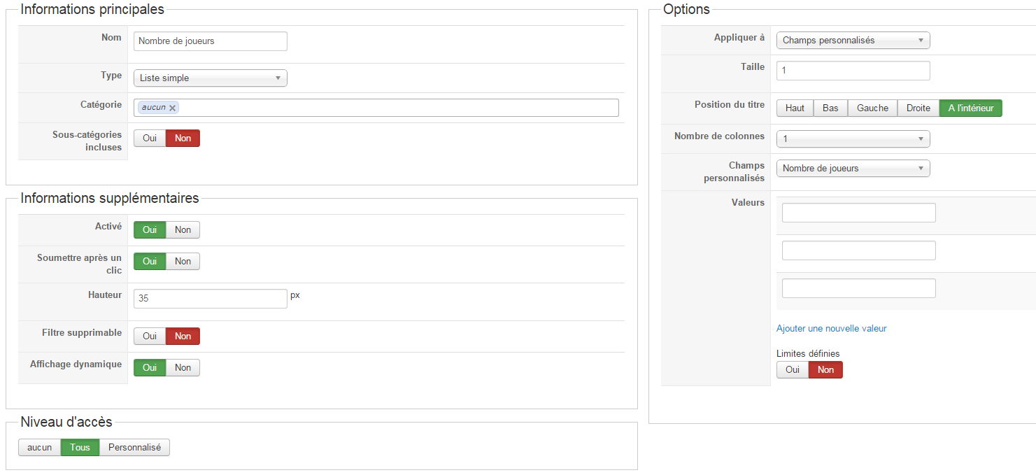

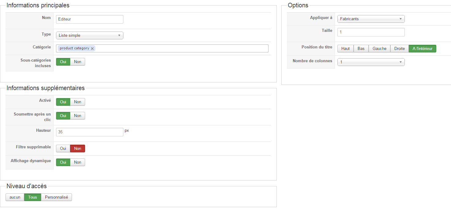

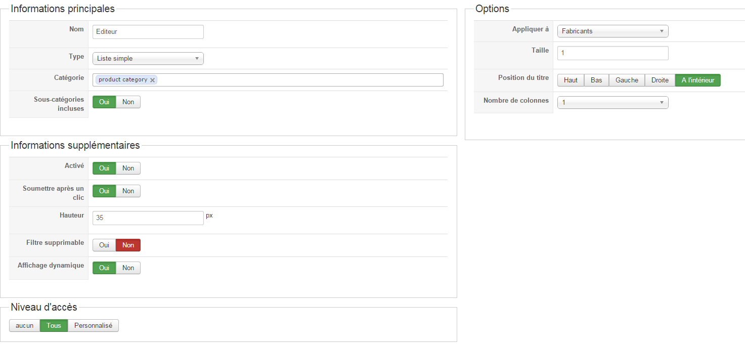

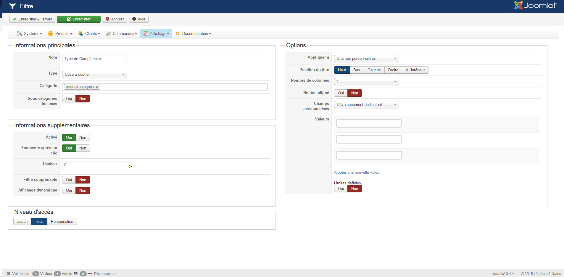

I created a system of filters with hikashop business on different types of data (categories, custom fields, manufacturer). When I enable all the filters but the one on the manufacturers everything is fine, but as soon as I activate the filter on the manufacturers all the other filter are not functioning anymore.
You can access the frontend using the test account: demo test
Attached are two screenshots of the backend for two filters, the one on manufacturers and another on a custom field.
Thanks in advanced,
Romain

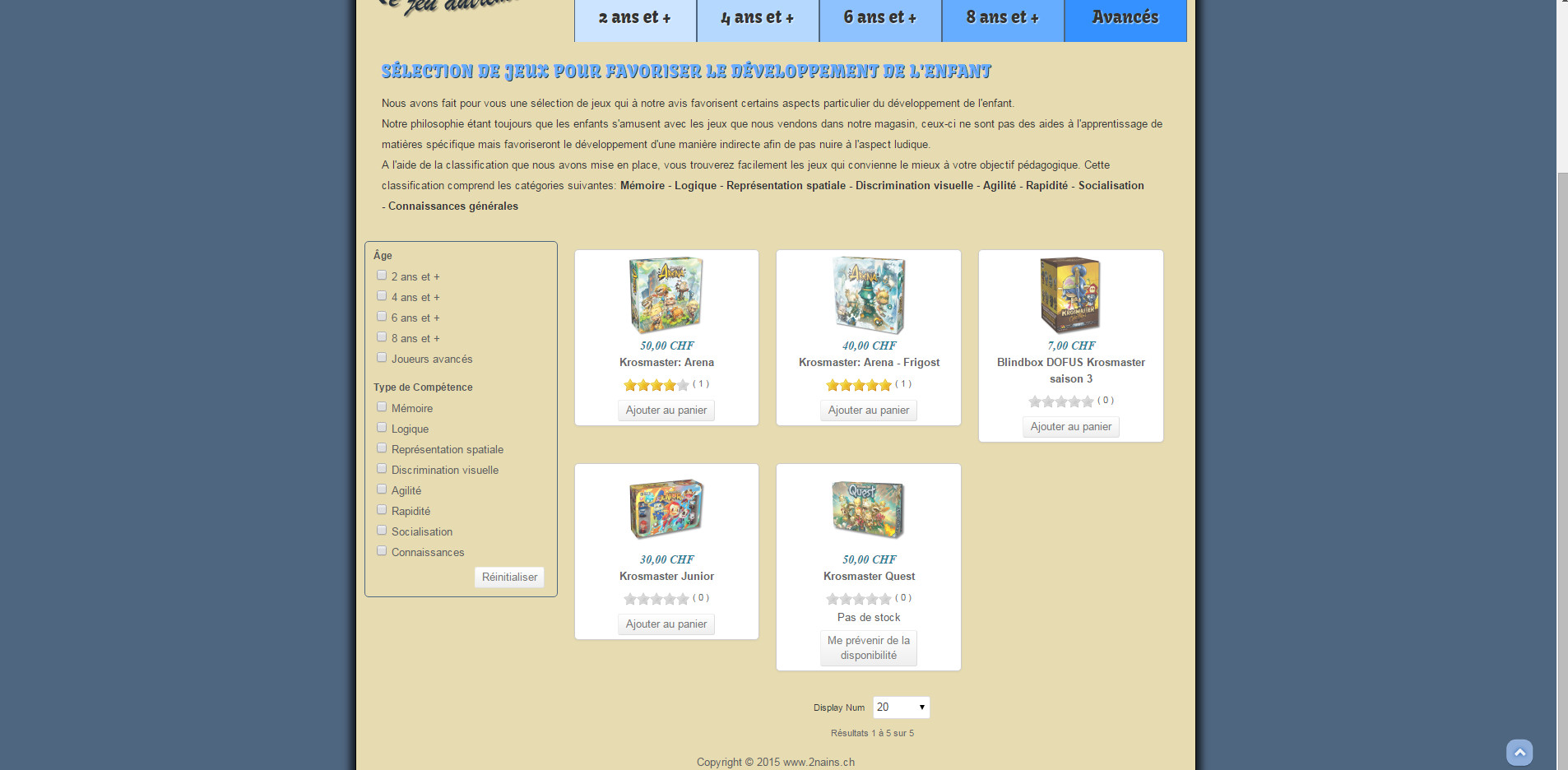

I updated hikashop and turned on the redirect post mode... Nothing has changed and the values passed seem to be ok.
If you want to compare with another page where filters are ok, then click on the top menu "8+ years".
Thanks in advance,
Romain

We made a patch for the filters and the manufacturer and regarding your issue description, I think that you got the same problem.
You can find the patch on that thread : www.hikashop.com/forum/5-support-en-fran...e-encore.html#209098
In the file "administrator/components/com_hikashop/classes/filters.php" you have to replace
$on.=' INNER JOIN  '.hikashop_table('category').' AS '.$filter->filter_namekey.$i.' ON '.$filter->filter_namekey.$i.'.category_id=b.product_manufacturer_id AND b.product_manufacturer_id IN ('.$manufacturerList.') ';
By
if($manufacturerList != '0')
The fix will be include in the next HikaShop release (2.5.1 logically).

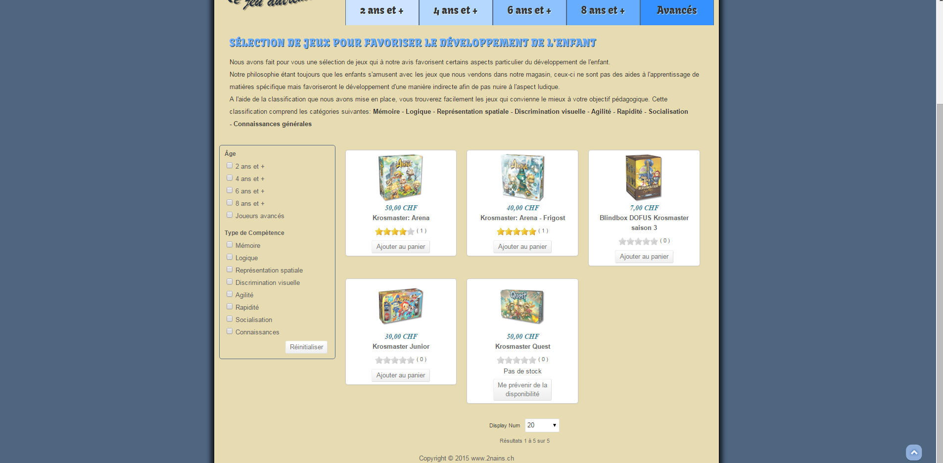

Nevertheless, I found another problem: with my check-box filter "Age", it is not possible to select multiple values. If I try to do so it resets the filter.
Romain

The filter now works but there is still a problem with the display: when a second value is checked then the corresponding checkboxes are not checked anymore. To correct that, you should replace the following line (1602?):
if(!empty($selected) && is_array($selected) && in_array($cat->category_id, $selected)){
by:
if(!empty($selected) && is_array($selected) && (in_array($cat->category_id, $selected) || strpos($selected[0], $cat->category_id)!==False)){
This patch works if you have only one checkbox filter (in the selected[0]). If you want to adapt it to multiple checkbox filters, you should add a loop and test for each checkbox filter.

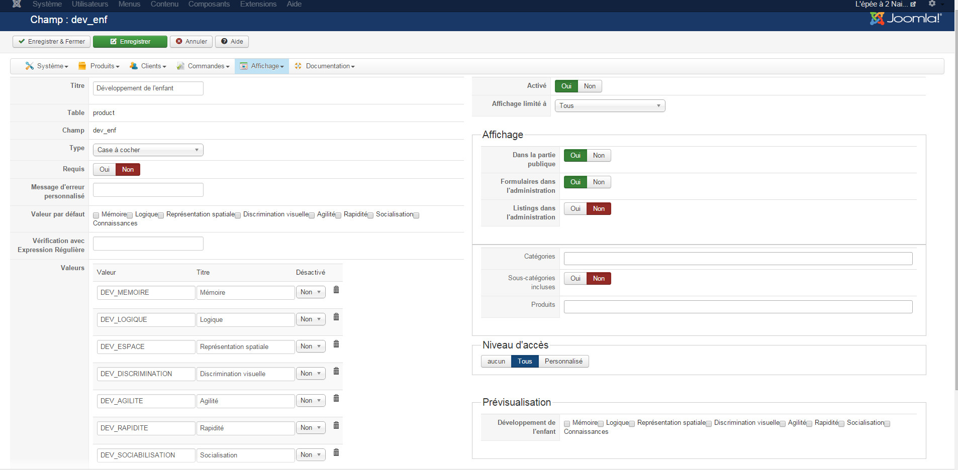

Here is the line to be modified for filter checkboxes on custom fields. Replace the line (1683?):
if(!empty($selected) && is_array($selected) && in_array($val[0], $selected)){
by:
if(!empty($selected) && is_array($selected) && (in_array($val[0], $selected) || strpos($selected[0], $val[0])!==False)){
Again for multiple checkboxes on filters, a loop will be required.
Last edit: 10 years 11 months ago by sauvain.

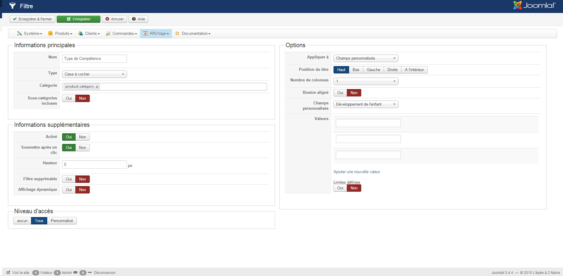

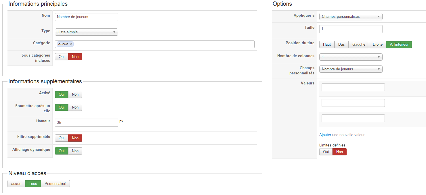

10 years 11 months ago #214550
Here are the settings I use.
