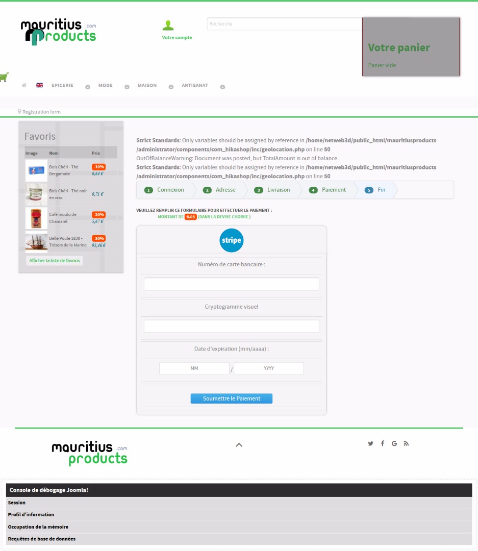

I activated all the debug modes.
When I arrive on Stripe payment I have a popup message about Script : www.netweb3d.com/mauri…roducts/media/jui/js/jquery.js:208
And some warning messages (see attached file).
When I click on Submit, I get the same page almost empty, with some codes leaving.
I give you a testing user and password : "This email address is being protected from spambots. You need JavaScript enabled to view it.", "password".
Best regards.

9 years 8 months ago #258642
The OutOfBalanceWarning message comes from the Avalara plugin.
So you need to check with them but I don't think it's related to your issue.
The Strict Standard messages are not errors and are not linked to that issue.
The jQuery error seems to indicate a jQuery conflict. Installing and configuring the plugin jQuery Easy often helps in these cases.
But it's not sure that it will help.
What about the blank page ? Do you get anything on the blank page ?

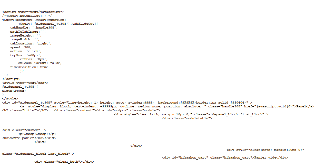

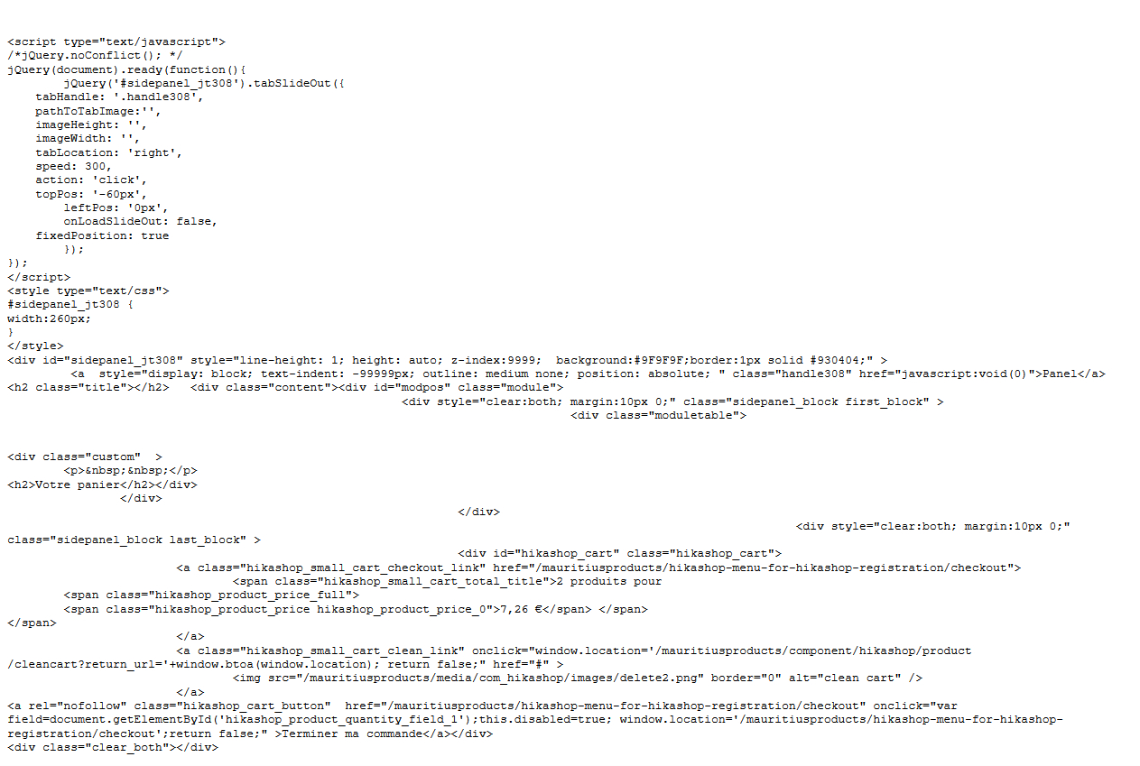

  • Posts: 96
9 years 8 months ago #258696
I have nothing else that the page
www.netweb3d.com/mauritiusproducts/index...omponent&orderid=113
that shows code of module Sidepanel (see attached file).
I have nothing in the PHP error log.
It's very strange.
You said it's related with notification. What can I do about that.
Thank's
