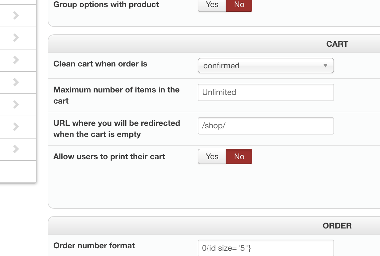

I can't seem to find the setting for what to do after an item is added to the cart. I keep seeing where it's supposed to be in Configuration->Main->Cart, but as you can see from the attached screenshot, it isn't there.

Allow me to answer my own question: That is a legacy setting as of Hikashop 3.0, so the only way to see that is to use legacy mode. Since I am totally revamping my site, I have decided to go wild and not use legacy anything.

As you wrote, these settings are now "deprecated" and are in the section "deprecated".
www.hikashop.com/support/documentation/5...html#advanced_legacy
HikaShop 3 is using the "cart notify" plugin to display the notification (tooltip, popup) and if the plugin is not activated, the user will be redirected to the checkout page.
For more details :
www.hikashop.com/blog/367-hikashop-3-0-out.html
