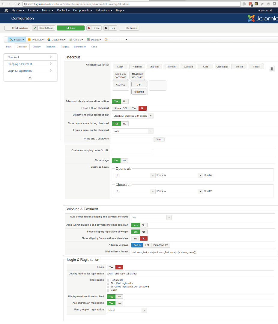

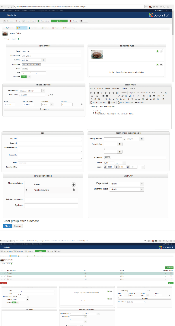

Can you provide a screenshot of your settings under the "checkout" tab of the HikaShop configuration and a screenshot of the settings of a product along with a link to the product page of that product so that we can analyze your situation ?

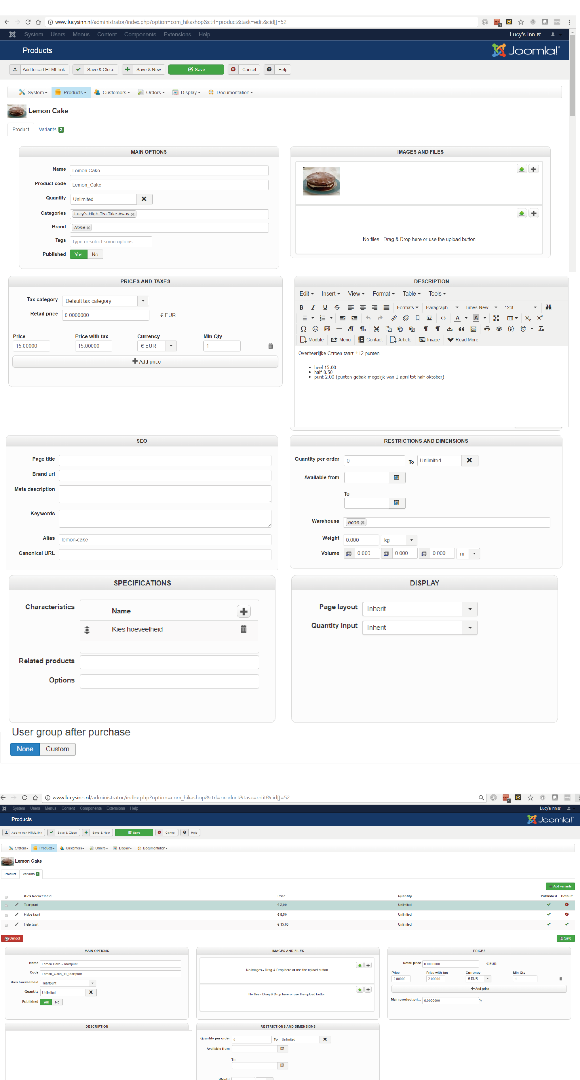

Regarding the variants problem, the issue is that you have the variants data inside of the product page form while it should normally be outside of it:
monosnap.com/file/b9JvzhNHjBetQ47auT77P9CnwYft7r
Because of that, it's always the last variant data which is taken into account when you click on the add to cart button.
This issue arises because of the way the product page layout was customized. There must be some </div> missing.
I would recommend contacting the developer who made that customization so that he can fix that for you.

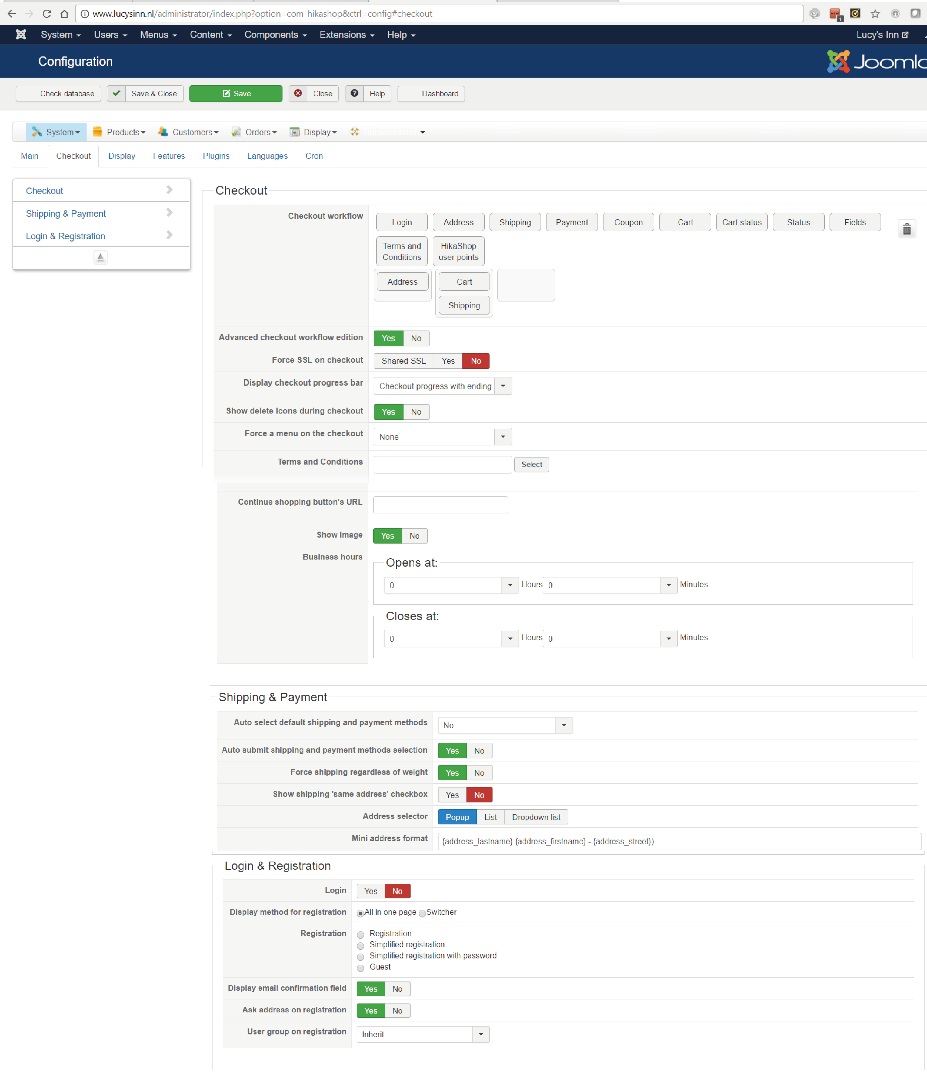

For the checkout, that's normal. Since you removed the "login" view from the checkout workflow, you'll only see the address fields once you're logged in with a user account. I would recommend adding back the "login" view.
