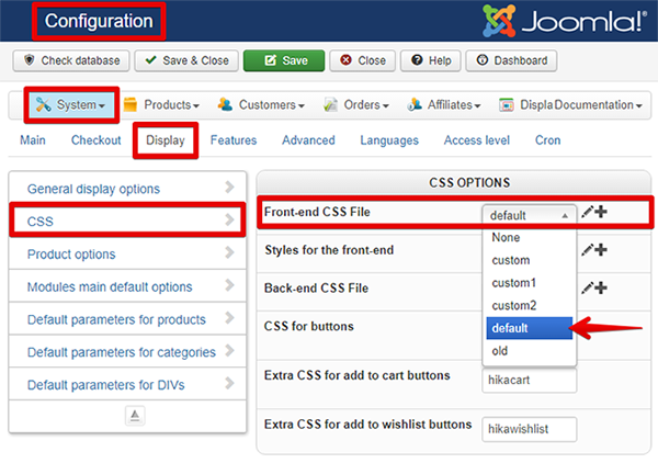

8 years 11 months ago #273225
As you can see, a maojority of topics have the same issue, and most often it's link to the fact that some use old Front-end CSS File OR have sometimes customized front-end css file.
In order to check this can you go in Components => HikaShop => Configuration, and in Display tab check this point :
And if it's not the case switch to default css file, rather than old or custom.
If that don't solve your issue, provide a link WITH the issue.
Awaiting news from you.

  • Posts: 85
8 years 11 months ago #273287
To set to default CSS is solves the problem. My main reason to not change the settings was that the upgrade does not change the settings, and I search for the problem somewhere else. And sorry, but the linked problems was the same but not was clear that I need to change the CSS file to default.
It seems now works well everything.
