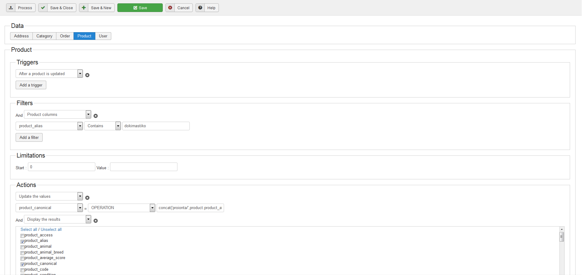

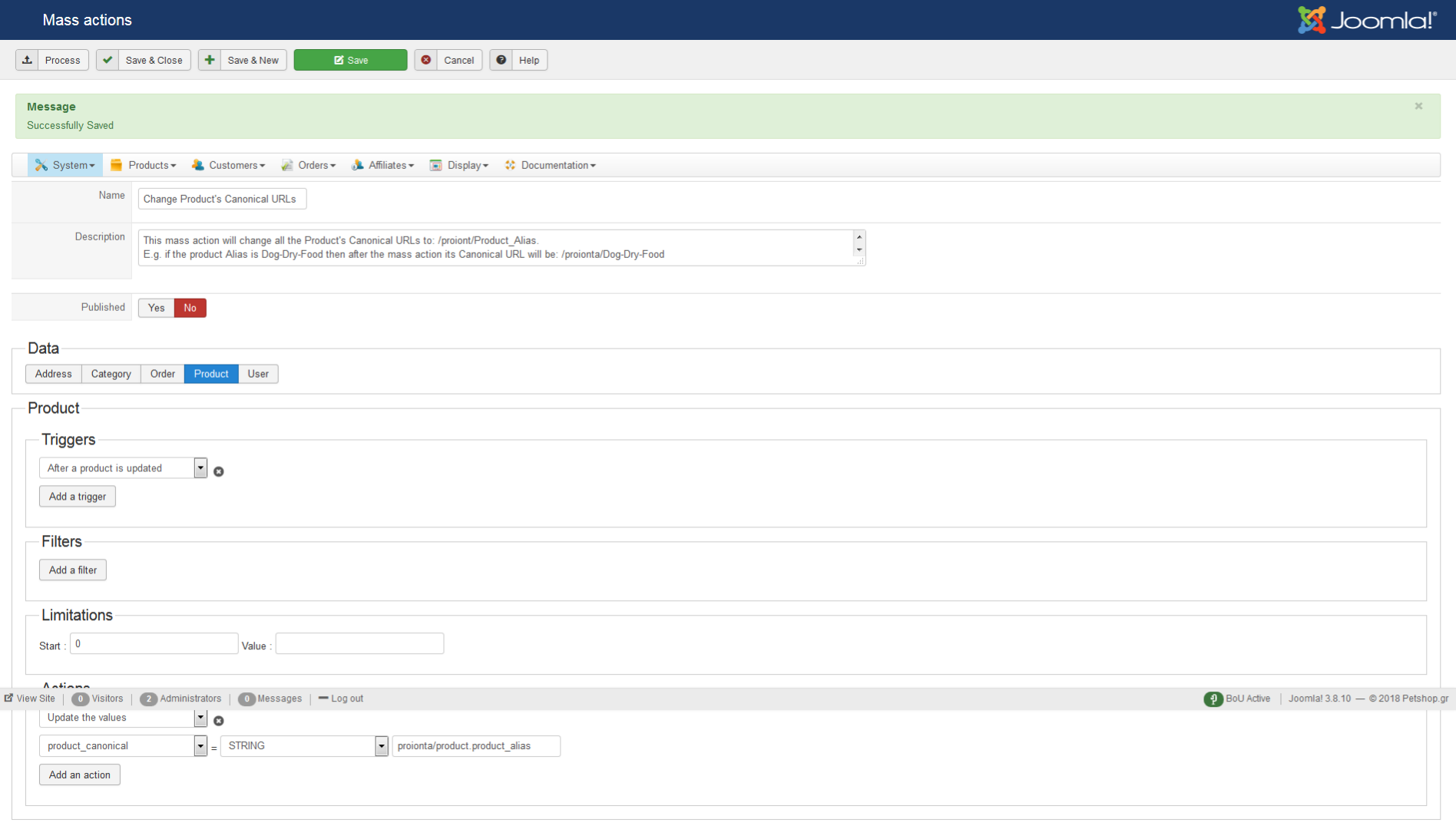

I tried to update -using mass-actions- products canonical url's value to be equal to proionta/product's alias but i get wrong Canonical URLs.
I add an action (see attachment) "Update the values", select product_canonical = STRING to proionta/product.product_alias ( also experiment with proionta/product_alias or product_alias)
E.g. I have the
Product A with
Alias: product-a
and I want to auto update Canonical URL to: proionta/product-a
but the result for all of my products is proionta/product.product_alias

The "string" type won't allow you to do any operation. So the string proionta/product.product_alias will be used "as is" as a canonical URL.
You need to change the type to "operation". Also, you need to change the text to be valid MySQL, like that:
concat('proionta/',product.product_alias)

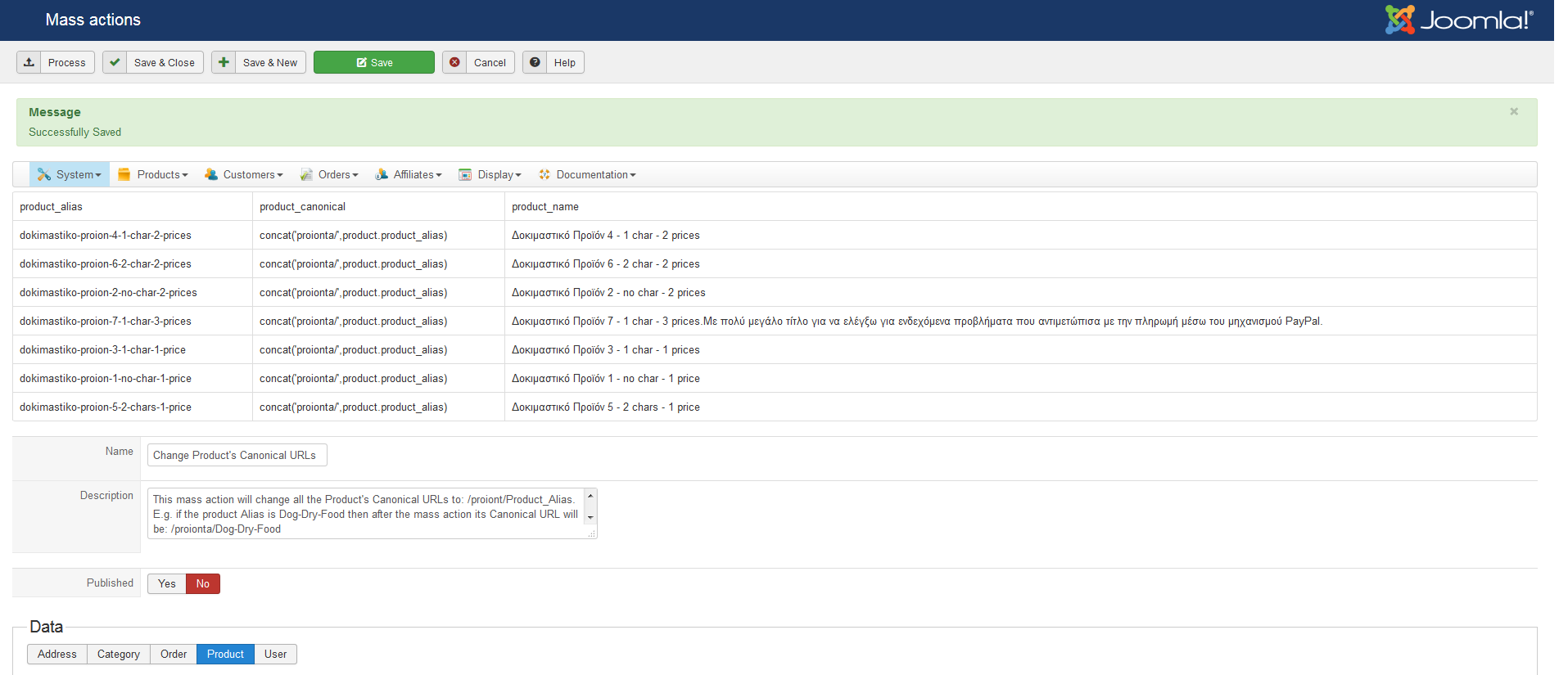

I applied your suggestions but the result is concat('proionta/',product.product_alias) for all my products.
I also experimented with just " product.product_alias " and realized that type "operation" seems to work as "string" type.
The result of my second try and for all my products is product.product_alias.
Thank you for your reply.

I did a similar test on my end and it works fine:
monosnap.com/file/V46mT80R6yMJZTbmxYUQJTpQHyLss4
monosnap.com/file/lSDSHsgKhF8aBxtgIQEu9xrrdVnElM
The alias is correctly appended to the test/ in the canonical URL field when I click on the "process" button of the mass action.
So I can only think that you didn't do your test with the "operation" type selected. Your result looks as if you were using "string" instead. Can you please double check ?
