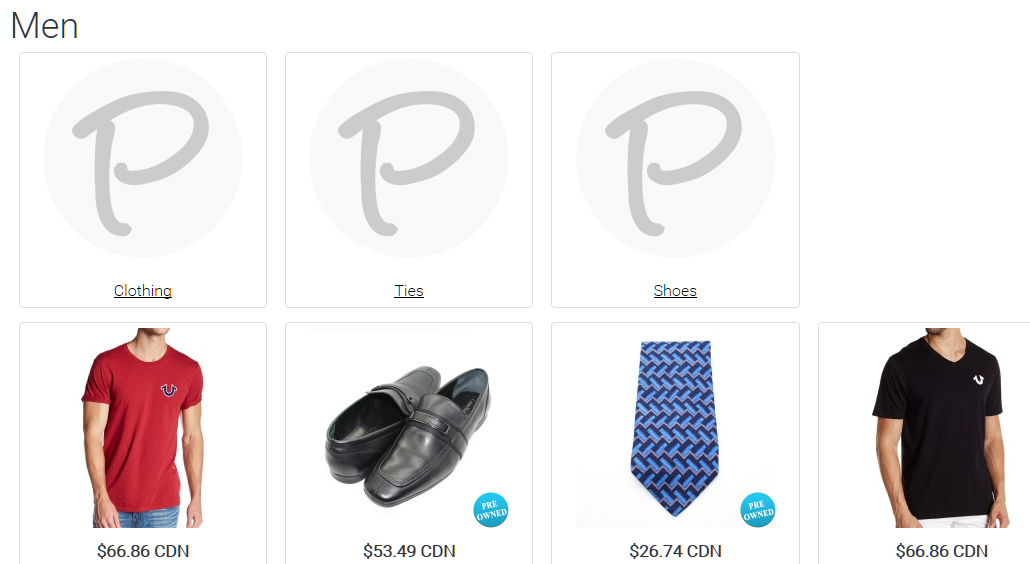

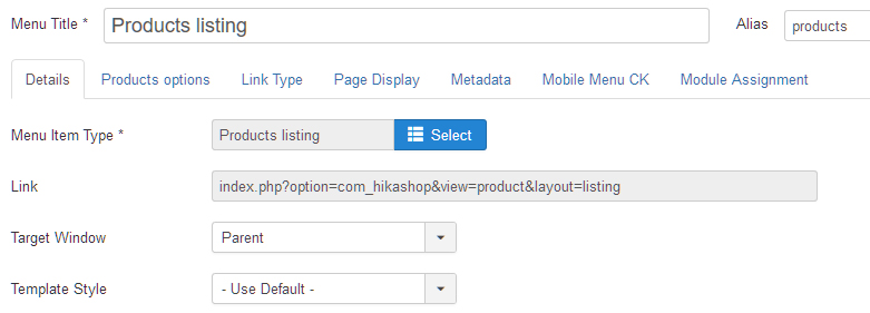

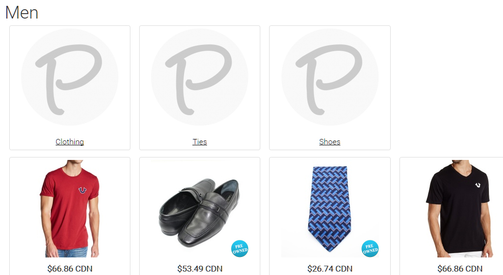

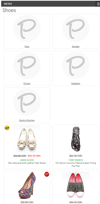

Is there a fix or a way to hide sub-categories that are showing above the products?
On desktop view when you click on the main menu, eg: Women > Clothing, it does not display anything - which is fine. But on mobile if I click on any of the menus they display all the items in that category which is also fine, however, I would like to be able to hide the sub-categories that are showing above the products.
I have this code in my CSS to hide the sub-categories, but for some reason it's not working on mobile:
#hikashop_category_information_menu_147 .hikashop_subcategories_listing, #hikashop_category_information_menu_151 .hikashop_subcategories_listing { display: none; }
It would be nice if there was a way that you can choose to hide the sub-categories via Hikashop or via the menu. Can you let me know how to get rid of the sub-categories that are showing above the products please?
Please see attached.
Thanks!

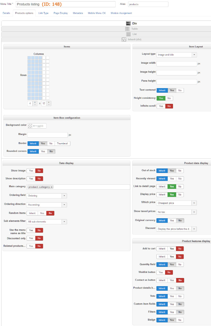

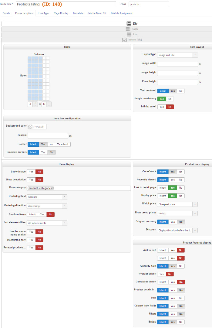

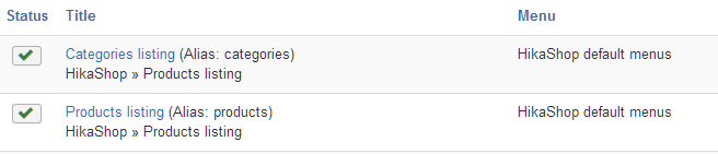

6 years 3 months ago #307718
Please see attached the set-up that I have. I think I have it correctly, but obviously not, because it's not working...
  • Posts: 84505
  • Thank you received: 13740
6 years 3 months ago #307722
Please check the settings of the menu item with the id 148. That's the one used there.
Make sure it's a products listing type menu item.

6 years 3 months ago #307758
The product listings menu in my previous post is ID 148. What am I missing please?
I've attached it again.
Thanks!

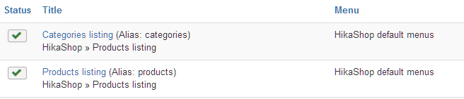

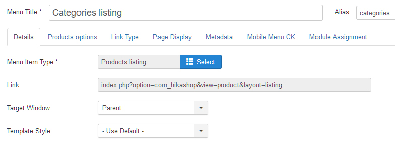

6 years 3 months ago #307962
I was able to reach your website backend, and analyze your Item Menu Configuration, and I think that there is maybe an error from the start, the concerned Item Menu is with the ID 147 and not 148.
Can you try to move settings as Nicolas told you on this message .
See my image :

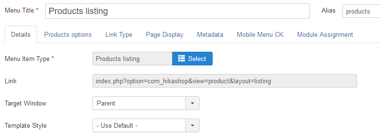

  • Posts: 966
  • Thank you received: 11

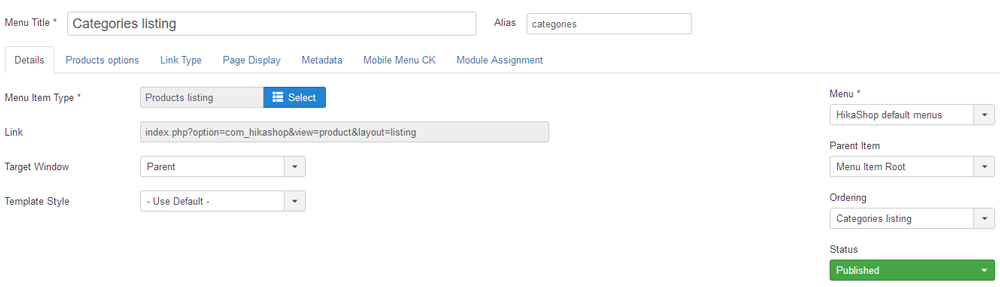

6 years 3 months ago #307988
The menu #147 is already configured to show the Menu Item Type = "Product listing". Is this not correct?
If this is not correct, please provide the steps as to what I should be doing to get this to work please - it's been over a week and I am now getting VERY confused.
Thank you!

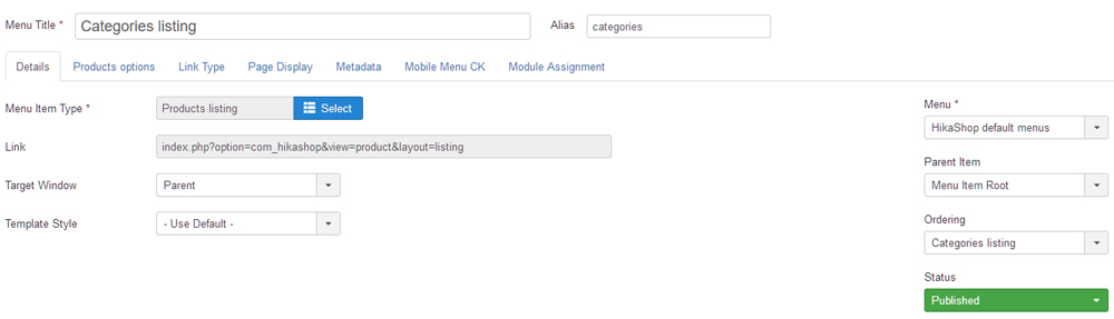

6 years 3 months ago #308056
No, I have just checked the Item Menu is configured as a Categorie Listing, as his name told it.
If you set as a Product listing you won't have categories display above your product.
Last edit: 6 years 3 months ago by Philip.
  • Posts: 966
6 years 3 months ago #308078
Are you checking the DEV/Copy of the site (https://www.*******.com/DEV/) or are you checking the LIVE site? I had given you guys the login for the live site as I thought that you would try to help me the issue.
I am doing the testing on the DEV/Copy so that I don't mess up the live site - maybe this is where the confusion is, so lets please use the DEV so there's no confusion.
The attached are the settings for Menu #147 and the page results.
Thanks!
6 years 3 months ago #308110
We works only on DEV site version, and yes, I checked your Item Menu ID 147, as you'right it's set on product listing type, and so, you haven't anymore the Category display part.
So for us, everything is as expected, now you have to reproduce this configuration on your live site.
  • Posts: 966

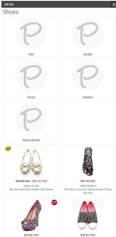

6 years 3 months ago #308127
What I'm saying is that on MOBILE devices, if you click on a category, eg: MEN, you will see the sub-categories at the top as per the picture that I attached. It looks fine on desktop, but again on mobile it DOES NOT!!
Thanks!!

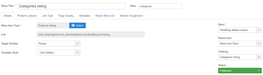

6 years 3 months ago #308131
I was able to see the issue on your DEV website and access the backend of the website, so I was finally able to understand the situation.
The situation is actually not a problem coming from HikaShop.
You're using a third party module to display that women/men selection module and this module uses the menu item with the alias "products" to generate the links to the categories and use the "ctrl" parameter as "category" while this menu item is a products listing menu item and the should should be with the "ctrl" parameter set as "product".
Because of that difference, the system treats the page as a category listing even though the type of the menu item is a products listing.
So I don't know how that module is configured but in the case of a products listing menu item, since it doesn't list the categories, you can't have products listing menu item for it. You can only have a categories listing menu item to generate the links. And in that case, you're bound to have the categories listing of the sub categories of the selected category at the top.
So if you don't want that, you'll have to either add CSS or modify the view file displaying the categories listing to not have it there.

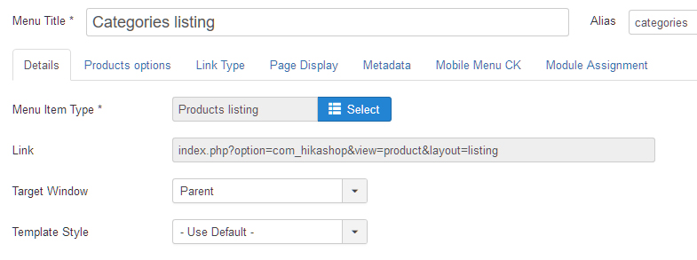

6 years 3 months ago #308231
Oh Geez Nicolas - that was clear as mud - Loooool
Anyway I get the gist of it. This is why I wished you guys created a menu soley for Hikashop then I would not have to use 3rd party stuff and this confusion would not exist as you would have identify the issue sooner.
So... I guess CSS is the easiest to do but can you also let me know how I can do it via the view file? So that I have the option.

  • Posts: 84505
6 years 3 months ago #308233
From what I see, you never display category listings on your website, so you should be able to just add the line below at the beginning of the file "listing_div" of the view "category" via the menu Display>Views:
<?php return; ?>
