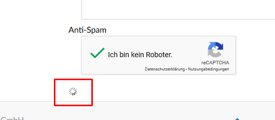

After Update to 4.1.0 the contact form "ask a question" is not working anymore.
I can fill in all fields and hit the submit button. But the form does not get submitted. Just the spinner is shown all the time.
How to solve this?

You've customized the file product / contact.php via the menu Display>Views.
Remove that customization and add your changes to the new version of the view file. It should then work properly.

Thanks a lot for pointing this out. The pre-owner did this change but he didn't tell me :(
