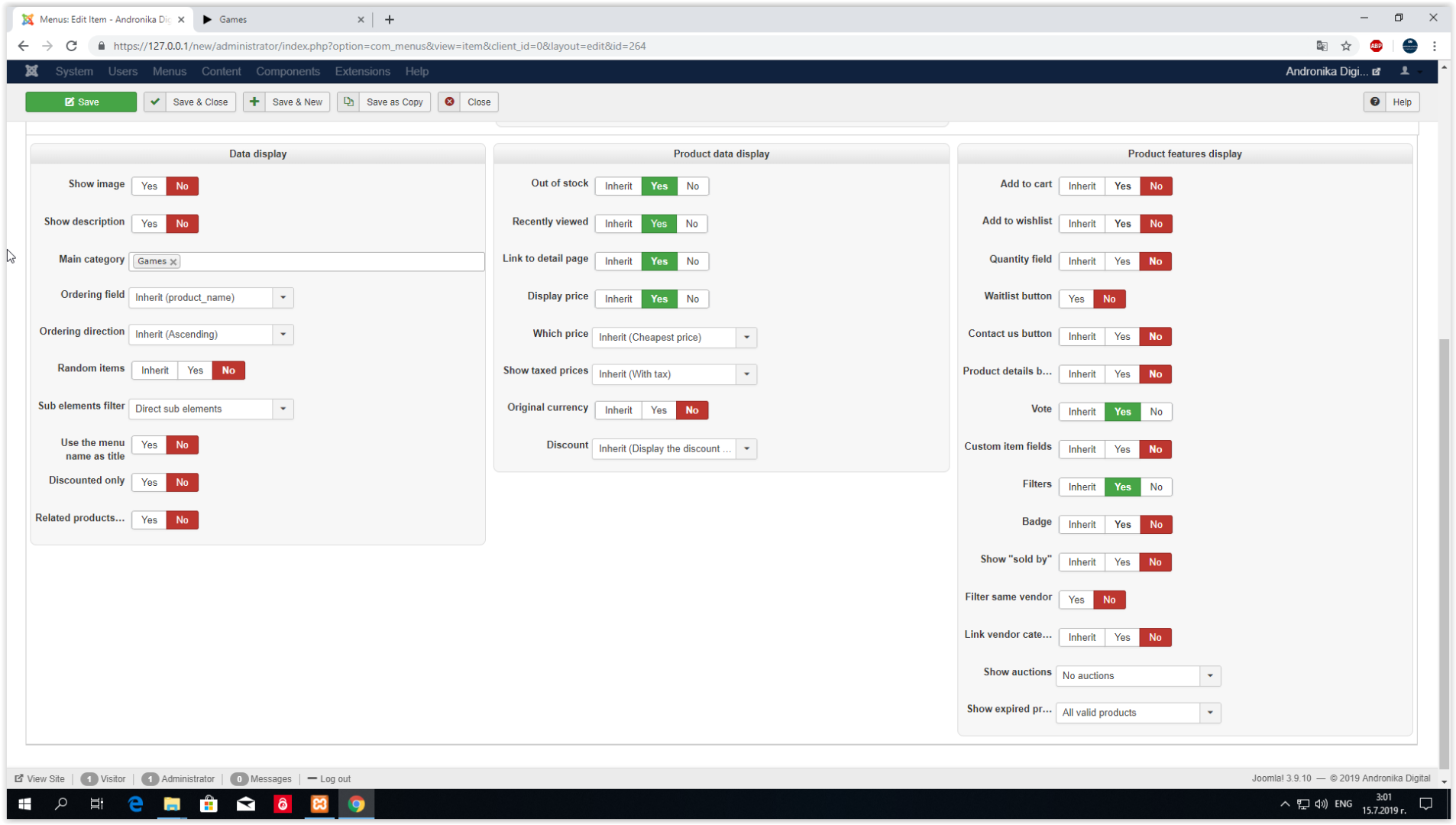

We'll need more information to be able to fix the issue.
Could you provide a screenshot of the settings of your menu item and a link to a page with the issue so that we can properly analyse the situation on your end ?

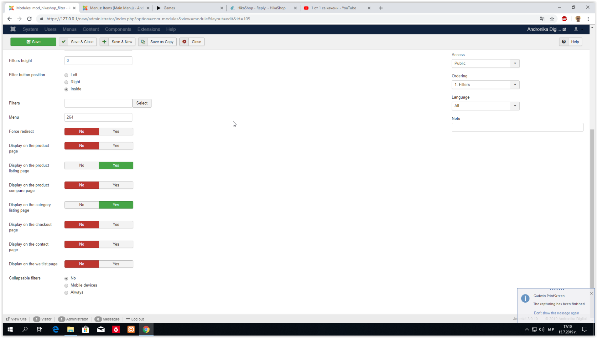

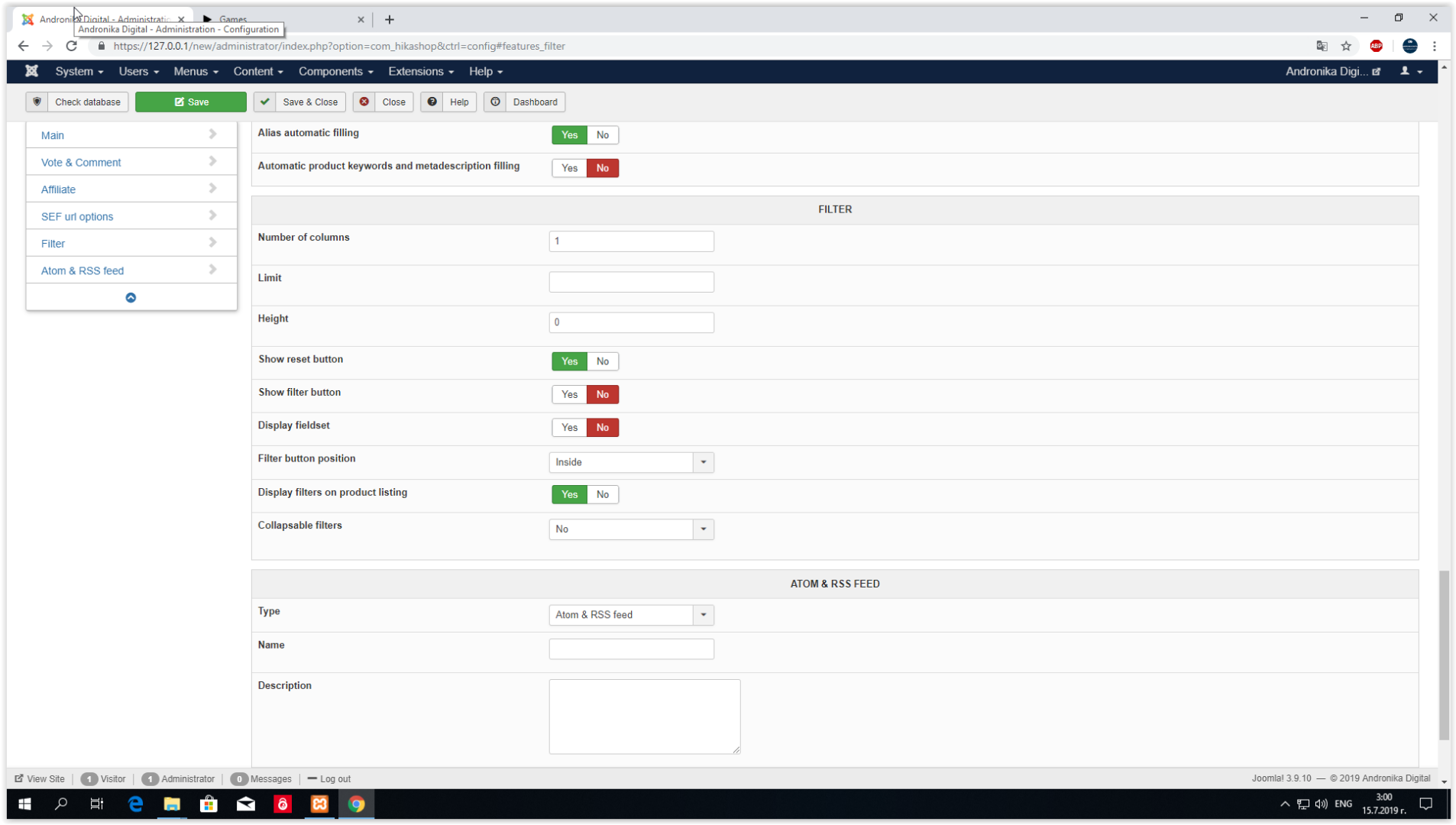

Hi I tried everything described but without result. I removed all the overrides. I tested through the menu and the module but it still does not work. You can see the entire test in the video below.
youtu.be/92bUlIYntLU

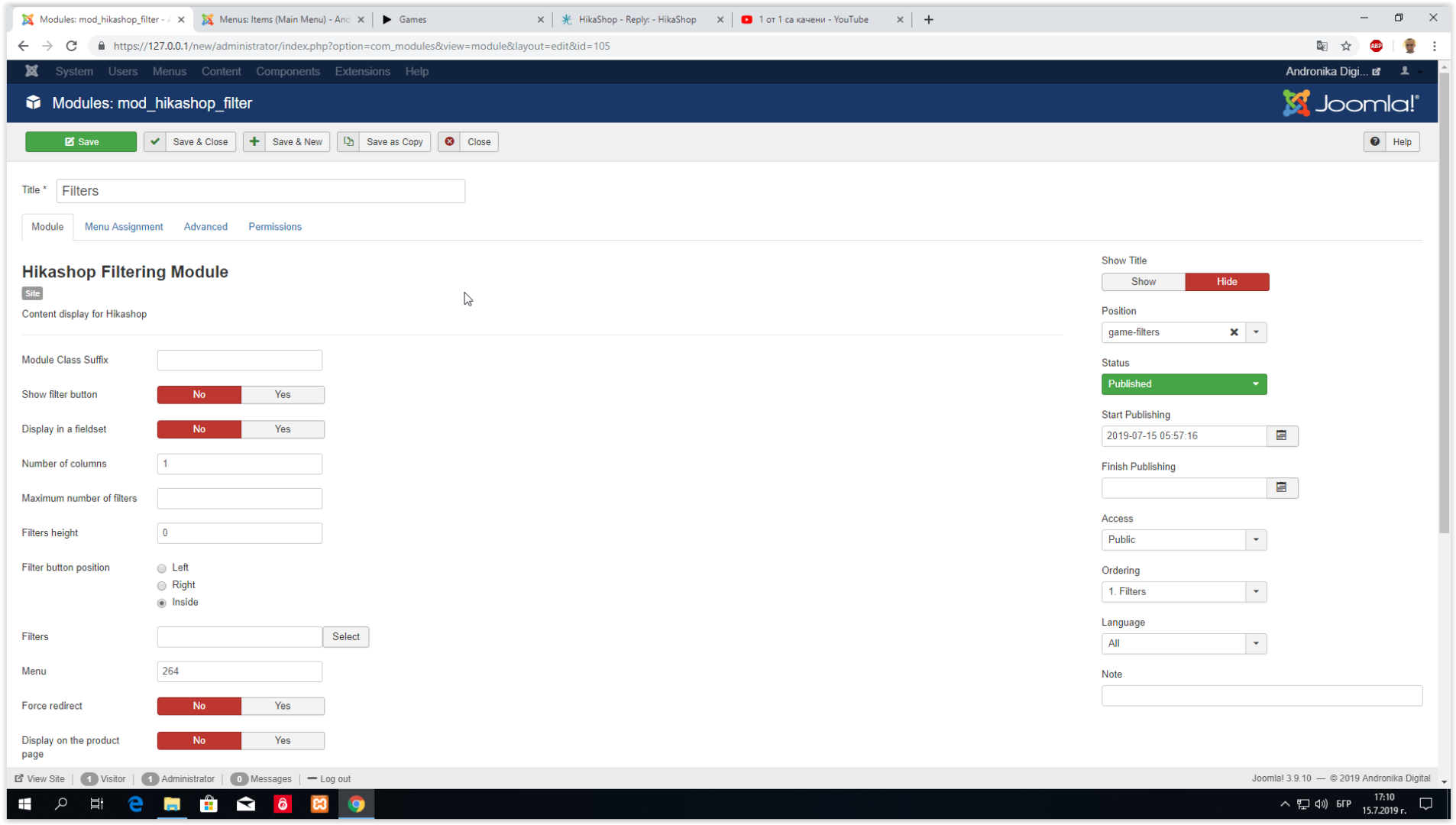

  • Posts: 431
  • Thank you received: 19
6 years 10 months ago #308863
I found the problem came from the script infinite Scroll in product/listing_div.php
I found a solution to the problem.
Problem 1: When the page is reloaded, the Reset button remains, even though no filter is selected.
Fix: After multiple tests, I activated the feature "Redirect POST mode", there is no duplication.
Problem 2: When activating the function "Force redirect" in Hikashop Filtering Module, When trying to filter, you will get this:
{"ret":1,"newURL":"https:\/\/127.0.0.1\/new\/index.php\/games?limitstart=0&filter_Sortby_1=none&filter_OperatingSystem_2=+&filter_Platform_3=+&filter_Region_4=+&filter_Content_5=+&filter_Edition_6=+&filter_Developer_7=+&filter_Publisher_8=+&filter_Genre_9=+&filter_Mode_10=+&filter_Language_11=73&filter_Year_12=+&filter_AgeRating_13=+&filter_Controller_14=+&filter_VirtualReality_15=+&tmpl=raw&filter=1","params":"limitstart=0&filter_Sortby_1=none&filter_OperatingSystem_2=+&filter_Platform_3=+&filter_Region_4=+&filter_Content_5=+&filter_Edition_6=+&filter_Developer_7=+&filter_Publisher_8=+&filter_Genre_9=+&filter_Mode_10=+&filter_Language_11=73&filter_Year_12=+&filter_AgeRating_13=+&filter_Controller_14=+&filter_VirtualReality_15=+"}
or ajax will not work.
Last edit: 6 years 10 months ago by neo191987.
  • Posts: 85727
  • Thank you received: 14055
6 years 10 months ago #308910
I tried to reproduce both problems but the reset button worked fine and even with the redirect post mode turned off and the module filtering worked fine even with the "redirect post mode" activated.
So I'm not sure why you would get that.
Are you sure you don't have view overrides ?
Or maybe you're not using the latest build ?
