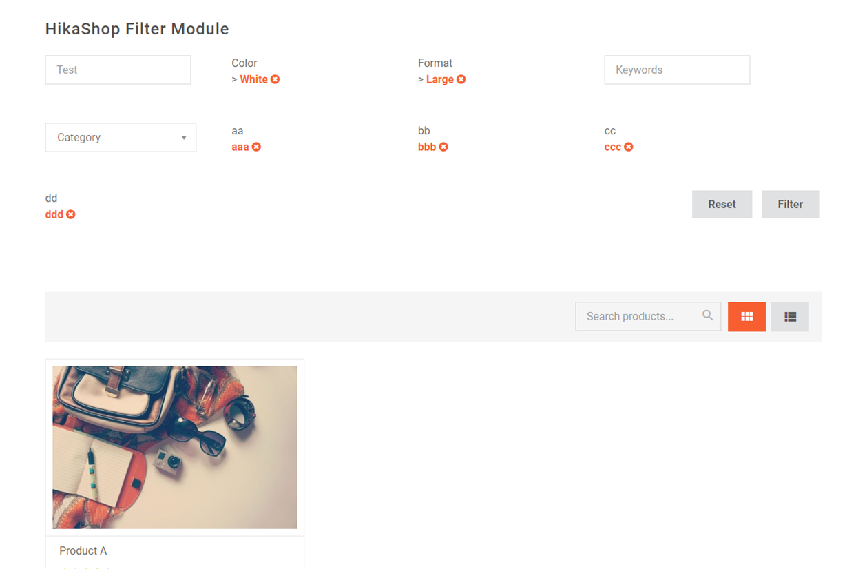

Up to 9 filters:
(a) filtering works ok
(b) dynamic filters works ok
(c) deletable filters are presented with deletion button after filter is set
(d) after Reset button is set filtering is reset and all filter fields are reset as well
please find below how it looks on images (with 9 filters in Hikashop filter module) - when is ok:

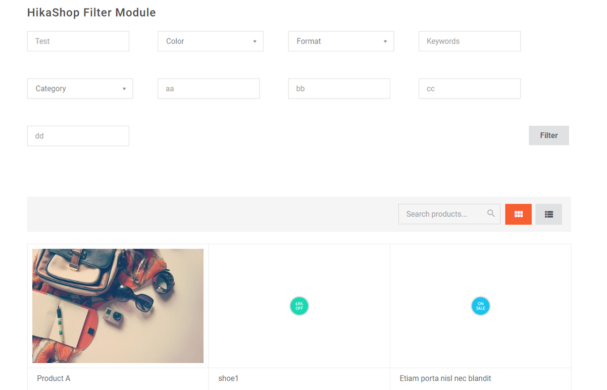

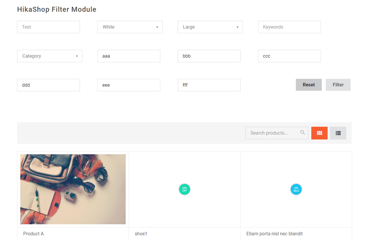

From 10 filters and more:
(b) dynamic filters are not working (you need to refresh browser using F5 to start dynamic filters working)
(c) deletable filters are not presented properly - they are without deletion button after filter is set (you need to refresh browser using F5 to see deletaion button next to the field)
(e) after Reset button is set filtering is reset but all filter fields are still look as they were set (you need to refresh browser using F5 to unset filter fields)
(f) additionally in some cases reset button not appears when filters are set until browser is refresh (F5)
please find below how it looks on images (with11 filters in Hikashop filter module) - when is not ok:

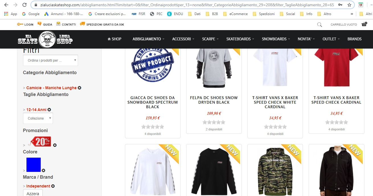

i've have the same problem with the filter after the upgrade to the last hikashop version 4.2.2.
The filter does't work.
  • Posts: 86112
  • Thank you received: 14210
6 years 9 months ago #313248
I checked your website and the issue you have doesn't look like what is described by @Greg_C here.
In your case, when a filter is used, the main area is not refreshed.
That's because some of the view files were customized based off of an old version of HikaShop and thus you didn't get all the modifications necessary for the AJAX filtering to work properly.
You need to check the folder templates/YOUR_TEMPLATE/html/com_hikashop/product/ via FTP.
There, rename the files one by one and test the filters each time in order to find the view file override which you need to recustomize.
I suppose that it's probably listing.php or listing_div.php that you'll have to redo for the filters to work properly.
