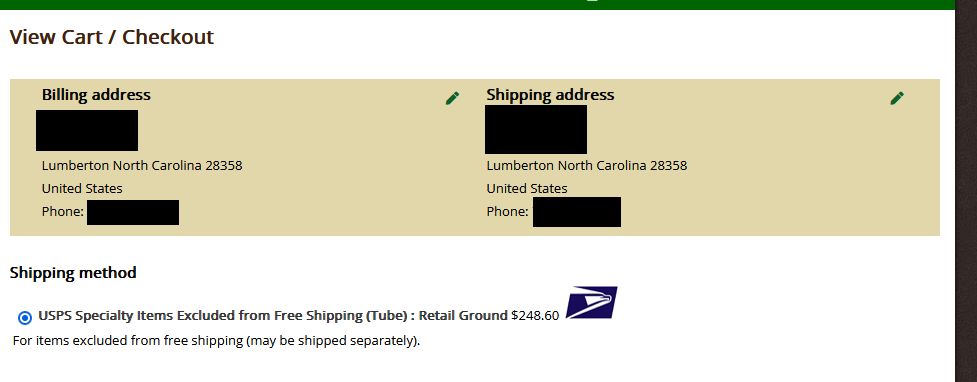

However, I re-tested. After your debug code, I got a completely different and wrong price (~$250).
I tested the other site, and it works fine (using the workaround).
I also included a screenshot of increasing the length to 57 inches on the other site.
Could something in your debug code cause making it double?

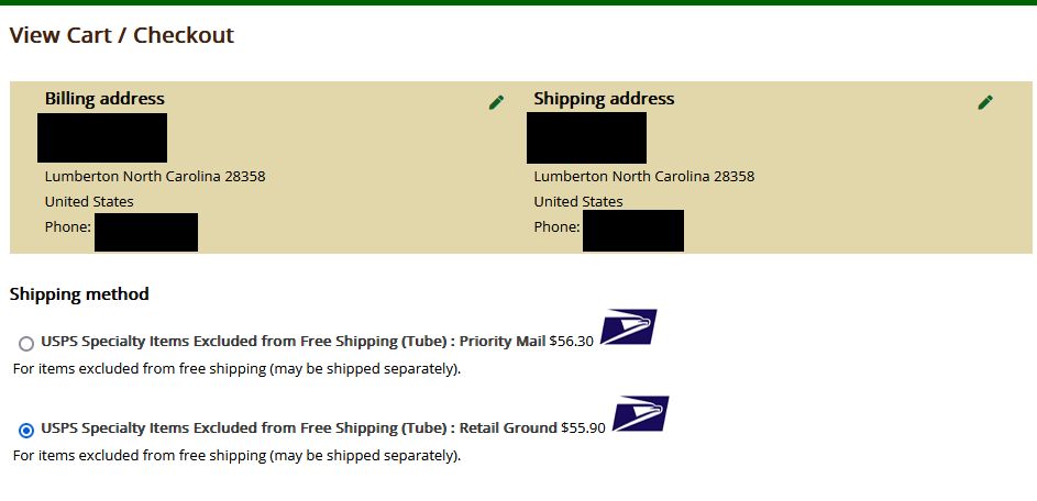

  • Posts: 291
  • Thank you received: 26
  • Hikamarket Multivendor Hikashop Business Hikashop Essential
4 years 1 month ago #341084
Also, even the workaround is now wrong on the main site.

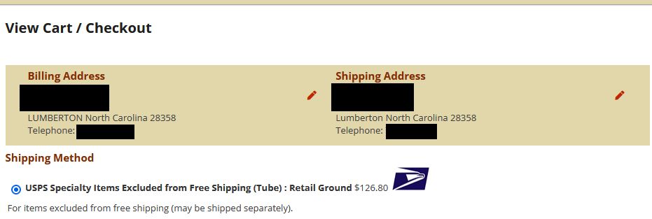

  • Posts: 85726
  • Thank you received: 14054
4 years 1 month ago #341100
I still have 128$ when I change the length to 57 inches.
I also did several tests this morning.
In all my tests, the XML sent to USPS always had the correct dimensions and weight.
So I don't see why USPS would send back a different rate than expected.
I tried to look online to see if they had some kind of debugger where I could provide the XML and it would provide results but to no avail.
So I guess the next step is to contact the support at USPS. Provide them with the XML
<?xml version="1.0"?><RateV4Request USERID="XXXXXXXX"><Revision /><Package ID="1"><Service>PRIORITY</Service><ZipOrigination>XXXX</ZipOrigination><ZipDestination>28358</ZipDestination><Pounds>3</Pounds><Ounces>0</Ounces><Container>RECTANGULAR</Container><Size>Regular</Size><Width>3</Width><Length>57</Length><Height>3</Height><Girth>69</Girth><Machinable>false</Machinable></Package></RateV4Request>
(replacing the USERID and ZipOrigination with the real values of your website and asking them why you get back a retail ground fee at 128$ while on the website you only get 25$ with the same information.

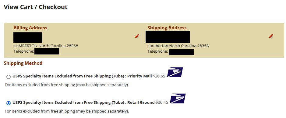

I've made a patch in the plugin and uploaded a new version of the plugin on your website.
I then run a test and I got both "Priority Mail $30.65" and "Retail Ground $30.45" which sounds much better.
If we remove the $5 surplus you had added to the shipping mehtod, we should get the exact shipping fee provided on USPS's calculator tool.
Please check on your end whether it fixes the issue and doesn't create other side effects.
  • Posts: 291
4 years 1 month ago #341106
Yes, that looks like it is working as expected.
