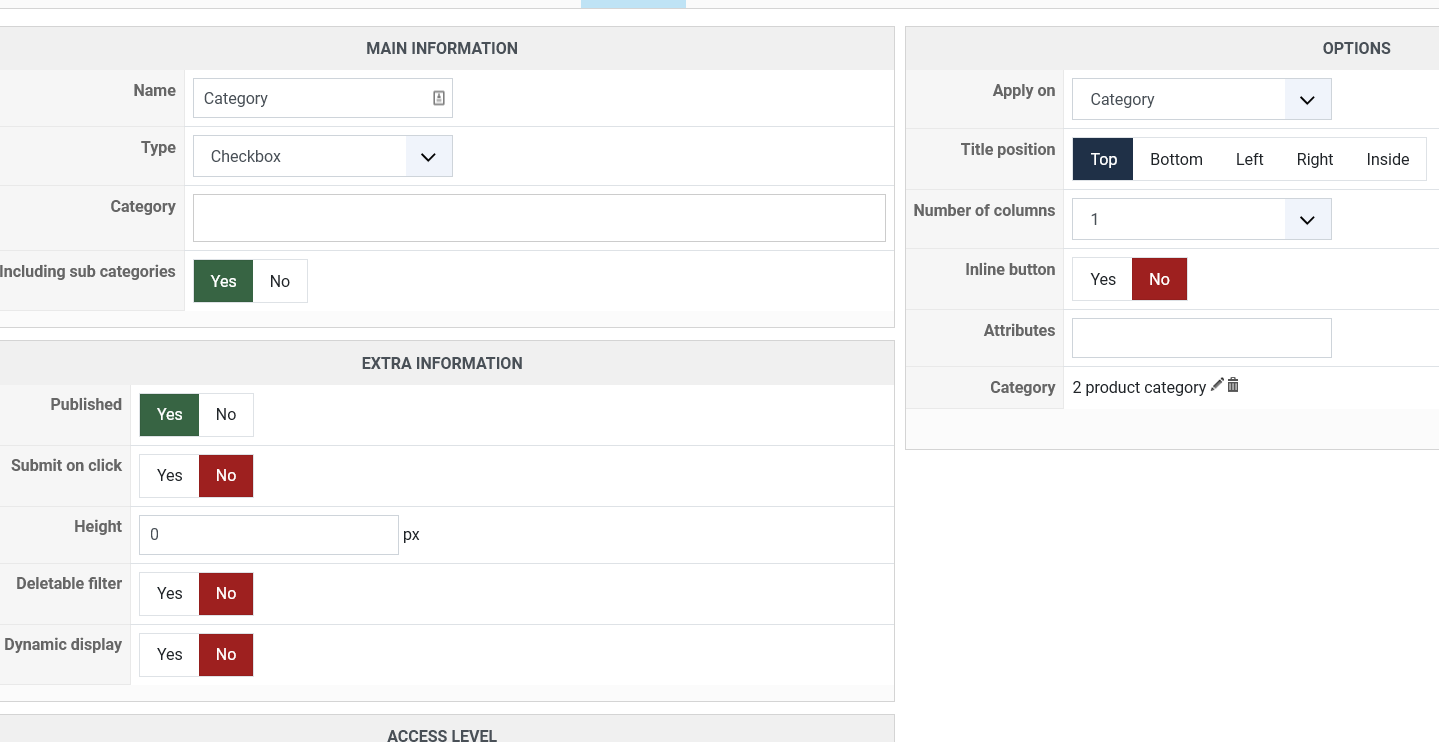

I'm not sure why it's doing that. It's as if the server doesn't see the selection of the filter.
Could you provide a screenshot of the settings of the filter ?
  • Posts: 367
  • Thank you received: 7

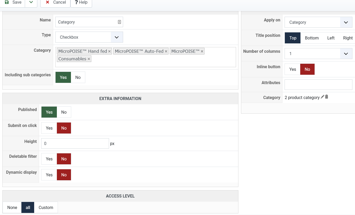

2 years 11 months ago #343116
Hi please see attached.
  • Posts: 84025
  • Thank you received: 13613
2 years 11 months ago #343119
Can you empty the first "category" setting on the top left of the screen ?

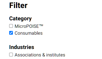

When I do that, the filter filters products from that top level category and not any sub categories. Also again, on the front end it only shows two categories.

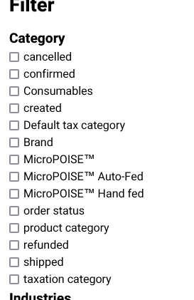

2 years 11 months ago #343150
Yes, but if I do that, I get the attached on the front end.
  • Posts: 84025
2 years 11 months ago #343165
Ok. Add the code:
		} else {
			$filters[]='a.category_type='.$database->Quote('product');
after the line:
$orderby = 'a.category_ordering ASC';
in the file administrator/components/com_hikashop/classes/filter.php
That should make it display only the product categories and not other types of categories.
  • Posts: 367

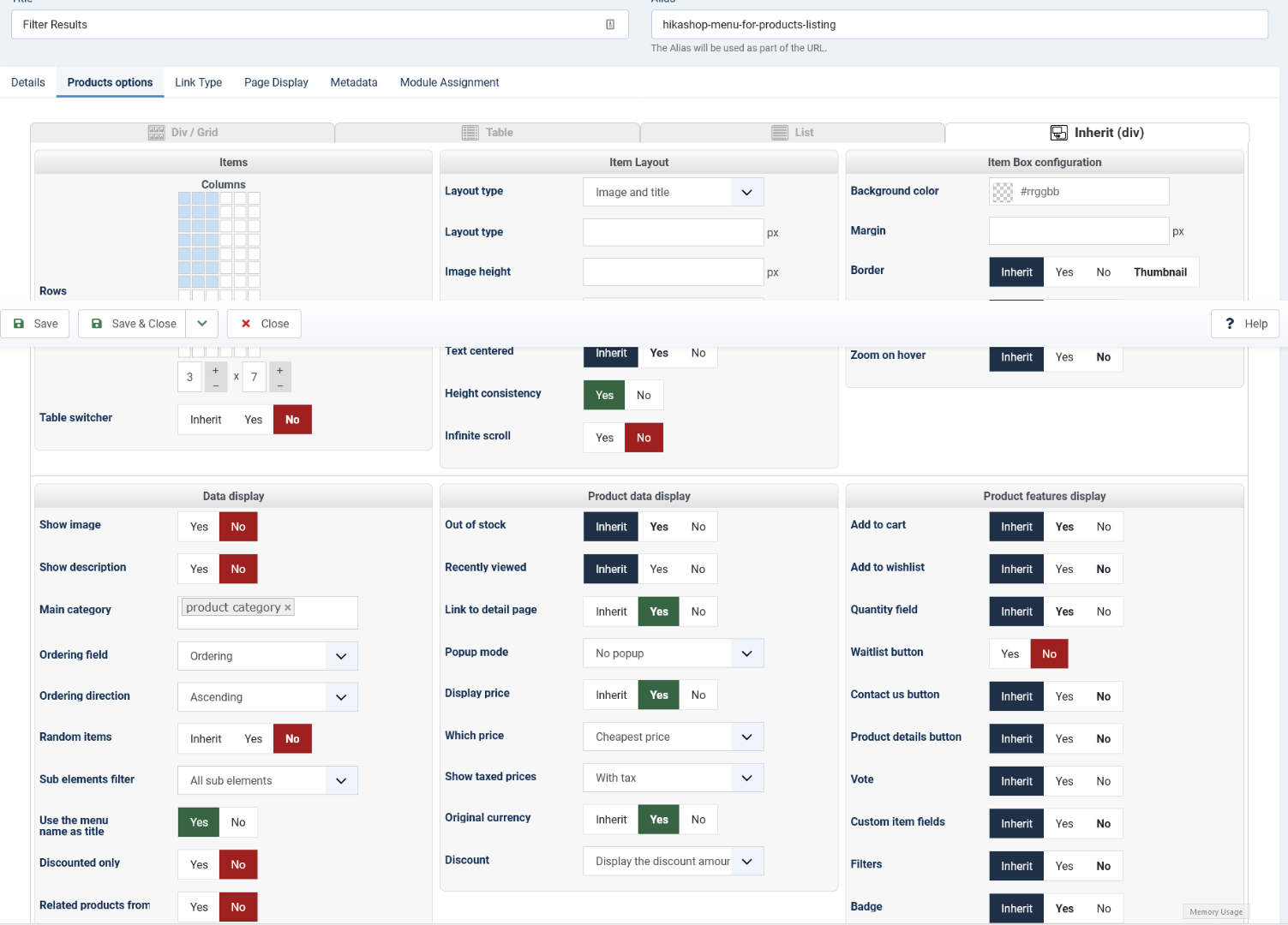

There are some more issues. See attached - "product category" still appears, is there any way to remove that? So the base level is product category then all sub categories.
Also, checking any category only shows the direct sub elements, not a All sub elements as the menu item is set to show? Is there a way to do that?
  • Posts: 84025
2 years 11 months ago #343203
Unpublish that category and it won't appear there.
There is no option to make it show sub category products. The category filter can only filter using categories directly linked to the products.
You might want to do it differently. Instead of using a category filter, you could use a HikaShop content module configured to display your categories like the "categories on 2 levels" module which is preinstalled for you by HikaShop. Normally, you just have to enable it in the position you want via the Joomla modules manager.
