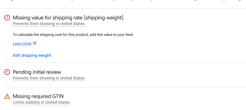

Yeah but I'm still dealing with this after almost 2 years.
We need resolution please. Then I can say we witnessed our products syncing to google and also facebook/instagram.
What about ebay, amazon?

Please stop posting for same issue on different threads.
I told you we're a small team. What this means is that I have to spend almost twice the amount of time to answer all your messages.
For your Google Products issues, we'll continue here:
www.hikashop.com/forum/import-export-csv...erchant-account.html
For Ebay and Amazon, I already replied to you about it yesterday:
www.hikashop.com/forum/integrations/8973...iexpress.html#357913
