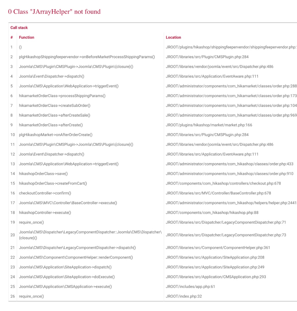

-- Error-message(debug-mod must be tuned on) -- : 0 Class "JArrayHelper" not found

Please activate the "debug" setting of the Joomla configuration and reproduce the error. You'll get the complete error message which will allow us to understand what's going on and tell you what to do.
  • Posts: 23
2 years 9 months ago #354371
Here is the full info

There is no more "JArrayHelper" in the plugin since October 2018 and the release of HikaMarket 3.0.0
All "JArrayHelper" have been replaced by internal functions from the HikaShop/HikaMarket cores.
www.hikashop.com/support/documentation/1...arket-changelog.html
But the plugin "Shipping Fee Per Vendor" is not part of HikaMarket since it's a custom plugin ; which has been updated in 2018 like the rest of the HikaMarket eco-system.
Please replace the
JArrayHelper::toInteger($shipping_ids);
By
hikamarket::toInteger($shipping_ids);
