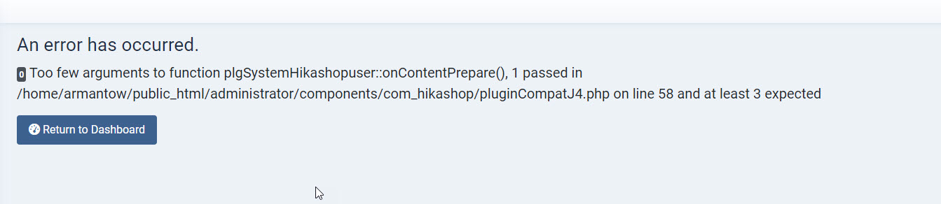

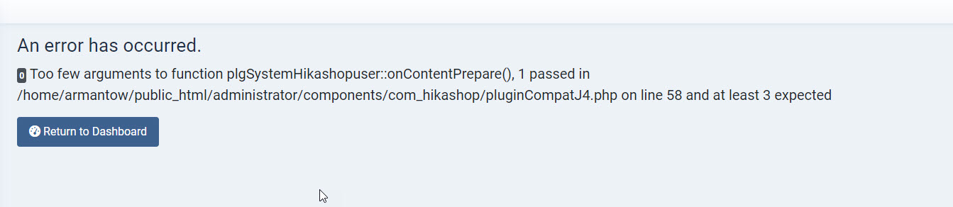

i have recently updated the hukashop and joomla to version 5.0.0
i'm getting the error i attached in my site in both frontend and backend

i cant even create a new user !!
i get the same error when i click the save button

I can't make this post private. There is no such feature on our forum. You can provide your credentials via our contact form:
Regarding the saving of the user, rename the file pointed by the error to something else via FTP.
You won't get this error anymore. You should normally get another message pointing at the file of a plugin. Rename that file too and you won't get the error anymore. You should then be able to do what you want.

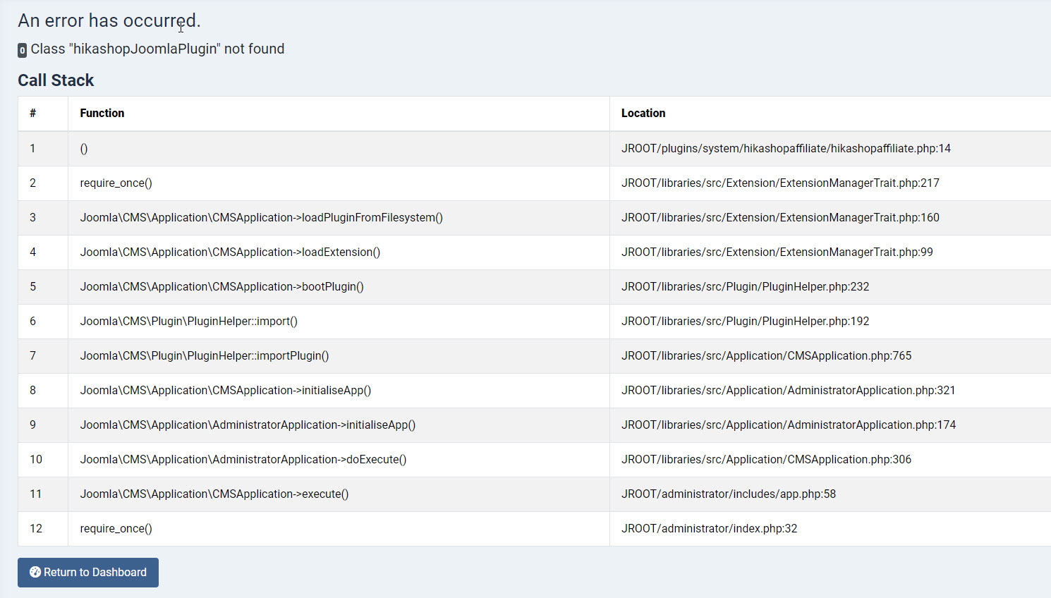

when i rename the file "pluginCompatJ4.php"
i get this error :
Class "hikashopJoomlaPlugin" not found
  • Posts: 86112
  • Thank you received: 14210
2 years 10 months ago #356177
Yes, that's normal. Activate the debug of Joomla and you'll get a full error message with the file where that class is not found, and you'll be able to rename that file via FTP too, as I was saying.

I attached the screen shot of the error when the debug mode is on
would you please tell me which file should I rename ?

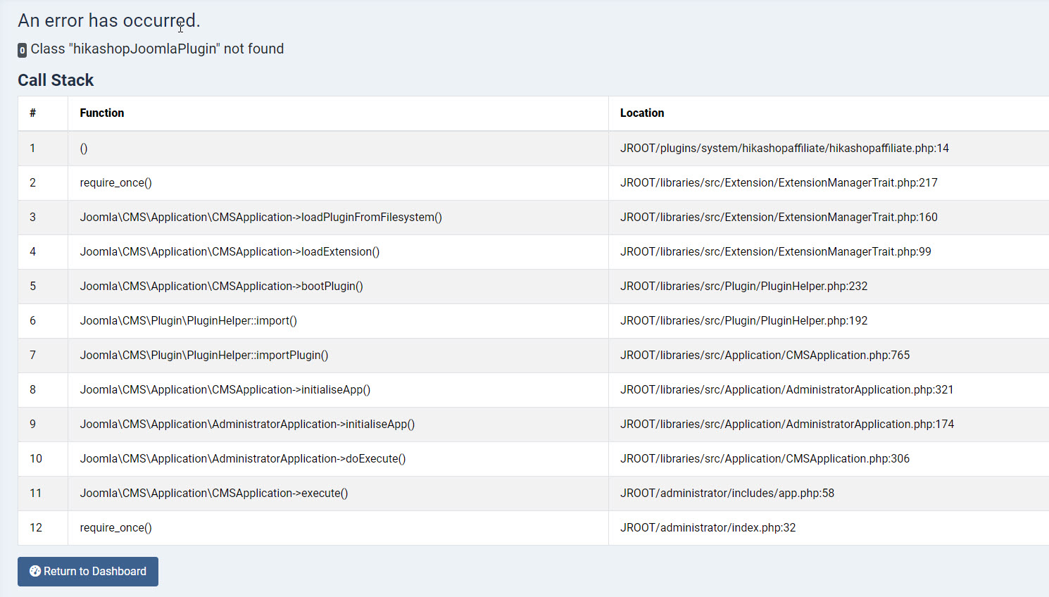

  • Posts: 240
  • Thank you received: 13
2 years 10 months ago #356207
look i renamed a bunch of files and every time system gives error pointing another file !!
