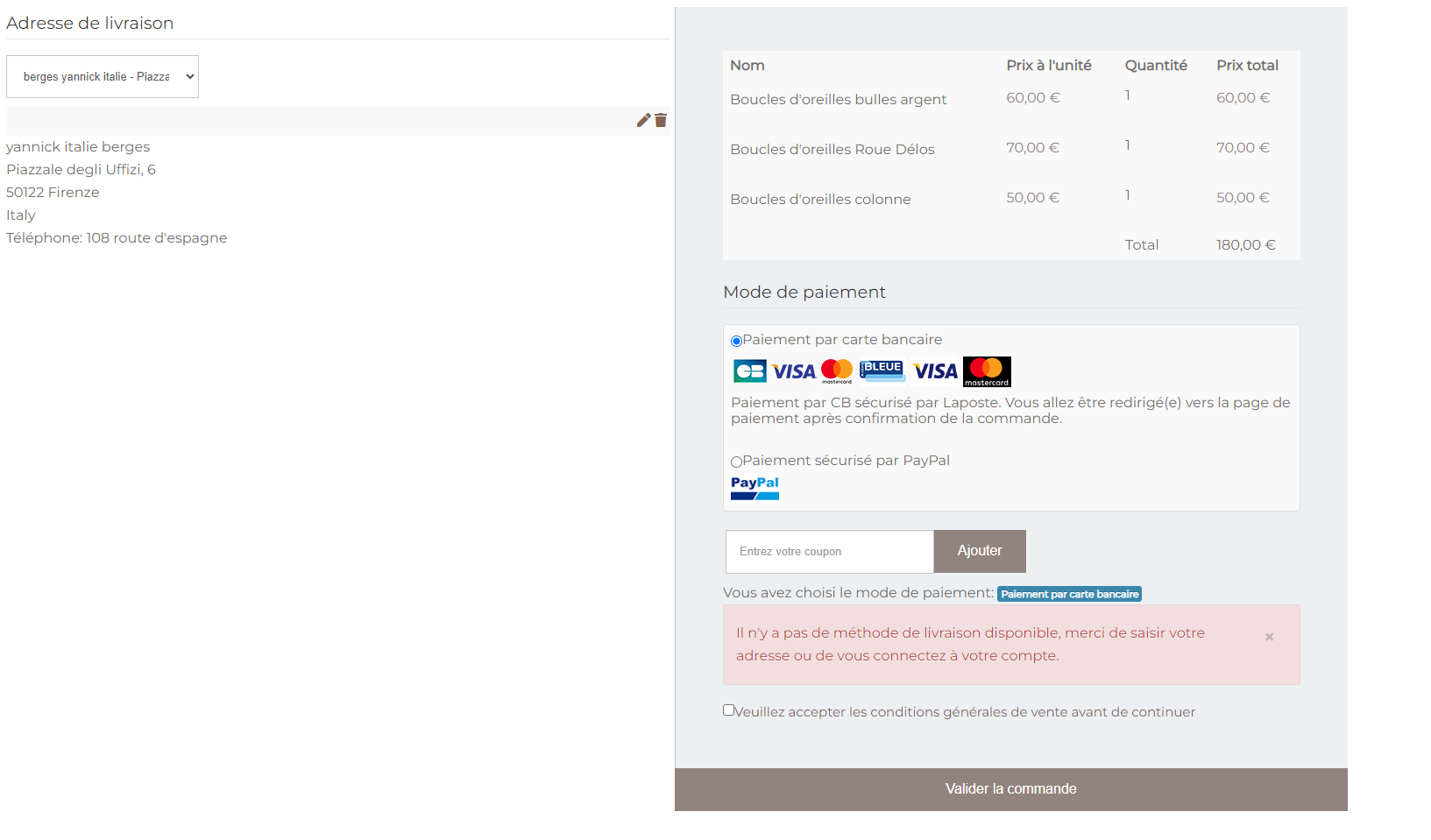

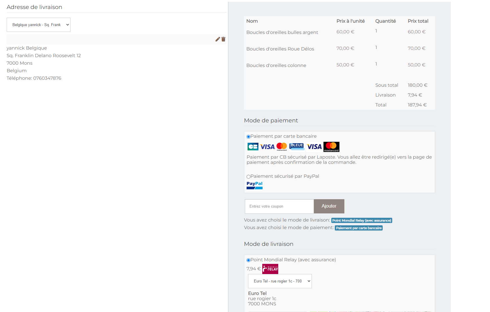

when i set a france address i see all shipping
when i set belgium address i see mondial realy shipping
when i set an italian, german, potugal addres no shipping !!!

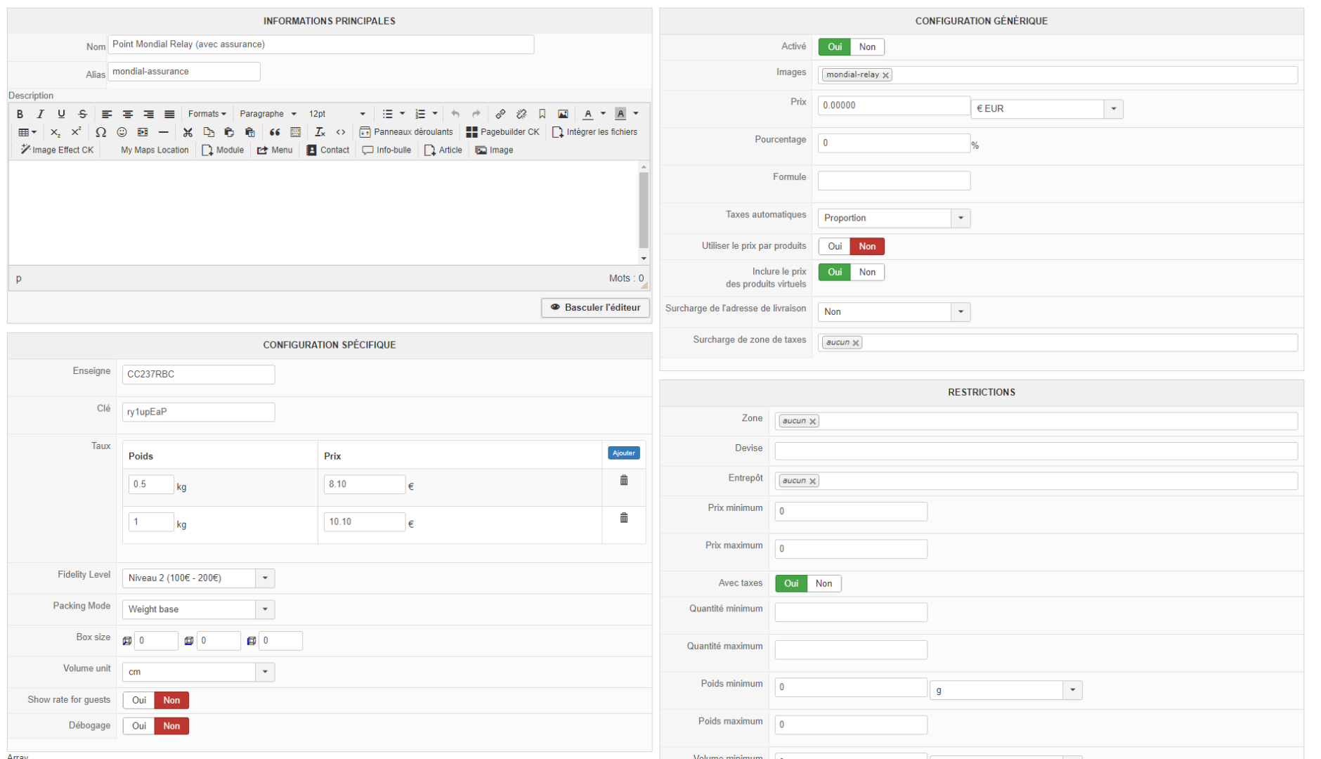

I have no other idea. Could you provide a screenshot of the settings of the shipping method ?

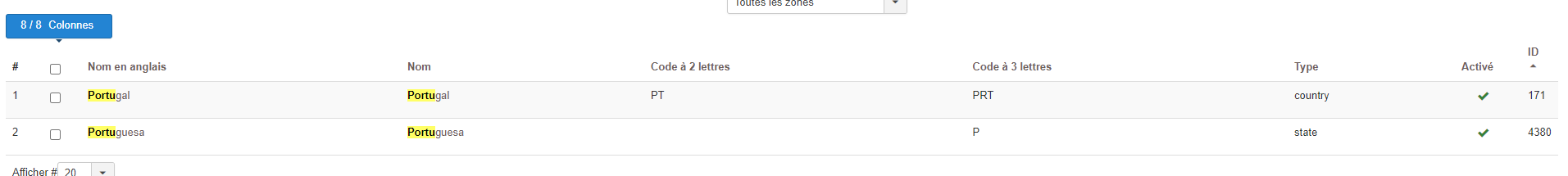

Can you confirm that you have "IT" and "PT" for the Italy and Portugal country zones in the 2 letters code field of these zones in the System>Zones menu ?

here all configurations
En mode commande
belgique
italie
  • Posts: 85952
  • Thank you received: 14143
1 year 10 months ago #363042
The settings look fine. So I don't see anything else.
