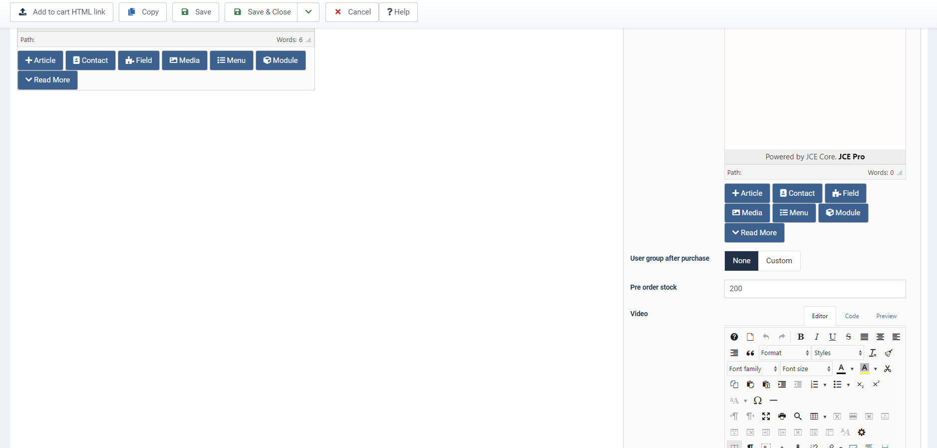

1 year 11 months ago #363828
I have finally found the field which was hidden inbetween 2 custom fields Nicolas made for me, but without seems so truly hidden unless you know what to look for.
*Nicolas can you make the custom fields so that the preorder field is seperated from (/out of between) specifications and video field?
  • Posts: 86112
  • Thank you received: 14210
1 year 11 months ago #363845
The field is not in the middle of the custom fields by default.
And the interface is customizable by drag&drop of the label of the fields:
www.hikashop.com/home/blog/481-hikashop-4-5-1.html#d&d
So I'm thinking you might have moved the fields yourself (or someone else on your end).
I would thus recommend rearranging the fields yourself with the drag & drop interface.
  • Posts: 147
  • Thank you received: 8
1 year 11 months ago #363848
Yes so although i know nothing about how to do this and did not even find it until yesterday, i moved it. Yes, lets say i did. so now i moved it again and the product page gave a 404 so now i'm putting back a backup from the server. Fun times.
