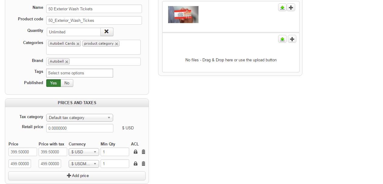

I have tired everything I can think of and read through everything in the forums and i cannot get the hikashop geolocation plugin to automatically switch prices. I have enabled the plugin and created an api key. Set currency is enabled to yes in the plugin as well.

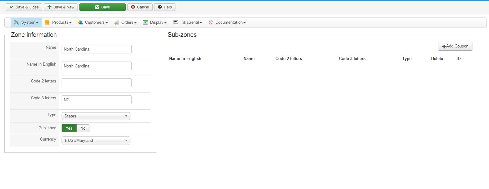

What I need to do is all states have the same pricing except 1 for this product. So I created a new currency and set the new zone to that currency. I set all the other states/zones to USD which is the default currency. However, I have tried looking through proxies, etc. and the currency never changes. I have no idea what I am doing wrong. I think there might be a bug in the geolocation plugin because the currency just will not change.
I did it on this product below and I have the north carolina zone since i live in nc to test this set to the new currency with a new price and the new price/currency does not show up. The rest of the states/zones are set to the default USD currency. However, the prices just stay set to normal USD price no matter what i change. The pricing should be showing as $499 when you coming from a NC location and it does not.

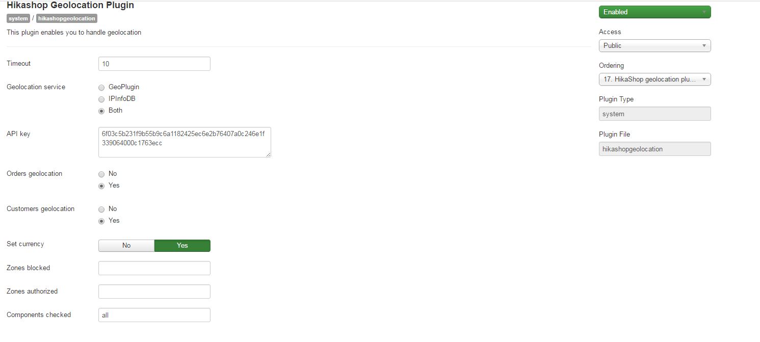

I forgot to attach my settings. Here are my settings for everything.

Yes, the geolocation system works at the country level, not at the state level. So you won't be able to switch currency for different states as the information of the state is not known with the geolocation services integrated in the geolocation plugin.
But even if that was the case, you would have another problem. Creating a second USD currency means that it has another currency code. And the currency code is sent to the payment gateways so if you have another currency code than USD but want to charge in USD, it won't work. The payment gateway will try to charge in the other currency code that you put, and if it doesn't exists, it will refuse the payment.
