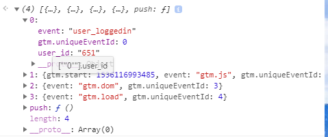

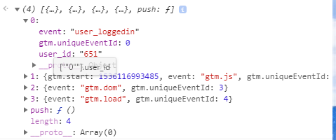

When using google analytics with eCommerce transactions, i am not able to get proper value in datalayer when i finish the checkout process. I am getting event value as "user_loggedin" but need something when it says the order details.
I order and item it goes to homepage back i check the datalayer but no order details, what should i supply in google tag manager as even value.
Attached screenshot is after finishing cart.
Thanks.

Thanks for the reply, I am using the hikashop and google analytics plugin with google tag manager, SO when a transaction is complete I go to console and type datalayer, to get data from datalayer to provide a variable to an even in google tag manager.
Steps to reproduce:
Configure google tag manager and google analytics, it is tracking pages fine all connection are completed
Use Google analytics eCommerce to track sales, in order to do that u am trying to get the tag to provide to google tag manager to track transactions. This tag is not coming up in datalayer.
Thanks.

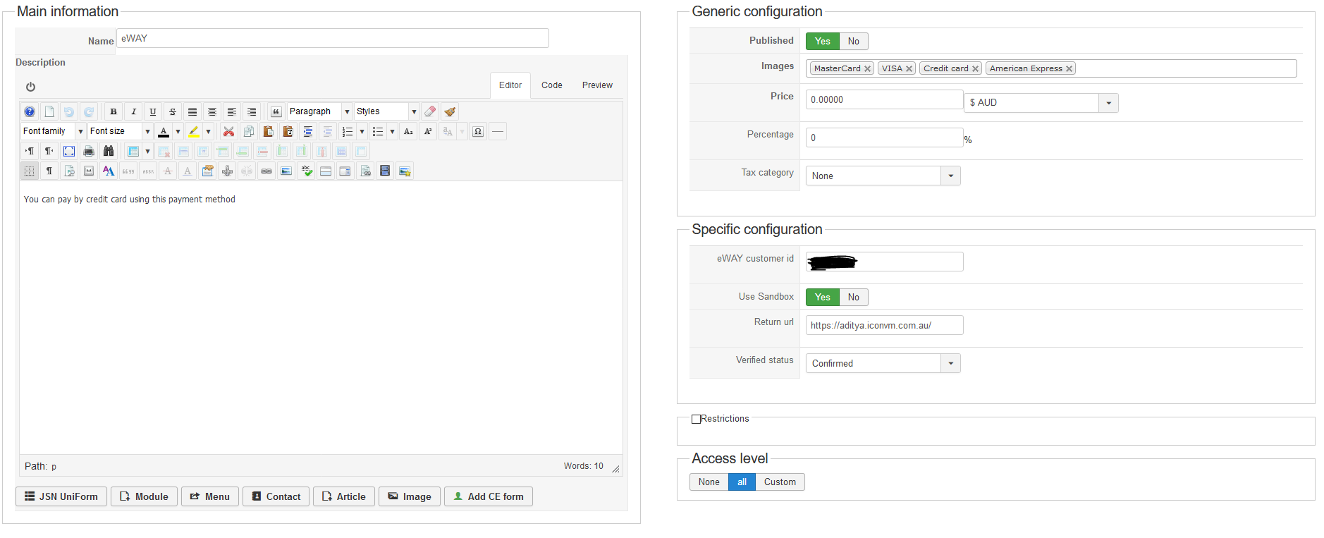

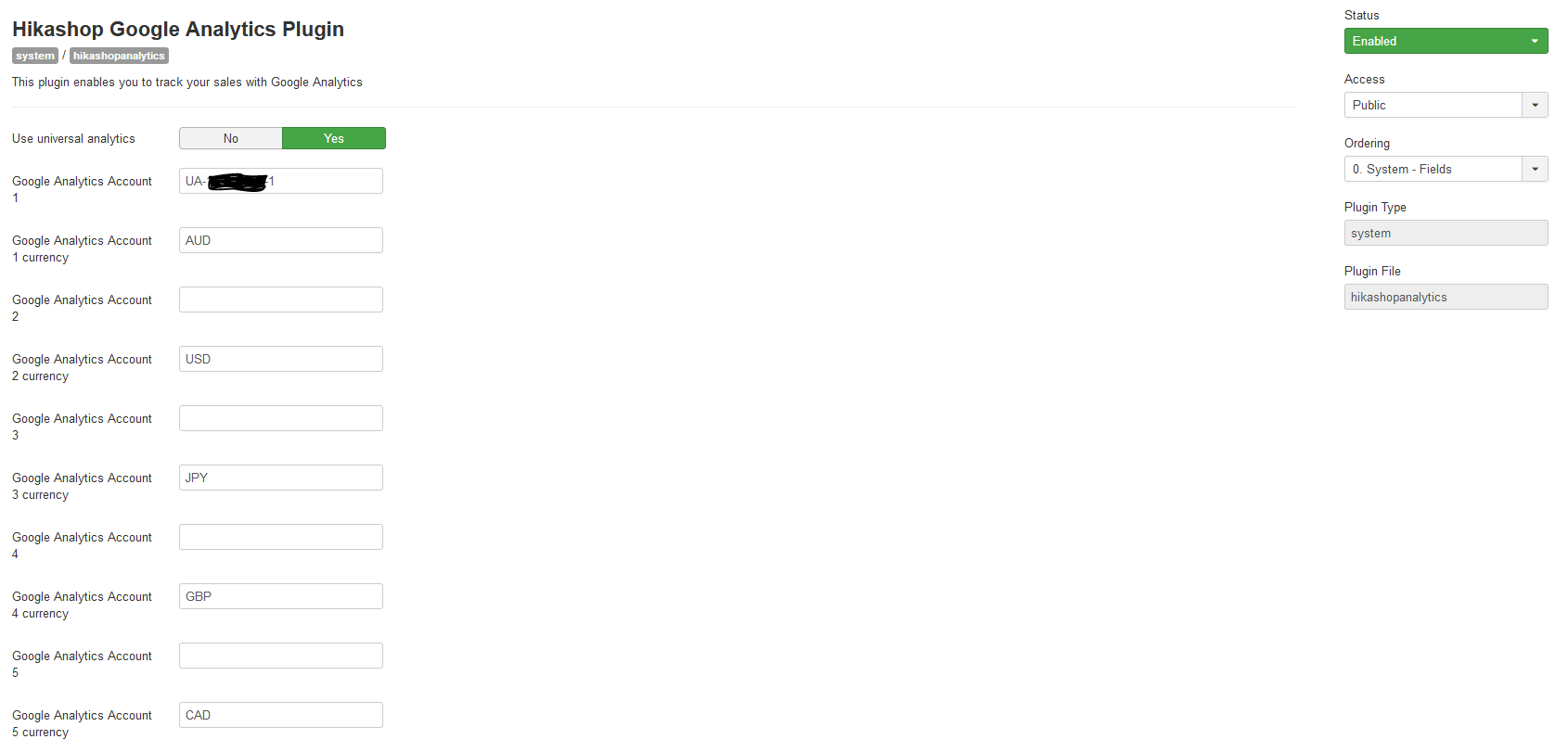

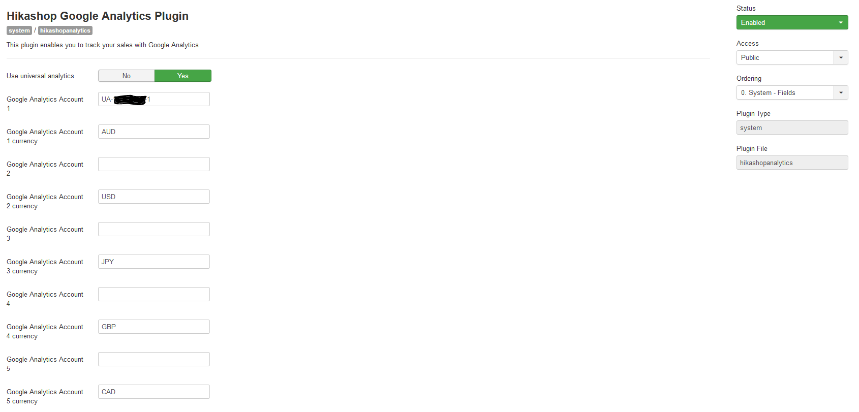

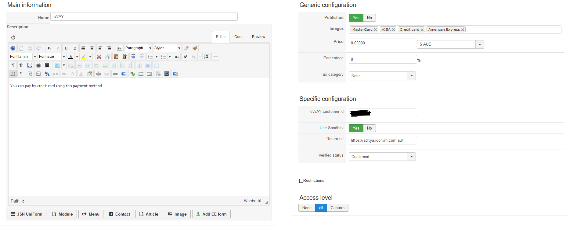

Can you provide a screenshot of the rest of the settings of the plugin ?
Also, which payment method are you using ?
And finally, is the status of the orders getting changed from "created" to "confirmed" after the payment ?
  • Posts: 58
7 years 11 months ago #297828
I am using eway as sandbox account. Yes,when i process the order it comes as confirmed.

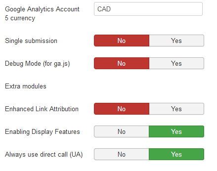

Since you're using the "direct call" mode of the plugin, it requires cURL to be activated on your server for your PHP and that outgoing connections are authorized by your hosting. So it might be the reason why the transactions don't appear in Google Analytics.
Otherwise, maybe you're not looking at the correct place in Google Analytics.
The transactions will end up in the menu “Conversions > Ecommerce > Sales Performance” and should look like that:
www.practicalecommerce.com/wp-content/up...nt-Transactions1.jpg
Turning off the direct call and / or the universal analytics settings might also help (so it would circumvent the connections being blocked on the hosting side by using javascript when the customer see the thank you page after the payment.

Could you enable the debug mode setting of the plugin and try again while the console of the browser is open ?
You might get some information in the console.
Also, after that, please check the "payment log file" setting of the HikaShop configuration. It should contain some information about the sending of the data to google analytics.
Also, check the order statuses in the menu System>Order statuses. The "confirmed" status should be enabled for the "invoice" column there. Otherwise, it might be why the orders are not taken into account.

For information you won't be able to see any information on your browser with the "Always use direct call (UA)" option enabled as the communication will be server to server.
These information will be stored when the debug mode is enabled on your log file which can be found via "Hikashop->System->Configuration->Main" using the "Payment log file" option.
Can you give us a temporary access to your back-end so that we can directly check it and investigate on your issue ? Thank you.

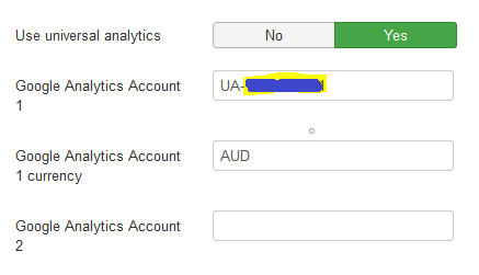

We just tested it on your end and the plugin debug mode was disabled that's why your payment log was empty. So we enabled it and tested id by using the same test credit card on the eWay payment method and the keyboard product.
The order was confirmed and a "direct call" request was correctly sent to Google analytics (cf screenshot).
Can you check through your analytics that you correctly received these information ? If not, can you download, install and test it with the attached version of the "Hikashop Analytics" plugin which contain code displaying more information about requests in your log file ? Thank you.

Thanks for your help order went through to ga. But looks like the its sending incorrect price is there anything i can do to make the price as same in hikashop.
Thanks.
Last edit: 7 years 10 months ago by iconvisual.
7 years 10 months ago #298449
The currencies aren't the same so it seems to be sending the correct price as 132.00 AUD is approximately equals to $95.81.
So everything should be properly sent to Google Analytics on your website.
