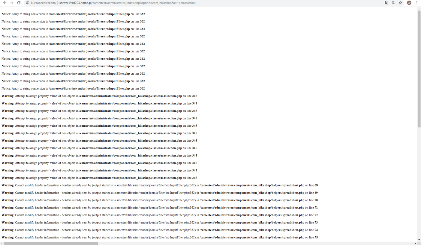

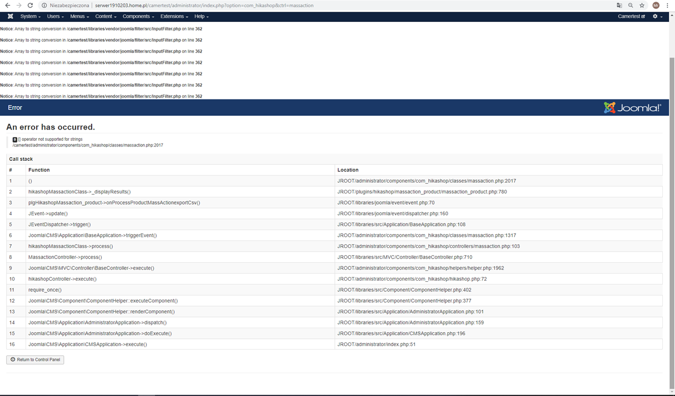

Hello, I have problem with mass actions – after I try to launch mass action I got following error message:
“An error has occurred. [] operator not supported for strings
/camertest/administrator/components/com_hikashop/classes/massaction.php:2017”
Notice: Array to string conversion in /camertest/libraries/vendor/joomla/filter/src/InputFilter.php on line 362
as presented here:
or following (depends on mass action parameters):
Warning: Cannot modify header information - headers already sent by (output started at /camertest/libraries/vendor/joomla/filter/src/InputFilter.php:362) in /camertest/administrator/components/com_hikashop/helpers/spreadsheet.php on line 68
