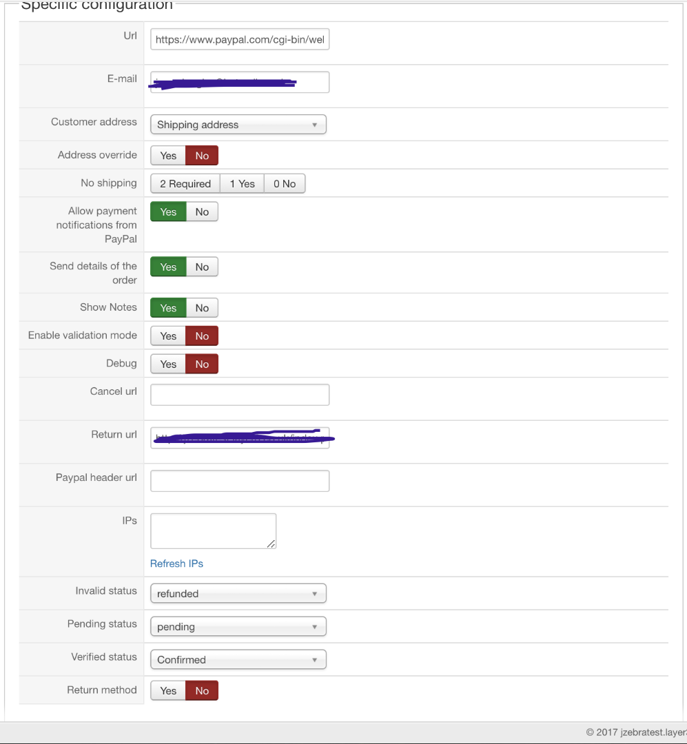

In the paypal method specific configuration I have:
Invalid status: cancelled
Pending status: pending
Verified status: Confirmed
What could I have done wrong in this site?
Thanks.

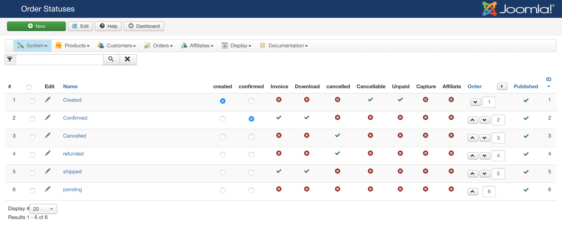

  • Posts: 220
  • Thank you received: 12
8 years 10 months ago #279322
The first enabled column is "cancelled" - please see attached.
Is there something else?
Thank you,

  • Posts: 86080
  • Thank you received: 14186
8 years 10 months ago #279330
Please deactivate all the statuses in that column. Then, activate "cancelled" first and then "refunded" to make sure that it is the first.
Also, make sure that the "created" status is activated in the "cancellable" column so as to authorize the customer to cancel orders with the "created" order status. Otherwise, it won't do the change.

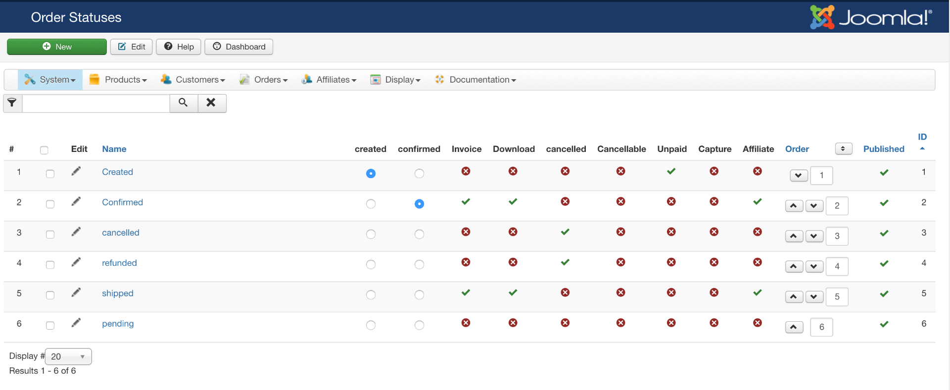

  • Posts: 220
8 years 10 months ago #279457
I have just tried this. The order status still remains "cancelled".
Thanks,
J.

  • Posts: 220
8 years 10 months ago #279874
Apologies, I meant to say "The order status still remains "created".
Please see attached images.
Thanks,
Josh.
