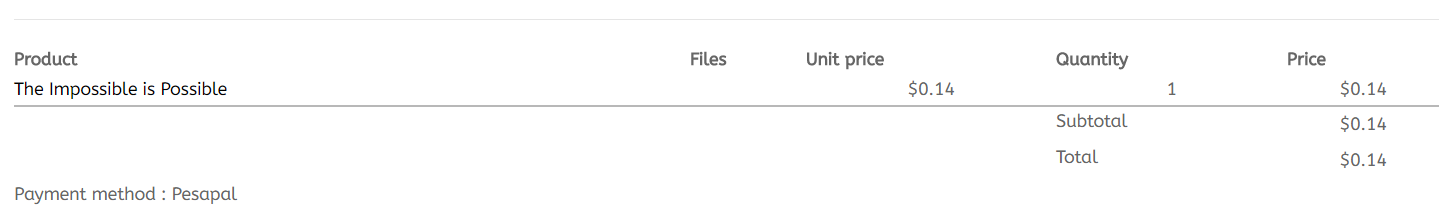

Hello, I'm using a starter version of Hikashop, after payments, I don't receive the download link in my email, I only get a link to my order details which does not come with a link to the file as shown in the image attacked.
Kindly help, Thanks in advance, willing to share logins with support team.

Is the order status changed to confirmed ?
If not, then the issue is with the payment notification:
www.hikashop.com/support/documentation/i...or.html#notification
If yes, then the issue is with the way you configured the order statuses in the menu System>Order statuses for the "download" column. Make sure that the "confimed" status is enabled there.

Thanks for the response, yes I have confirmed the order manually in the back end and the file is now showing in the front end,
One more question, is there a way for orders to get automatically confirmed when the payment is made?

That task is done by the payment plugin(s) you have configured.
For each plugin, you have a "verified status" which will be used to update the order when the payment confirmation is received.
CF : www.hikashop.com/support/documentation/6...st-sale.html#payment
Also, supposing that you're using PayPal, we have a documentation specifically for that issue with PayPal:
If you follow the instructions there, you should be able to find out why the orders are not confirmed automatically.
