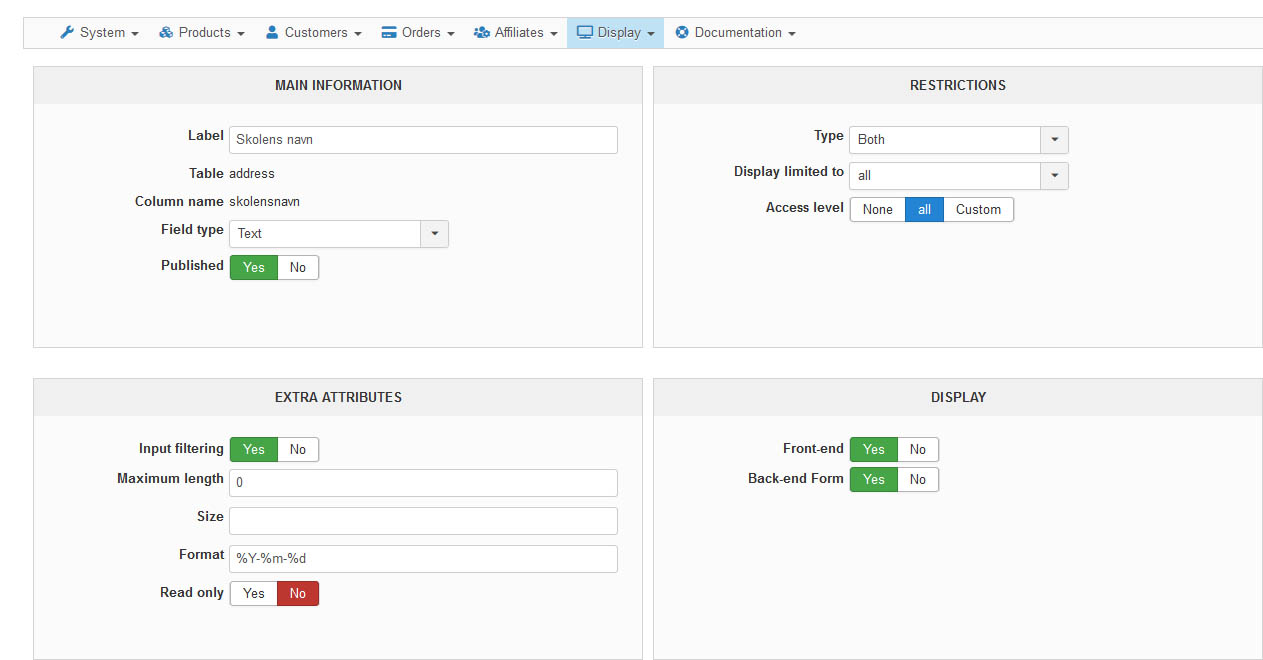

i cant figure out what i should write when i want to have extra fields i have made in the checkout.
i have added 3 new address fields.
goal:
Getting it to the invoice and in the backend in orders.
Do you have an guide i can use ?
Best regards
Brian
Last edit: 6 years 1 month ago by Nowweb.
6 years 2 months ago #321811
Even if I read that you want add an address custom field, maybe you are going to have to used an Order type custom field.
After, you can put your fields block close to address block in your Checkout Workflow settings.
The advantage of Order custom filed is that it can be displayed in several view, and among this possibilities Invoice and backend page.
Note : Have a look on this documentation about display option per custom field type.
Hope this will fit your needs
Last edit: 6 years 2 months ago by Philip.

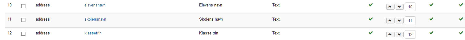

  • Posts: 145
6 years 2 months ago #321849

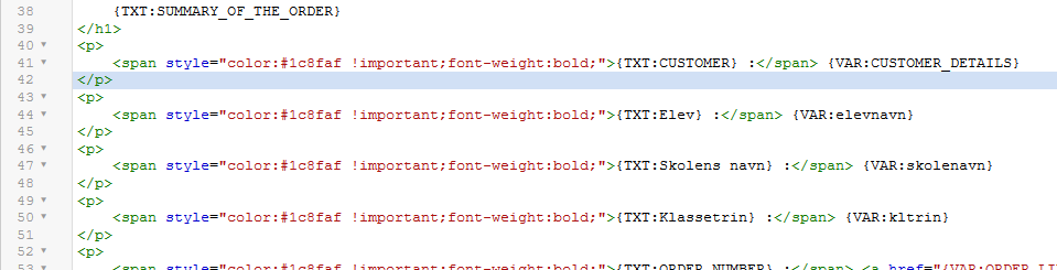

i have made this in the administrator notification mail
</p>
<p>
	<span style="color:#1c8faf !important;font-weight:bold;">{TXT:Elev} :</span> {VAR:elevensnavn}
</p>
<p>
	<span style="color:#1c8faf !important;font-weight:bold;">{TXT:Skolens navn} :</span> {VAR:skolensnavn}
</p>
<p>
	<span style="color:#1c8faf !important;font-weight:bold;">{TXT:Klassetrin} :</span> {VAR:klassetrin}
</p>
And i have made this in the Display > Custom fields
What do i do wrong here ?
I do not get the {VAR: } on the email fot the administrator notification
Best regards
Brian

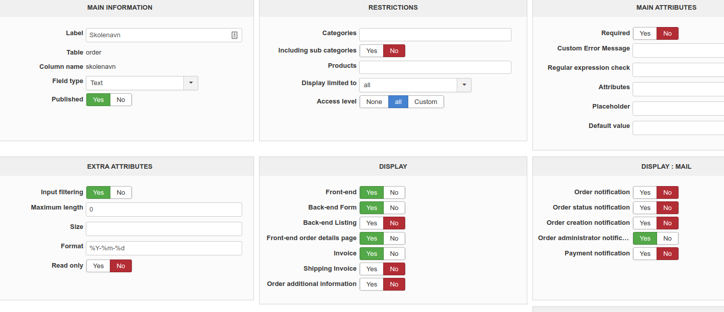

6 years 2 months ago #321856
As said in my previous message you have to use order type custom field, address type can't be used in email (and several other HikaShop pages).
Keep same idea, but with order type custom field.
  • Posts: 145
6 years 1 month ago #322095
now i have tried as you told me.
It still not come with the ORDER_ADMIN_NOTIFICATION_SUBJECTe-mail. What do i do wrong?
Best regards
Brian

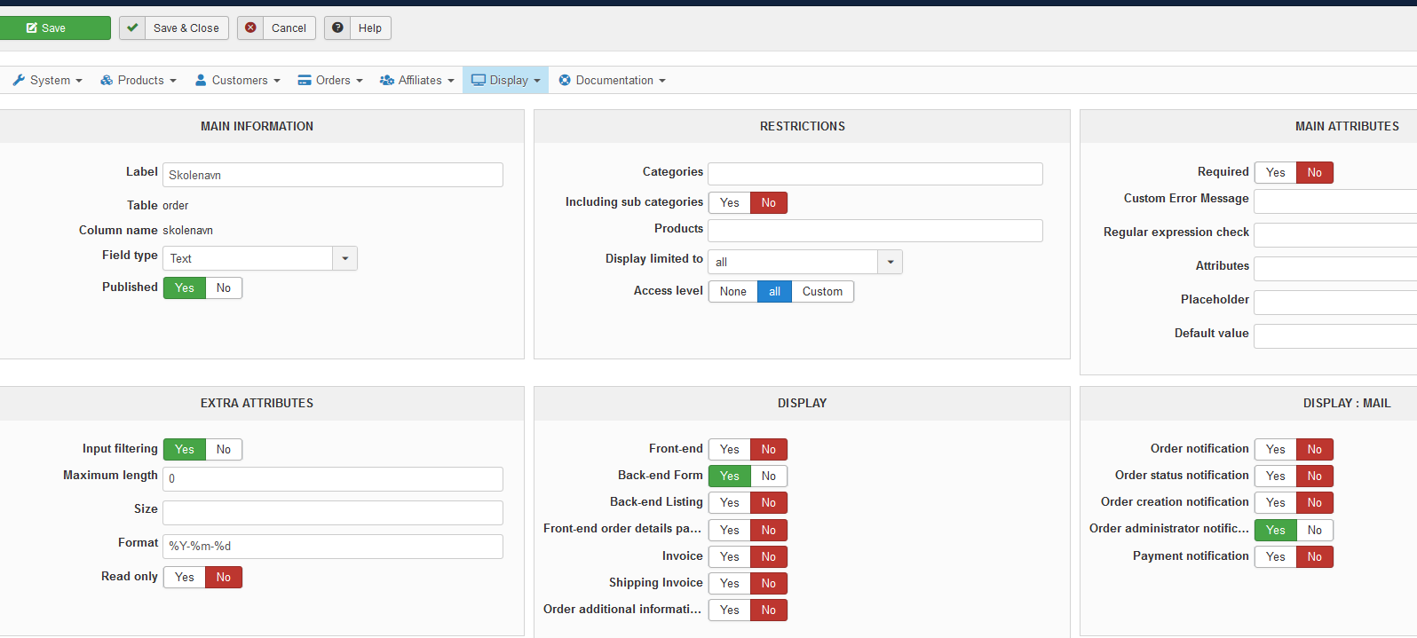

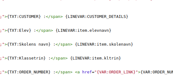

  • Posts: 145
6 years 1 month ago #322450
Now i have tryed to change the line to {LINEVAR:item.elevnavn} and {LINEVAR:product.elevnavn}
but it does not show on the administrator e-mail notification.
I have done your suggestions and followed the instructions on the website.
What am i missing or misunderstood.
Best regards
Brian
6 years 1 month ago #322451
As your custom field is an order type (or table), you have to follow to build your email tag, example :
{LINEVAR:TABLE.XXX}
=> In your case to follow your example :
{LINEVAR:order.skolenavn}
Last edit: 6 years 1 month ago by Philip.

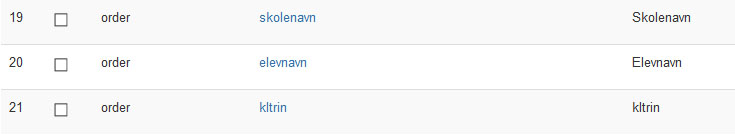

  • Posts: 145
6 years 1 month ago #322871
i still cant it to work
I have made the code like this
<p>
	<span style="color:#1c8faf !important;font-weight:bold;">{TXT:Elev} :</span> {LINEVAR:order.elevnavn}
</p>
<p>
	<span style="color:#1c8faf !important;font-weight:bold;">{TXT:Skolens navn} :</span> {LINEVAR:order.skolenavn}
</p>
<p>
	<span style="color:#1c8faf !important;font-weight:bold;">{TXT:Klassetrin} :</span> {LINEVAR:order.kltrin}
</p>

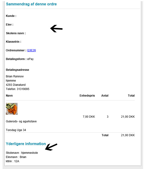

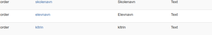

then i have made the custom fields like this
now the email notification look like this, the goal is the get the text from the buttom to the top.. but that do not work.
What can i do for move the text up??
Best regards
Brian

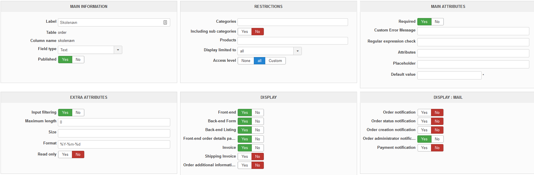

6 years 1 month ago #322874
Among your elements there are something that I really don't understand, which is how you can have a "format" in Extra Attribute part, this type of parameter is normally only for date type custom filed...
we don't understand how it's possible, for some reason it looks like your custom field is "malformed", database manipulation, bug while you created it, so far we don't know...
The best move is to recreate your custom field, can you try this please ?
  • Posts: 145
6 years 1 month ago #322903
Thanks you, now it i solved.
Best regards
