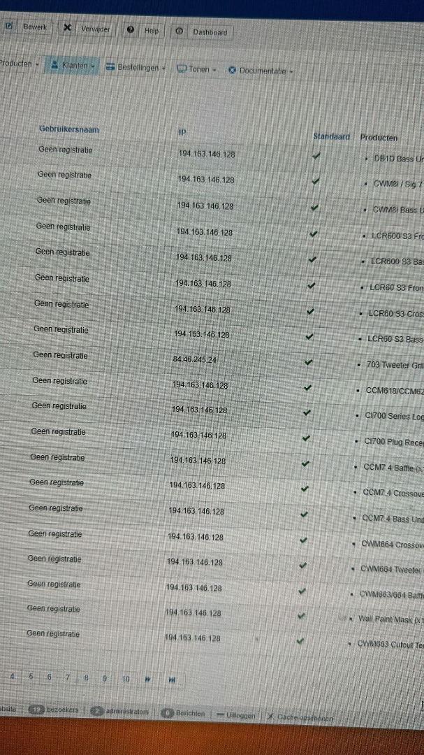

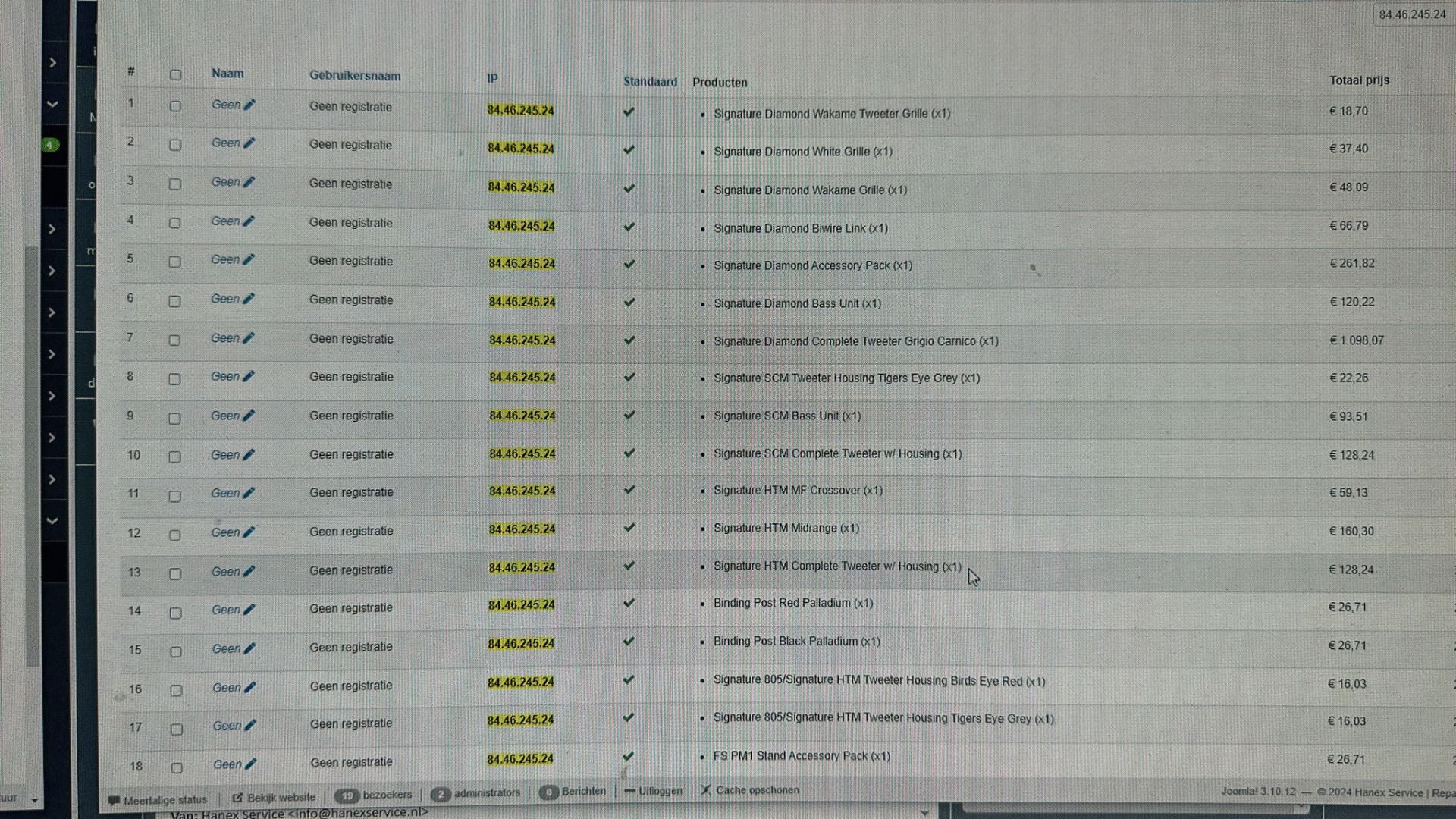

I have a "spam" problem.
A visitor from rusland creates 5 new carts per minute.
Adding a product to the cart doesn't use a captcha, but is there a way to prevent users/bots from doing this? (limiting option or something?)
Of course we can set the option to max 1 cart per user, but we need multiple for our real clients.
Thanks in advance.
Attachment not found

At this moment it looks like a crawler which is calling the add to cart button on every page.
I blocked this specific crawler (doesn't seem an important one) and the cart creation stops for now.
