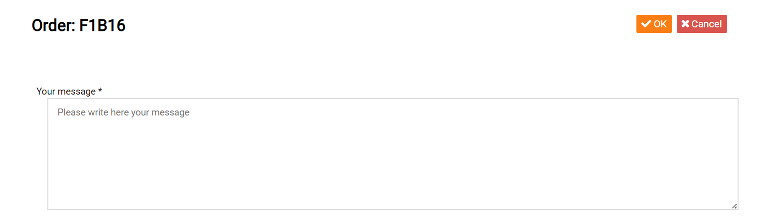

The email goes to the email address you specify in the "Contact request email address" setting of the HikaShop configuration. You can change that setting, but you can't have it dynamic.
How is the salesperson associated with the order ?
That would probably require some kind of customization in System>Emails in order to override the email address of the recipient.

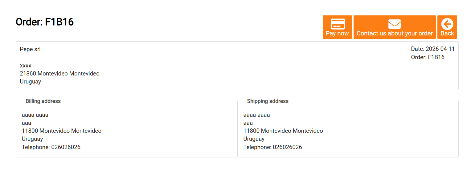

Case 2: I access the order details, where the button "Contact us about your order" is displayed. Messages sent from this form continue to be sent to the ecommerce administrator. Is this the behavior you expect? As I mentioned before, the ecommerce administrator is not the appropriate person to respond to or coordinate actions regarding an order.
There may be cases where the buyer wants to contact the ecommerce administrator, and it would be good to have that option available. However, above all, the buyer should be able to easily contact the vendor of the product.

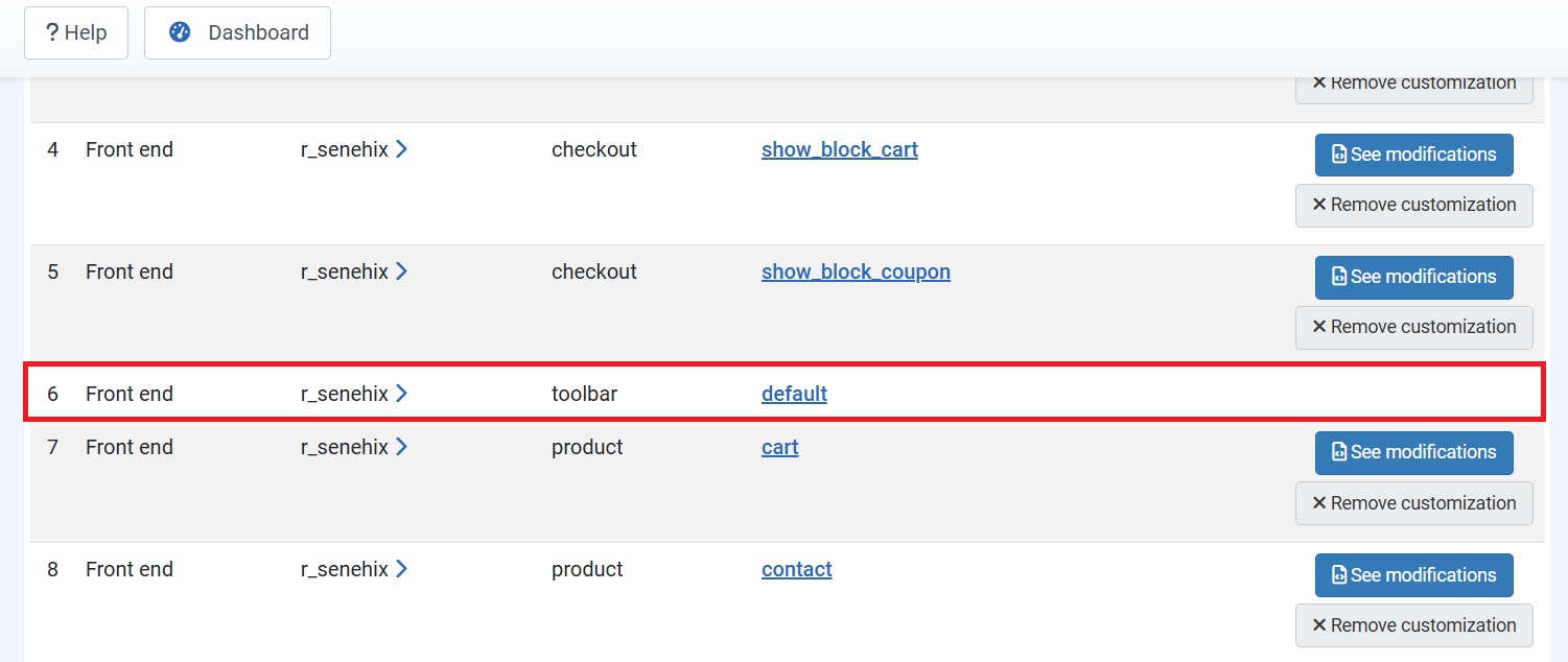

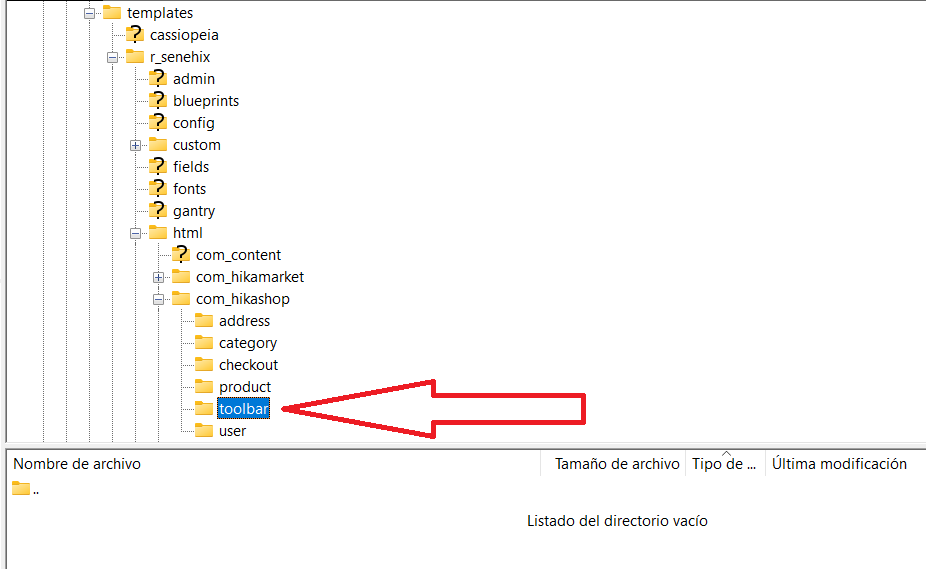

The expected behavior is to have on both cases a "Contact XXX" button where XXX is the name of a vendor (you'll have one button for each vendor, so if the user placed an order for products from 3 different vendors, he'll have 3 buttons, one per vendor), plus a "contact us about your order" which goes to the admin.
If you don't see the vendor specific buttons on the order details page, it could be because you have an old view override of order / show.php or toolbar / default.php in your template.
So please check for these under the templates/YOUR_TEMPLATE/html/com_hikashop/ folder via FTP. If you have one of them, rename it to deactivate it and see if that helps.
  • Posts: 73

I checked the view being used to display the toolbar on the order details page, "Toolbar -> Default". I edited it from "HikaShop panel -> Display -> Views", added text, and it appeared on the buttons. When I removed the customization, the button text disappeared. Both in the HikaShop, panel and when accessing via FTP, there are no customizations to that view, but the "Contact Vendor" button still doesn't appear.
I also checked the CSS styles that might be hiding the button, but that's not the problem.
Any other suggestions?

Hi, after submitting the data, I ran more tests, but this time I completed the entire flow, from purchasing the product to sending the message from the order details page.
Once the order is completed, a link to the order details is displayed. In this case, the "Contact Seller" button is shown, but if I exit the order and access the details again from the order list, the "Contact Seller" button no longer appears.
Do you have access to review this?

    display: none !important;
in the "styles for the frontend" setting of the HikaShop configuration.
This CSS forces the 4th button of the toolbar to not display on all the frontend views of HikaShop.
I suppose you've added it to hide a button in a specific view.
The problem is that this CSS should have a parent id or class added to it in order to restrict it to the view you want to target.
For example, if you only want to target the order details page, it should be:
#hikashop_order_main .hika_toolbar_btn.hika_btn_32 a:nth-child(4) {
But since I don't know which button of which view you wanted to target, I can't say what should be the exact code.
The simplest would be to remove that CSS code completely for now, and if you find out the button you want to remove later on, look into it again and add the proper CSS with the parent id / class to make sure it doesn't leak to other views.
The following user(s) said Thank You: nmacri
