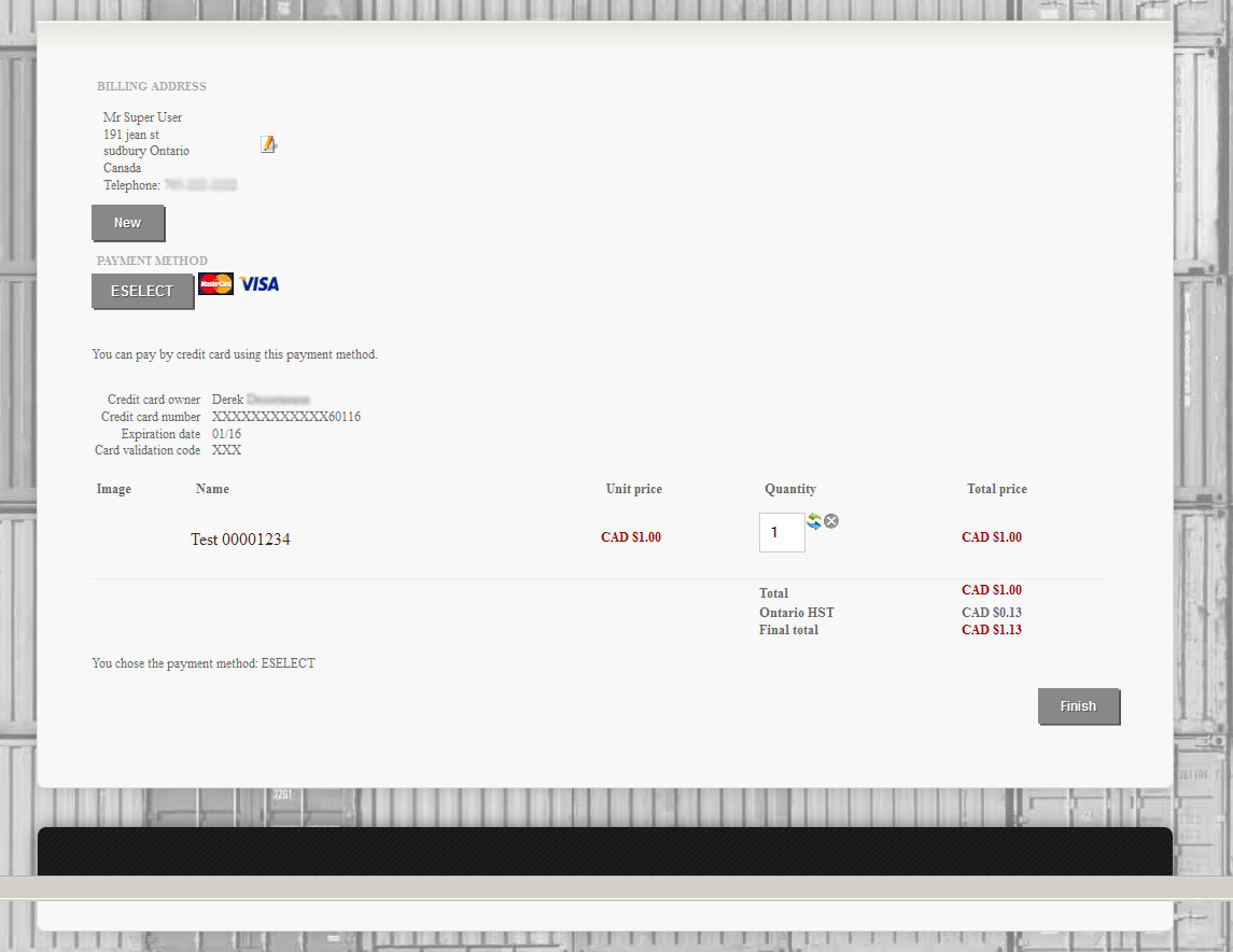

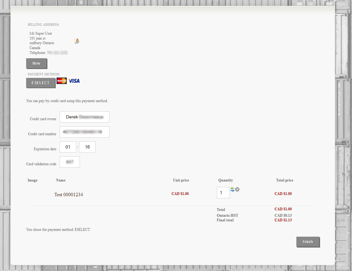

  • Posts: 26380
12 years 3 months ago #152149
Regarding your screenshots, the first one is the one where the customer enter his information and the second one when HikaShop display the summary of the credit card info.
So you have to click once more to validate the payment.

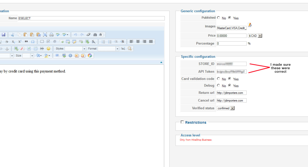

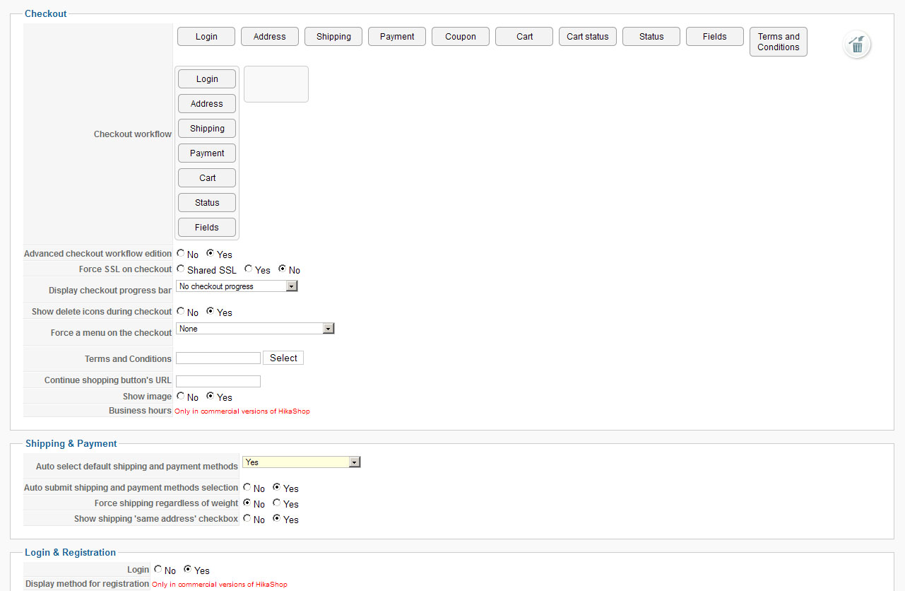

  • Posts: 40
12 years 3 months ago #152378
Sure. Here is the screenshots for my payment set up and my checkout flow. Can anything else be affecting it?
  • Posts: 26380
12 years 3 months ago #152419
Does your template display the Joomla messages ?
www.hikashop.com/support/support/documen...issues.html#messages
www.hikashop.com/forum/4-how-to/42109-pr...istration.html#42184
I saw that eselect/moneris changed the url of the production site without notification (I have a developer account on their website, I am surprise that I never got an email for such ultra-important news).
The url in the debug mode is now the url in production mode. I don't know if the same url works for both modes or if the debug mode need a new url too.
More than that, the eselect/moneris payment plugin in HikaShop is just compatible with the Canadian version. The US version have now a new different API with other url and other parameters. That's also a news that they didn't talk much about...
