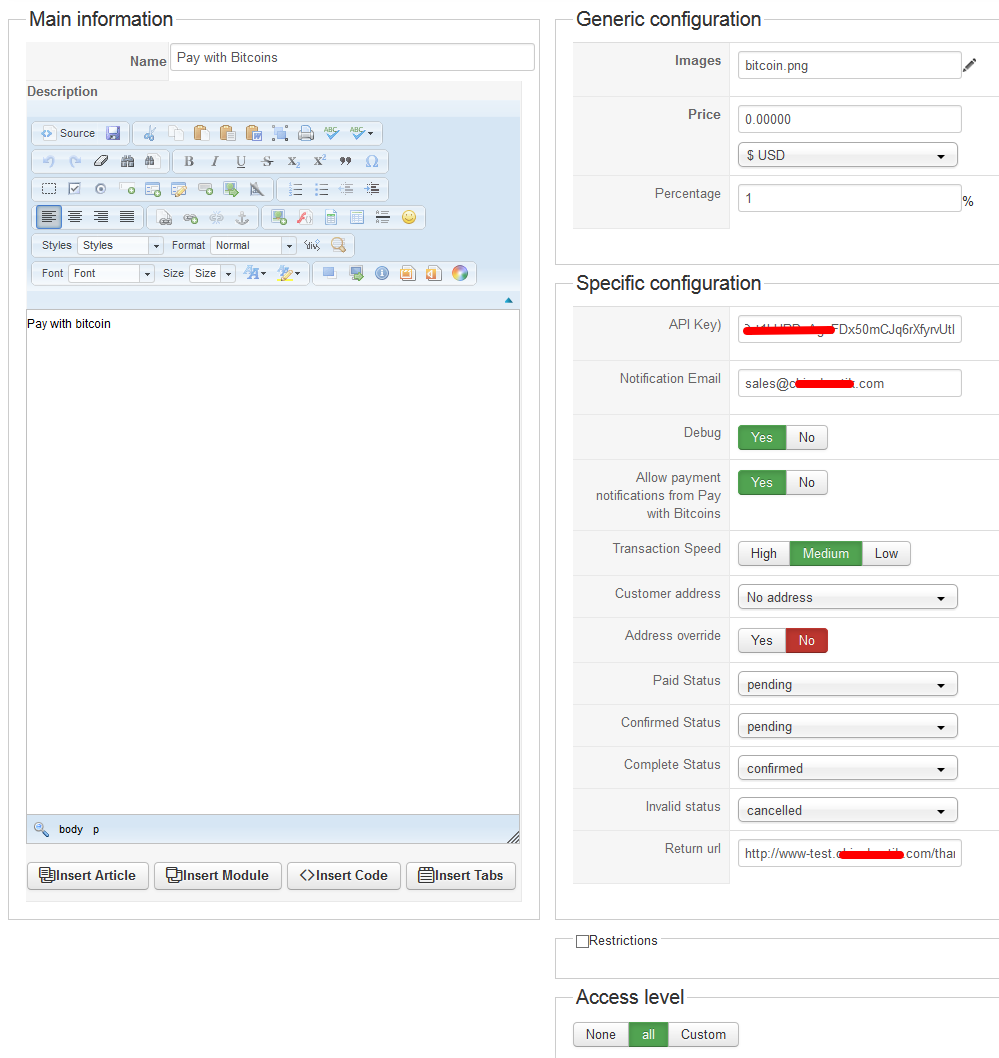

Additionally here is a screenshot of my plugin configuration,
Last edit: 11 years 10 months ago by cbadmin. Reason: Added screenshot

BUT, the order statuses still do not update according to the Bitpay notifications.
Order status still stay on 'created' and never change. Check screenshot of my configuration in previous message.
Did anyone manage to have the Bitpay notifications work? Help!
