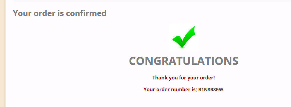

Hi Ok got this to display using;
{source}
<?php
$app =JFactory::getApplication();
$order_id = $app->getUserState('com_hikashop.order_id');
echo $order_id;
{/source}
but then realised that it's the order number I am after so changed the code to;
{source}
<?php
$order_number = $app->getUserState('com_hikashop.order_number');
echo $order_number;
{/source}
and now it will not display the order number like it did with the order_id?

  • Posts: 589
  • Thank you received: 12
10 years 9 months ago #217219
Hi Nicolas, Appreciate your comments and assistance.
Not being a programmer but a Hikashop user, I would not know what's in your remit or not, I was not advised to find assistance elsewhere for the information that I required to achieve my goal or else I would have done.
Anyway thank you for this as my goal has now been achieved.
