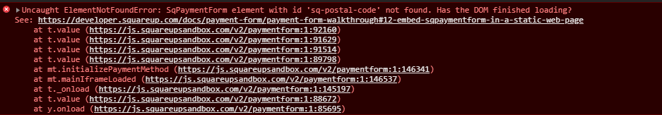

How do I remove the requirement to enter the postal code? This is practically never used in regular payment gateways and as its noted as just "POSTAL" it will confuse the user. Postal what? Postal address? Postal code? Zip code?
We actually had a "disable postal code" field in previous version of Square which was creating a lot of issue as they want that field to be displayed, so we removed it on that version.
We'll do some research to find a way to not display postal code !

3. When we try to remove the postal code we actually get the attached JavaScript error, which mean that they won't allow us to hide it.
We found a solution. The default value of the postal code field is now set to your customer's order billing address.
==> You'll just have to use the new "Hide Postal code" option which directly hide the post code field.
