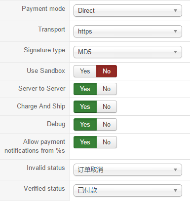

- Show us its content

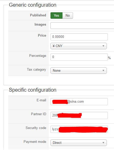

Also can you show us some screenshots of how you configured your Alipay payment method ? Because you should also make sure to enable the "Allow payment notifications" option

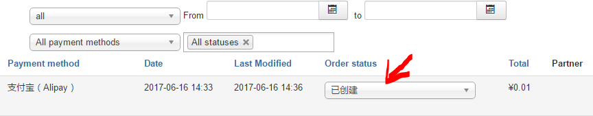

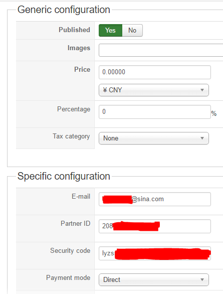

  • Posts: 12

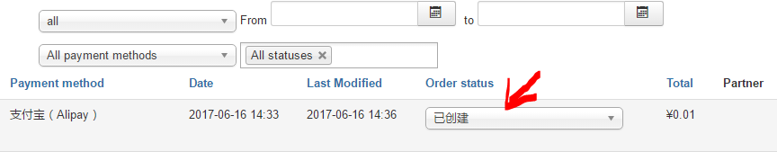

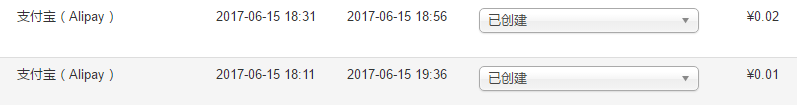

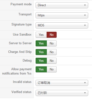

8 years 11 months ago #272048
I just try it again, but the issue still exists.
The attachment is my screenshot of the steps.
And the logs of alipay payment shows that, a 301 redirect.
Plese check it.
Last edit: 8 years 11 months ago by Jerome.

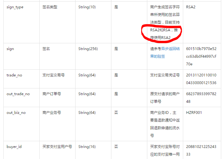

Using the new alipay payment interface, when a user open the payment page on mobile phone, it will automatically call alipay mobile client to complete the payment if it been installed on the phone. Otherwise,it will continue to complete the payment through the alipay website page.
It will improve the user's payment experience. After all, mobile payment has become mainstream.
Important:MD5 is not supported for sign_type with the new alipay wap payment interface.Official recommended RSA2.

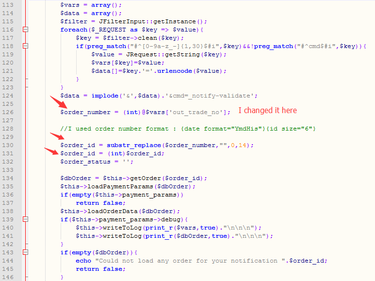

  • Posts: 12
8 years 11 months ago #272166
I will try to find some english documentation or translate the key document for you, if i have free time.

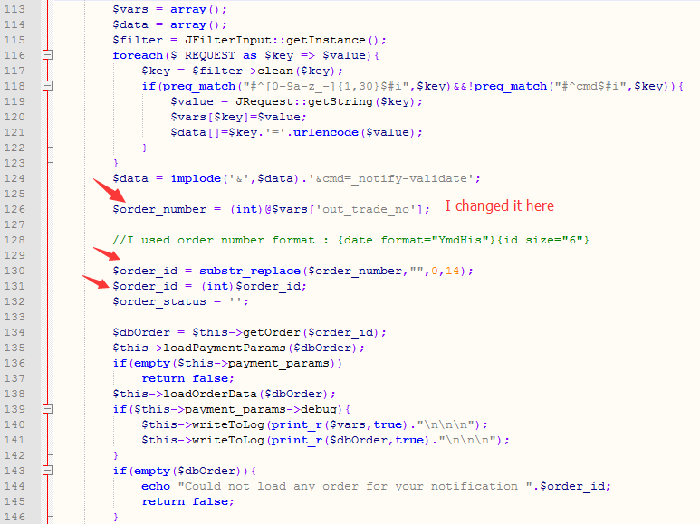

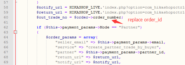

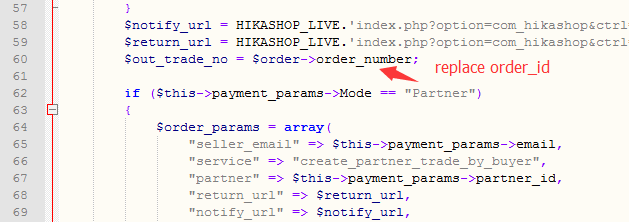

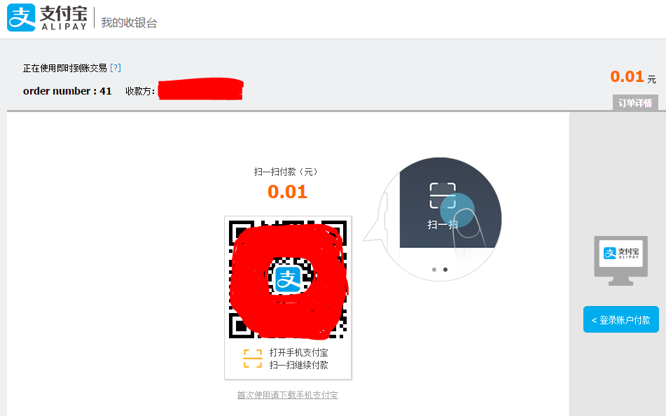

Now I still have a problem that needs your help. I want use order_number as the value of $out_trade_no.
I tried to replace some of the code and can complete the payment. However, there is no order status update, no alipay payment notification, no payment log records(debug is on).
What should i do?
Last edit: 8 years 11 months ago by iaiai.

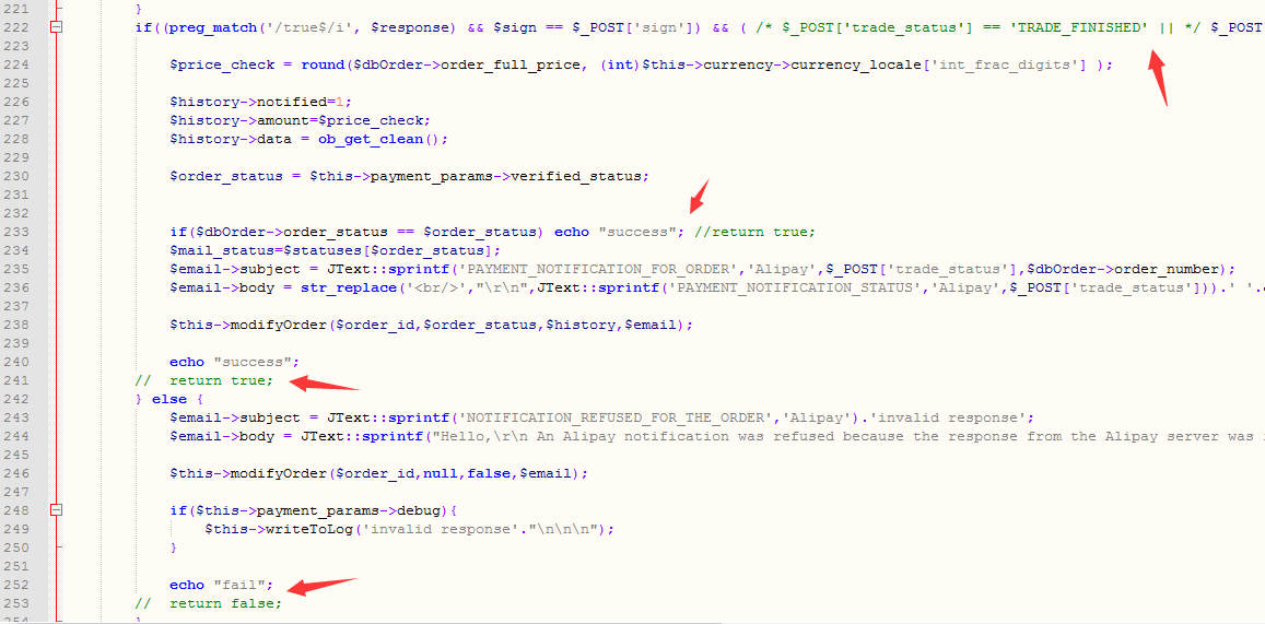

  • Posts: 12
8 years 11 months ago #272174

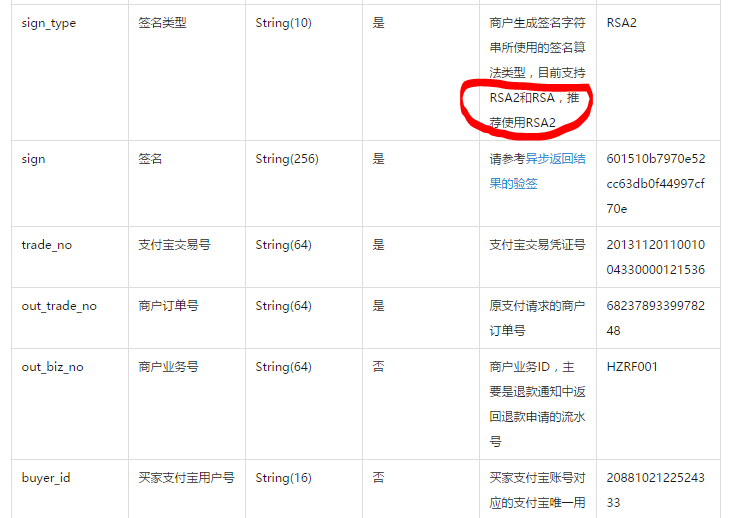

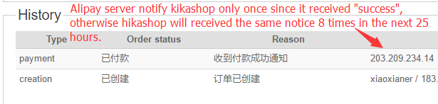

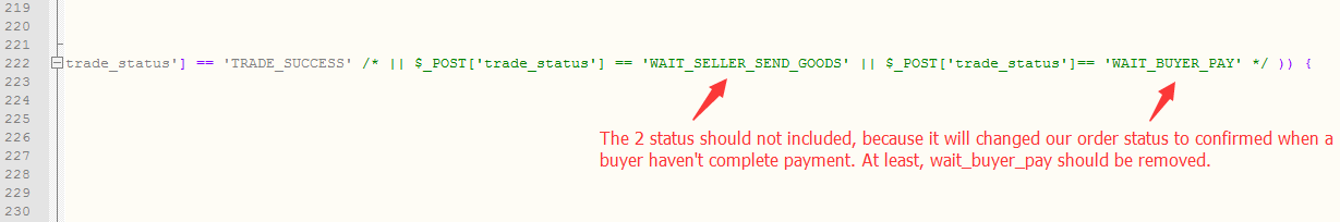

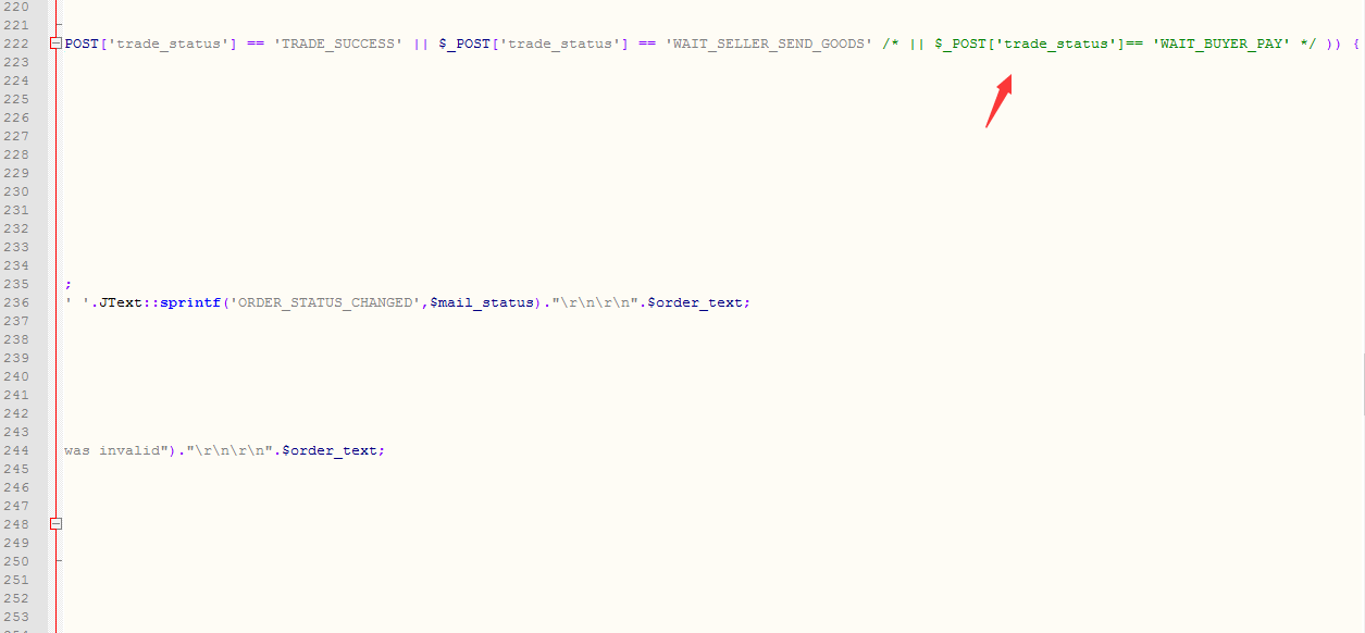

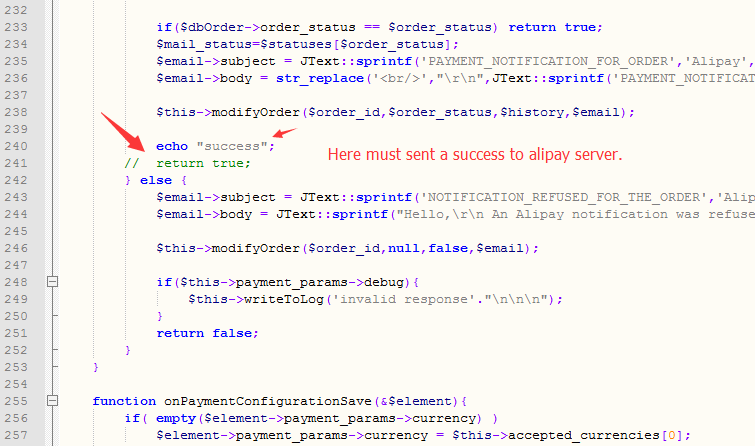

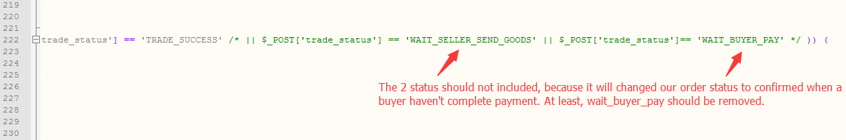

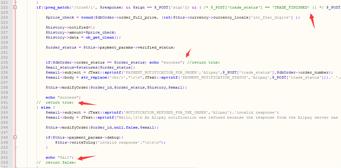

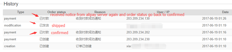

Here is my suggestion for the alipay plugin.
Please check the screenshot.
The official document highlights this:

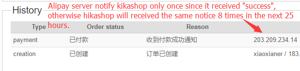

程序执行完后必须打印输出“success”(不包含引号)。如果商户反馈给支付宝的字符不是success这7个字符,支付宝服务器会不断重发通知,直到超过24小时22分钟。一般情况下,25小时以内完成8次通知(通知的间隔频率一般是:4m,10m,10m,1h,2h,6h,15h);
当商户收到服务器异步通知并打印出success时,服务器异步通知参数notify_id才会失效。也就是说在支付宝发送同一条异步通知时(包含商户并未成功打印出success导致支付宝重发数次通知),服务器异步通知参数notify_id是不变的。
docs.open.alipay.com/270/105902#s7

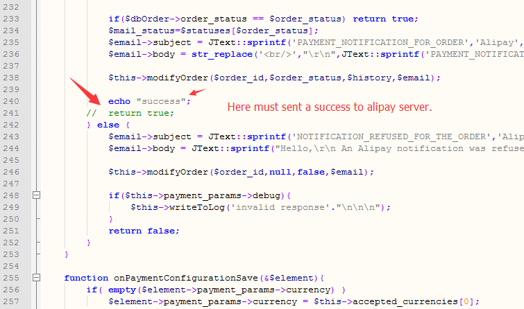

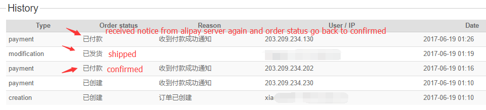

  • Posts: 12

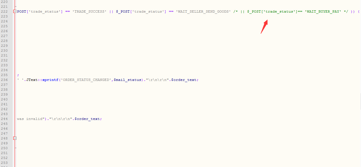

8 years 11 months ago #272210
Repeated notifications still exist, even if I print out "success".
My modified code:
 		if((preg_match('/true$/i', $response) && $sign == $_POST['sign']) && ( /* $_POST['trade_status'] == 'TRADE_FINISHED' || */ $_POST['trade_status'] == 'TRADE_SUCCESS' || $_POST['trade_status'] == 'WAIT_SELLER_SEND_GOODS' /* || $_POST['trade_status']== 'WAIT_BUYER_PAY' */ )) {
			$price_check = round($dbOrder->order_full_price, (int)$this->currency->currency_locale['int_frac_digits'] );
			$history->notified=1;
			$history->amount=$price_check;
			$history->data = ob_get_clean();
			$order_status = $this->payment_params->verified_status;
			if($dbOrder->order_status == $order_status) echo "success"; //return true;
			$mail_status=$statuses[$order_status];
			$email->subject = JText::sprintf('PAYMENT_NOTIFICATION_FOR_ORDER','Alipay',$_POST['trade_status'],$dbOrder->order_number);
			$email->body = str_replace('<br/>',"\r\n",JText::sprintf('PAYMENT_NOTIFICATION_STATUS','Alipay',$_POST['trade_status'])).' '.JText::sprintf('ORDER_STATUS_CHANGED',$mail_status)."\r\n\r\n".$order_text;
			$this->modifyOrder($order_id,$order_status,$history,$email);
            echo "success";
		//  return true;
		} else {
			$email->subject = JText::sprintf('NOTIFICATION_REFUSED_FOR_THE_ORDER','Alipay').'invalid response';
			$email->body = JText::sprintf("Hello,\r\n An Alipay notification was refused because the response from the Alipay server was invalid")."\r\n\r\n".$order_text;
			$this->modifyOrder($order_id,null,false,$email);
			if($this->payment_params->debug){
				$this->writeToLog('invalid response'."\n\n\n");
			echo "fail";
		//	return false;

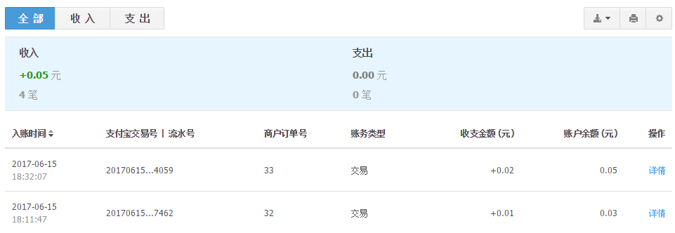

'TRADE_FINISHED' means that,After the order is completed for three months, the refund will not be allowed and the alipay server will send the notification to hikashop three months later, allowing the merchant to perform a custom action based on the result of this notification.

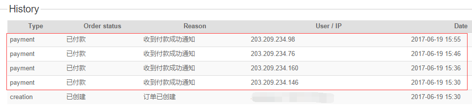

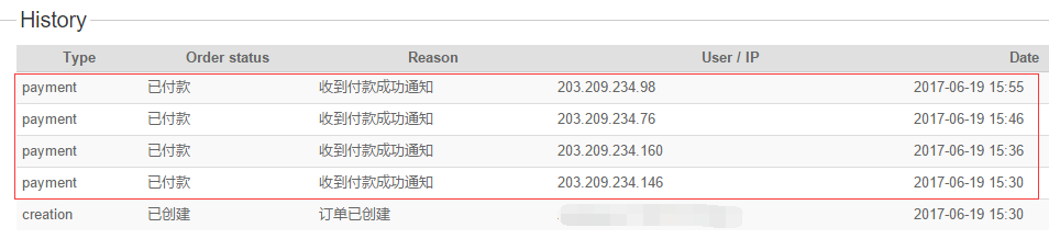

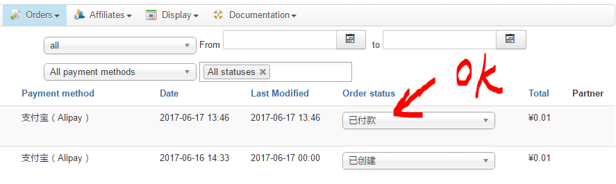

更新分割线
Maybe echo "success" only works for the two gateway mapi.alipay.com/gateway.do and openapi.alipay.com/gateway.do .

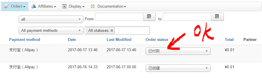

I used return "success", Now it works fine. See screenshot 5.

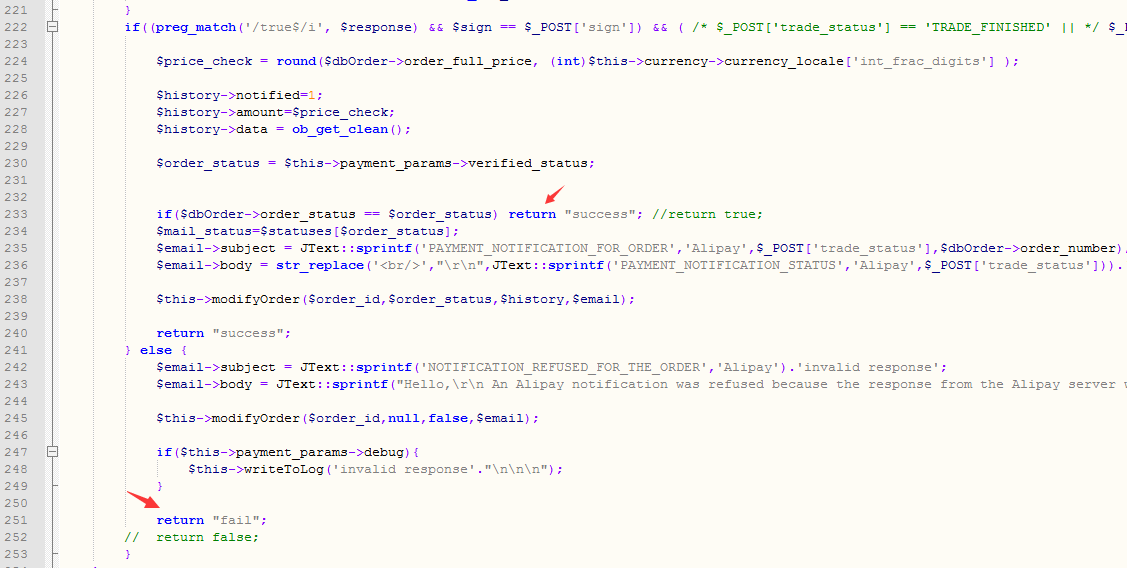

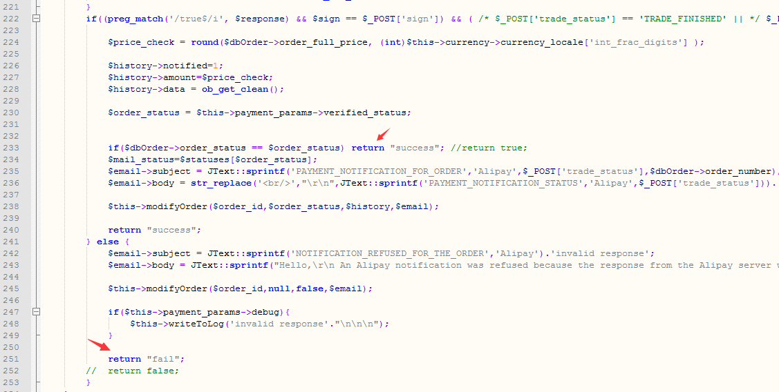

8 years 11 months ago #272226
The best solution will probably be to use :
return "success";
Instead of :
 echo "success";
And :
return "fail";
Instead of :
 echo "fail";
EDIT
Good ! Thank you for your feedback.
