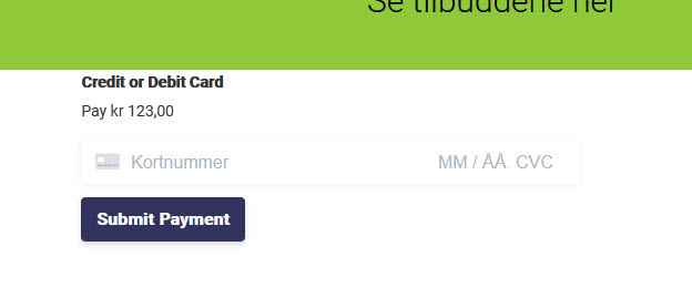

I just purchased the Stripe payment plugin and installed it.
When making a payment the layout of the payment page does not look very nice. Not something I would trust to put in my creditcard numbers.
Is there a way to use the payment page from Stripe?

The payment page is the default "Stripe Element" layout.
CF : stripe.com/docs/stripe-js
It is possible to override the payment view and use the possibilities of "Stripe Elements" to change the look (and colors).

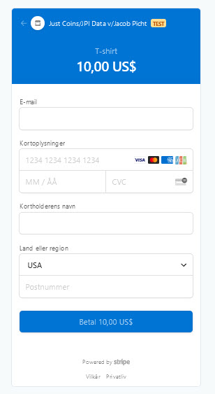

But, the screenshot you're showing is "Stripe Checkout" which is something very very different than Stripe Elements.
I talked a bit about it some time ago : www.hikashop.com/forum/payment-methods/8...html?start=80#310685

Is it possible to use Strpie Checkout with your plugin?
Or can I find another plugin to use for Stripe Checkout?

It's not possible to use Stripe Checkout with this plugin.
Stripe Checkout is a completely different API of Stripe and it would require rewriting the plugin from scratch to use it.
The Stripe connect plugin from Obsidev is the only Stripe plugin available for HikaShop at the moment.
Now it's always possible to have someone develop the plugin for you. We have partners you can contact for that if necessary:
www.hikashop.com/home/our-partners.html
However, customizing the look of the payment page will be easier and cheaper than redeveloping a whole payment plugin.
