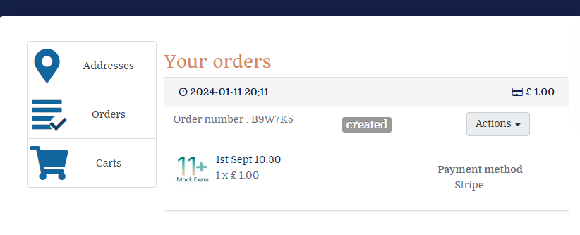

Hi, I purchased the stripeconnect_hikashoppayment plug in,
added the correct details, and it does not complete.
I'm unfamiliar with Stripe and wondering if anyone knows should I be doing something more at the stripe end of things.
also, even though payment failed, the order goes into the customers account as created and lowers stock / availability by 1
then in their account, does not allow to complete payment.
can you advise?
thanks

2 years 6 months ago #358170
What error do you get at the end ?
The fact that the order is created is normal. It's created when you click on the "finish" button, before the payment plugin takes on to process the payment. The order's status will then change from "created" to "confirmed" after the payment.
So that someone else doesn't place another order at almost the same time and you end up with two people purchasing the same product with a stock of 1, the stock is decremented at the creation of the order. Then, when the order is cancelled, the stock will be released.
You can potentially have the stock update only after the order is confirmed by changing the "update stock when order is" setting of the HikaShop configuration page, but you risk having orders for which you don't have stock available.

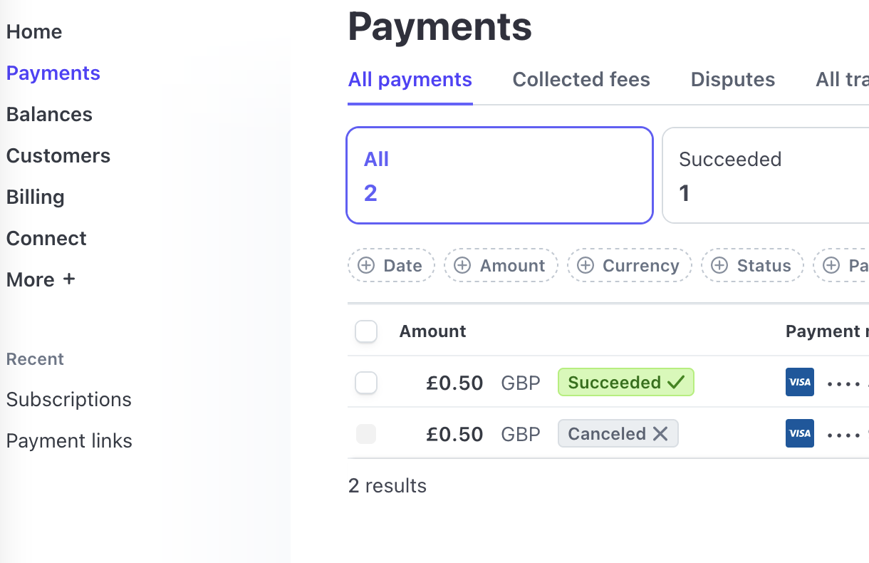

  • Posts: 82
  • Thank you received: 6
2 years 5 months ago #359252
Thanks for the info. It sort of helped.
I went into Stripe "Payments" tab and found why the payment hadn't worked (see screenshot) - price of product was too low. It was a testing product set at 0.01 - needs to be set above 0.50.
All working now.
Also, just a bit of additional info for anybody else who's a little bit stuck with Stripe, if Stripe is in test mode, you need to use the test cards. See here: docs.stripe.com/testing
