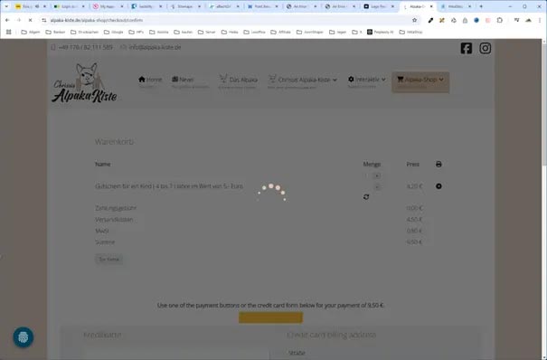

Hello everyone,
I have a problem with PayPal payments in HikaShop and hope someone can help me.

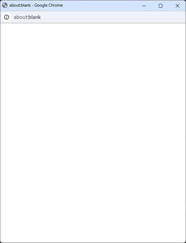

When I click on "PayPal" in the shopping cart, a small popup with a blank white page always appears, which shouldn't happen. If I close this window, another small popup appears with the prompt "Confirm your identity." There, I can choose to receive an SMS, but then an error message appears saying, "An error occurred."
The strange thing is: sometimes the payment works, but this error occurs quite often.

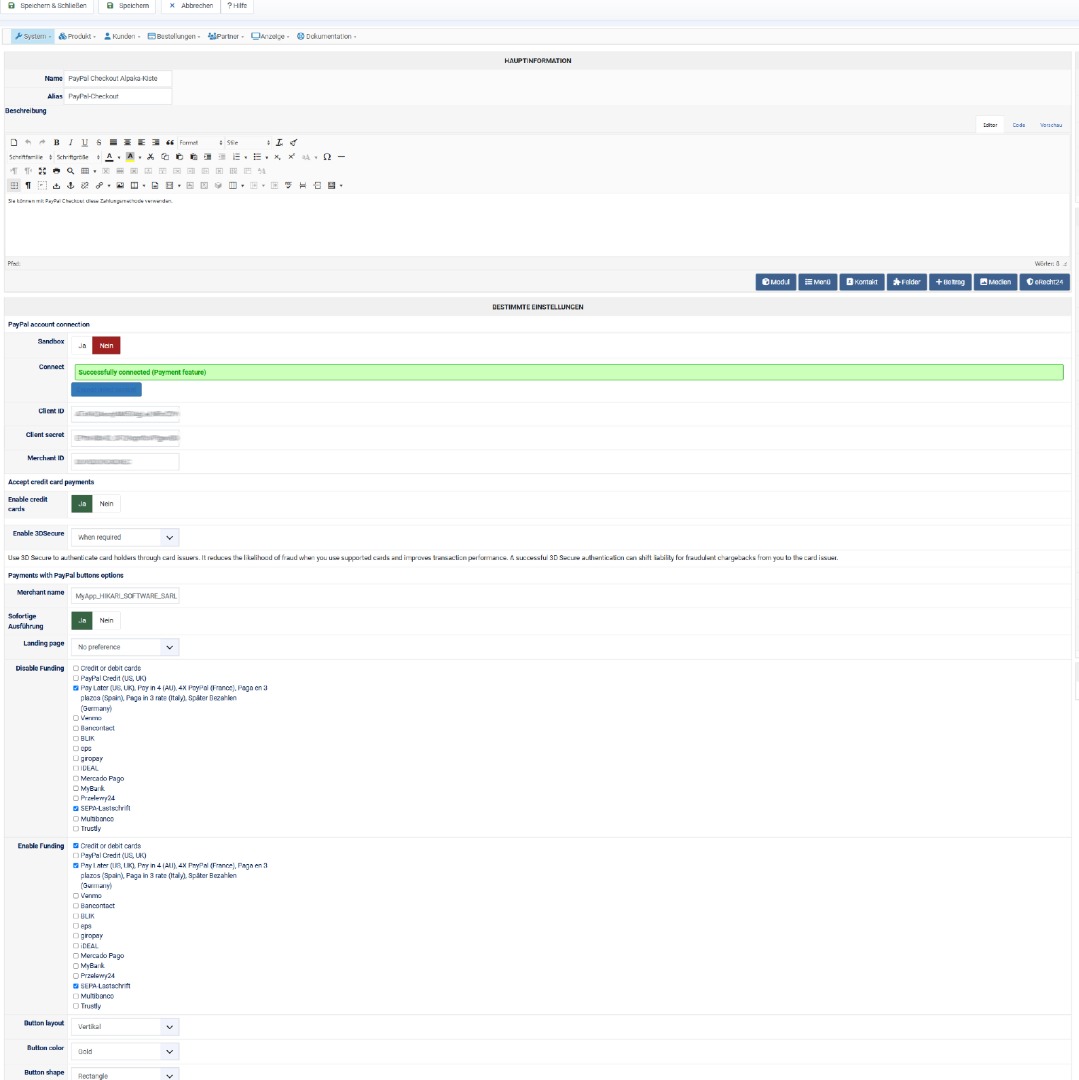

Now to continue on your topic, we are going to need these elements:
- An Url link to allow us to process some tests
- Your Paypal settings screenshot (hide secret references)
- Do you know what distinguishes the commands that present this problem?
(particularity of currency, country of delivery or invoicing, etc.)

Ich habe alle von Ihnen genannten Anforderungen erfüllt:
Der URL-Link für Tests: www.alpaka-kiste.de/alpaka-shop
Ich hoffe, dass diese Informationen Ihnen helfen, das Problem genauer zu analysieren. Vielen Dank nochmals für Ihre Unterstützung!

I think you have this issue:
Supposing that the buttons are displayed, if you click on the "PayPal" button and you don't get the PayPal payment popup, or you get a blank popup on top of the normal popup, it's likely you have a problem with the Cross Origin Opener Policy of your website. You need to configure your HTTP headers plugin, via the Joomla plugins manager and change its "Cross-Origin-Opener-Policy" setting to allow for it.
