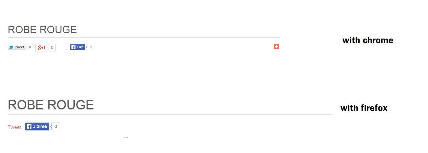

to integrate social networks in my website but I have some problems. it is not well displayed in chrome and explorer and missing some icons with firefox.

I attached you a pic of what it display in chrome and firefox. any ideas?

I just tried via Chrome and Firefox and it is working as expected on the two browsers, so as Jérome said it is potentially an issue related on a third extension installed on your browser, something like "adblock".

Ok it was the antivirus who block them. But why there is a space between google+ and facebook as shown in my screenshot?

This is managed by google directly, we give code to google and based on that code it returns the button with the properties specified.
But you can potentially add css properties to force another size, property like:
.hikashop_social_google div{
  width: 70px !important;
To add at the end of your template css file.

it works :)
