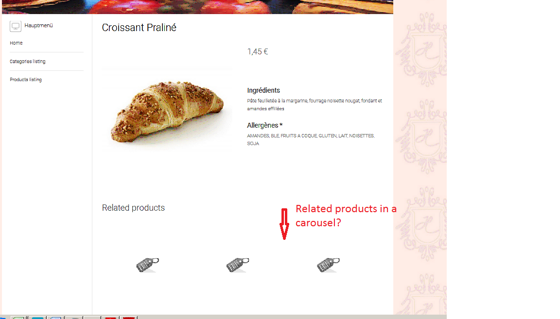

is it possible to show the related products in a carousel?
An not simply picture near picture. (see screenshot)

HikaShop comes with a carousel on board. And a module "Related products" is pre-configured. So, all you need to do is

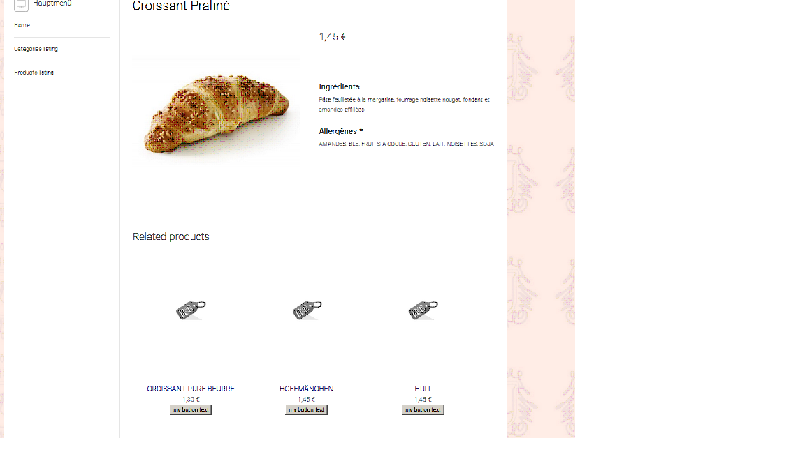

10 years 10 months ago #212624
assign related products to the products where you want ( www.hikashop.com/support/documentation/i....html#specifications ),
-> I have 4 related products which are displayed below the product. OK
make sure the "Related products" module is set as module under product pages in the HikaShop configuration ( www.hikashop.com/support/support/documen...ig.html#main_product ),
-> Associated products listing for category listing menu 144- Module is enabled. OK
then in the module settings activate and configure the carousel mode ( www.hikashop.com/support/documentation/i...odules-form.html#div ) and publish the module.
-> Enable carousel mode. OK
But the related prodcuts are still shown as normal product labels and not in carousel mode.
  • Posts: 2143
  • Thank you received: 747
10 years 10 months ago #212627
Memory wrote: But the related prodcuts are still shown as normal product labels and not in carousel mode.
Hi again,
Hmm, you have 4 products as "related"... how many columns do you have set for the module, and how many products are set per carousel slide? If it's 4 everywhere, then there won't be a carousel because all 4 product fit in one set = no reason to move... that should be clear...
If that's the case, try with both number of columns and products per slide set to 2, just to test if it works, and eventually play with the other settings and values for the carousel (see links to documentation and demo site above for reference).
If still no go:
Can you please post a screenshot of your "should work" module settings - best all, and definitely the div/carousel configuration?
And a link to the page with the product with 4 related products and the module below as configured?

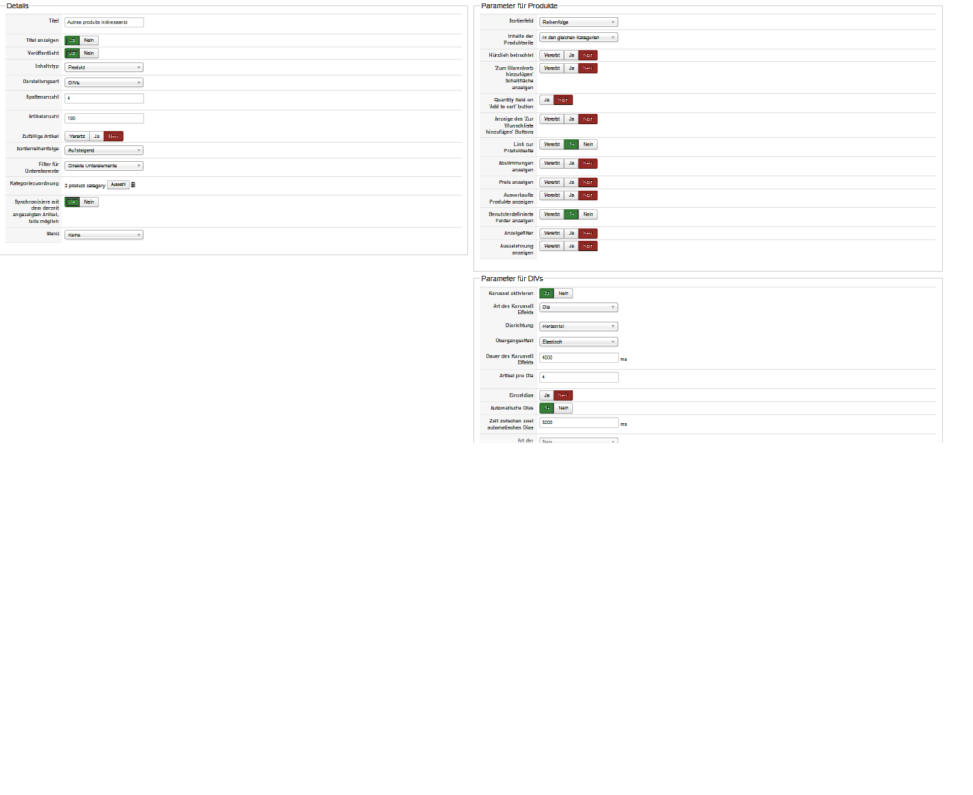

  • Posts: 28
10 years 10 months ago #212649
the link to the product is
Part of the message is hidden for the guests. Please log in or register to see it.
(see attachment)
an the configuration of the carousel you will find as a screenshot too.
  • Posts: 2143
10 years 10 months ago #212660
Sorry, the module displayed below the product is not the one as in your first screenshot. What is displayed in the frontend has nothing to do with what's configured in whatever you took the screenshot of.
In the HikaShop backend please go to -> Display (Anzeige) -> Content modules (Shop-Module) and edit the module with the ID 104. This is the one under your product pages, and most likely the pre-configured one for "Related products" (as per my first post here), also titled the same (as per frontend display). Indeed, it is configured right for related products but wrong for the carousel. Just turn on and configure the carousel, and eventually column and product numbers. It's safe to say that this will work then.
The module you took the screenshot of is, according to its title, associated with a menu item with ID 144. You can find this menu item either in the HikaShop backend under -> Display -> Content menus, or in the Joomla Menu Manager, unless it has been deleted or so.
Nothing 'personal' or so, but as suggested previously per links, it's highly recommended for you to study the documentation and visit the demo site (front and backend) to make yourself familiar with the system.
Last edit: 10 years 10 months ago by lousyfool.
The following user(s) said Thank You: Memory

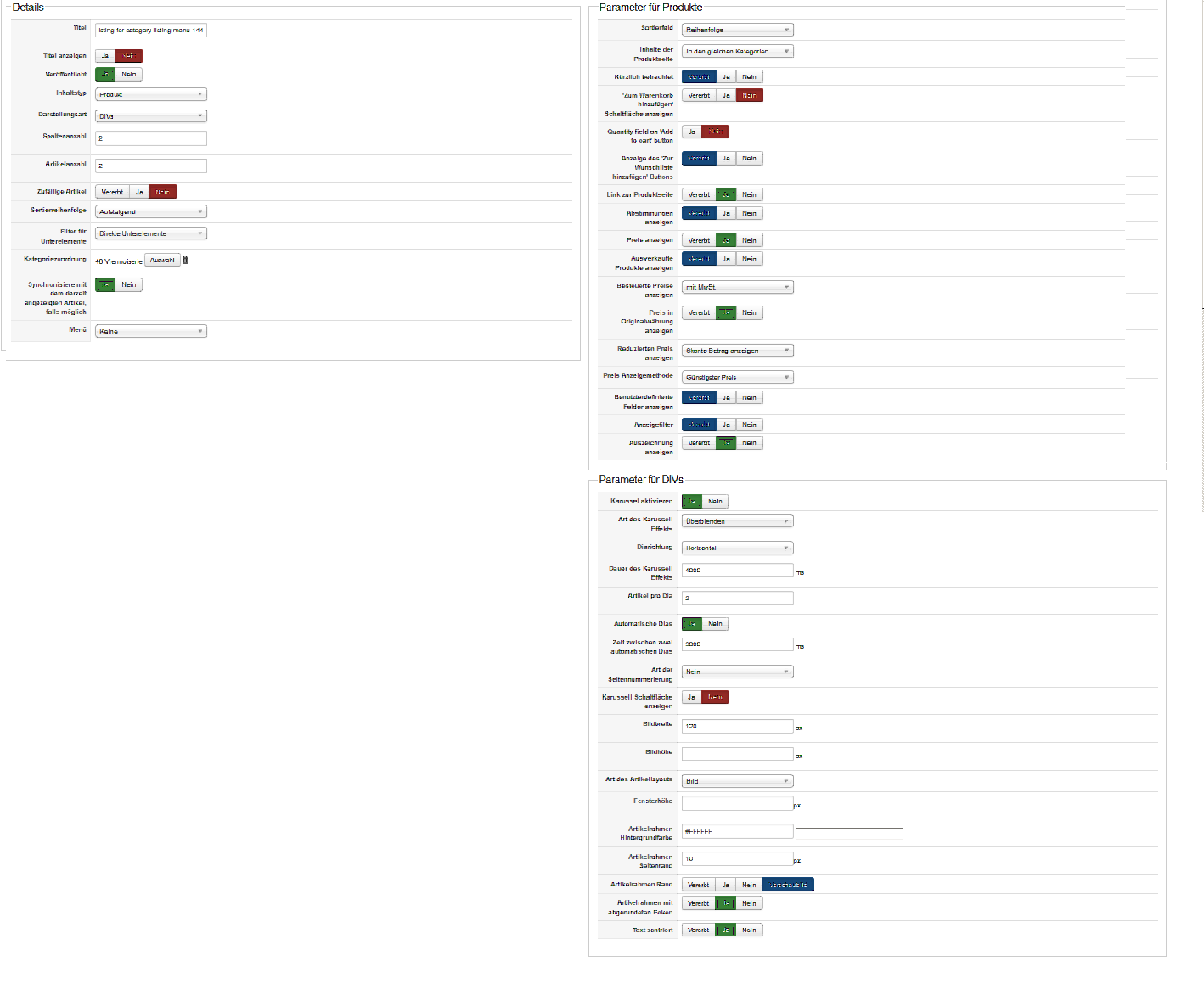

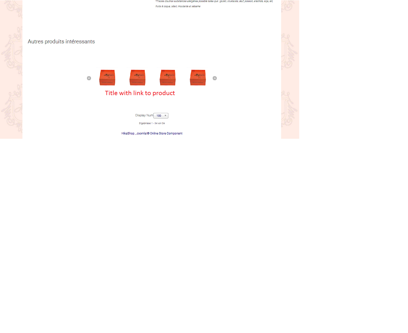

  • Posts: 28
10 years 9 months ago #216429
I think I made sth wrong in the configuration of the carousel.
It is working but I have an issue to show the tilte (name of the product) -> see printscreen and I will have a link to the product's description.
Printscreen of the carousel config attached.
  • Posts: 85860
  • Thank you received: 14101
10 years 9 months ago #216432
It's probably the setting "Type of item layout" of your module which is wrong. It's not on your screenshot so maybe it's something else. But normally, it should be set to "image and title". And looking at your carousel, it would seem that you set it to "image".
