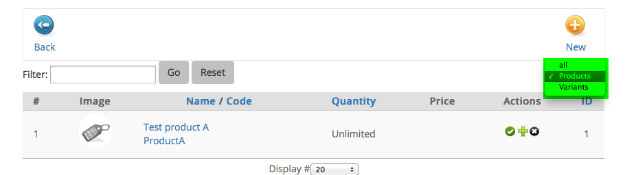

This may sound very basic question to average HikaShop user.
It is the first time I'm trying to work with variants and I have a basic question.
Can I build a menu Products listing that lists variants instead of products? So it shows each product version in the list without needing to enter the product view?
exaclty as if it was the HikaMarket Product Listing with the Variants filter activated.
Thank you.
UPDATE:
As I read many similar posts I want to clarify something:
I don't want to see a product in the list with all the variant dropdowns and so, for this there is simply the product view.
I want to see all varaints like HikaMarket does when you select Variants from the right list in Product List menu
Last edit: 10 years 9 months ago by PeterChain. Reason: Clarification
