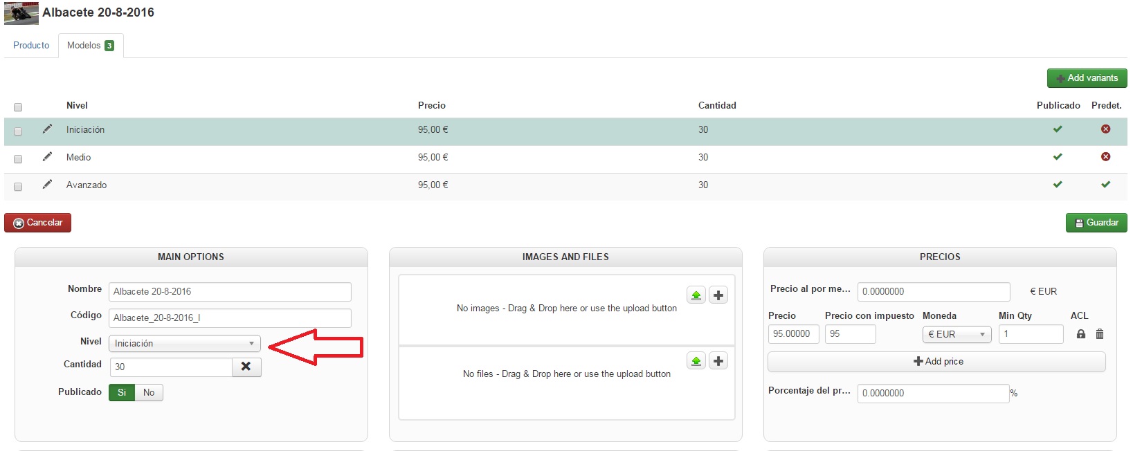

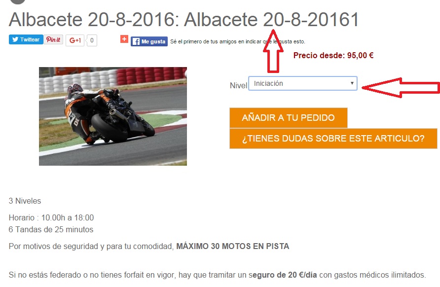

Since I updated my version of hikashop , the name of the product does not add the value of the selected charactiristic, displays the name of the product but not the characteristicvalue.

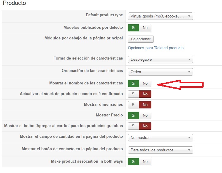

I have not changed anything on the configuration and the previous version did appear correctly , if I change "Show the name of the characteristics " the result is the same . I not edited the file product view ( only modified quantity view)
I attached screens
What can be?
Thanks for all
Last edit: 6 years 5 months ago by vaughan.
10 years 4 months ago #232148
Using that option will only display or hide the name of your characteristic in front of the characteristic dropdown, "Nivel" in your case.
Your issue is coming from the fact that you have set a name on the variant of your product, you should set it to what you want to be displayed OR unset it so that it can automatically display the name of the characteristic value of your variant.

The fix that we did to properly support the variant names is to add the line:
if(!empty($variant->variant_name)) $variant->characteristics_text = $variant->variant_name;
in the file administrator/components/com_hikashop/classes/product.php
So remove that line and that will work like you want.

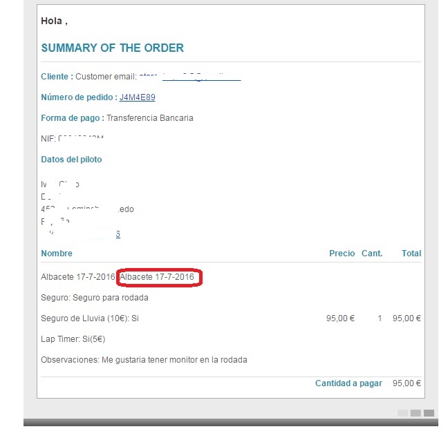

How I can make it work the same method in the email notification system administrator and client ?
Best regards
Last edit: 9 years 11 months ago by vaughan.
  • Posts: 85830
  • Thank you received: 14092
9 years 11 months ago #245050
The name displayed in the order notifications come from the product name stored in hikashop_order_name.
So if you have it like that there, it must be the same in the back end order details. So name is added there when the order is created at the end of the checkout and it uses the name from the cart. And the name in the cart is loaded by the same function in classes/product.php
So if you changed the code there, you not have the issue in the cart/order/emails.
So I'm not sure why you would have that.
Try changing the code:
$orderProduct->order_product_name = $text;
to:
$orderProduct->order_product_name = $product->variant_name;
or to:
$orderProduct->order_product_name = $product->product_name;
in the file components/com_hikashop/controllers/checkout.php, that might help for new orders.

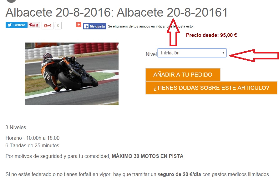

I updated my hikashop version and now y show again name product without characteristics name, like before this changes, now the code don't work
I have in product.php the line
But I don't see again characteristic in name
What can i do?? is now another code?
  • Posts: 85830
6 years 5 months ago #314450
You're using the new checkout of HikaShop 3 and 4 while before you were using the (now) old checkout.
So the line :
is not in components/com_hikashop/controllers/checkout.php anymore.
You now have the lines:
if(!empty($product->product_name_original))
				$orderProduct->order_product_name = $product->product_name_original;
			else
in the file administrator/components/com_hikashop/classes/order.php which replace the one you had to modify before.
So that's where you'll want to make your change as per www.hikashop.com/forum/product-category-...-product.html#245050
However the code you're providing in your message is in administrator/components/com_hikashop/classes/product.php and this didn't change much. So I'm not sure.
The following user(s) said Thank You: vaughan
  • Posts: 71
6 years 5 months ago #314479
Hi thanks for your help.
I delete the line if(!empty($variant->variant_name))
in administrator/components/com_hikashop/classes/product.php, and works fine.
Thanks for all
