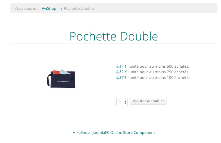

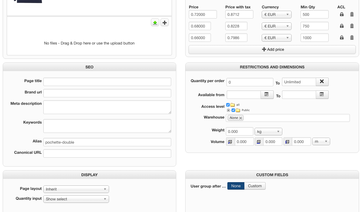

I'd like to create a product available in different quantity and with different prices. I found the "Price" area and the "limitiation" area of the product but can't find how to set it correctly.
My product has to be available in pack of 500 , 750 or 1000 pieces and the price is different for each pack.
I set the prices in the price zone, it works fine.
For the quantity I set "Quantity per order" on "250" to "1000"
And the "Quantity input" on "Select"
The problem is that the result is a list with 250 , 500 , 750 and 1000.
I want 500, 750 and 1000.
Can you please help me?
Thanks.

You should configure 3 prices with the corresponding 'min qty'.
Then, set the "Quantity input" setting of the product to 'show select price' and the customers will only be able to select the quantity among these quantities.

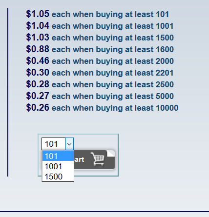

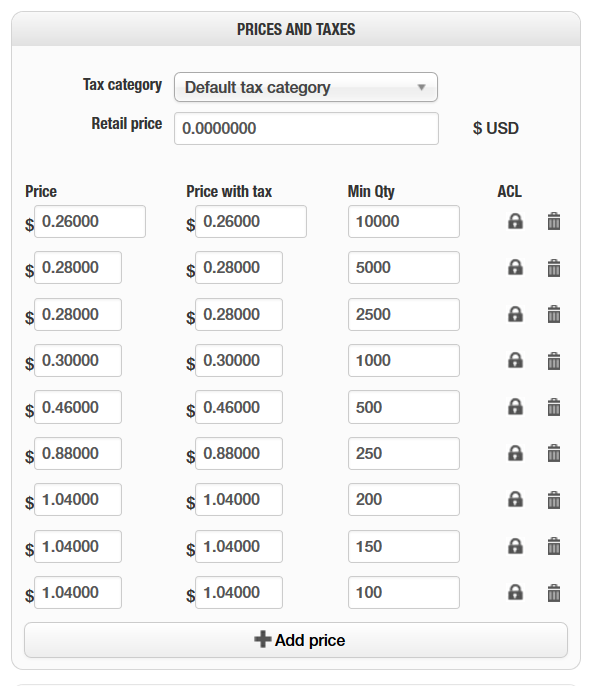

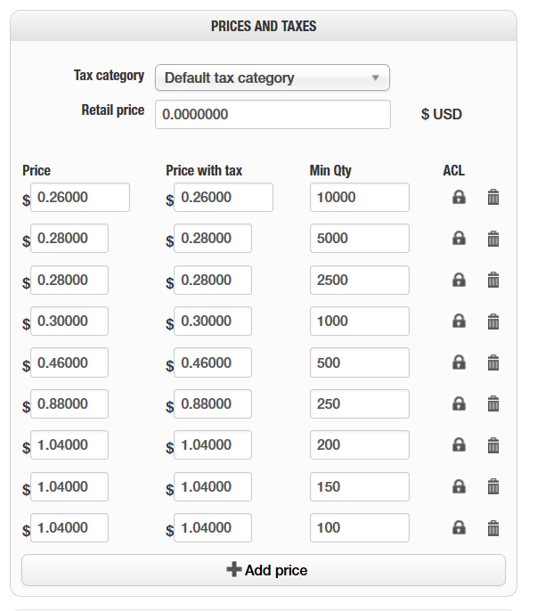

10 years 3 months ago #241619

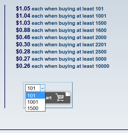

I had a similar need and was hoping this was a solution.

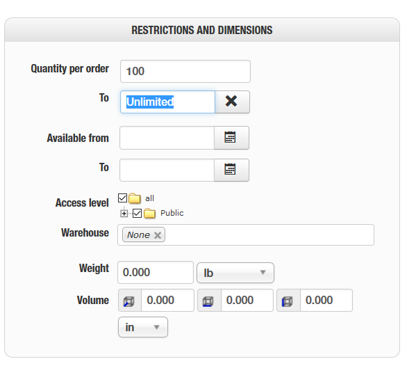

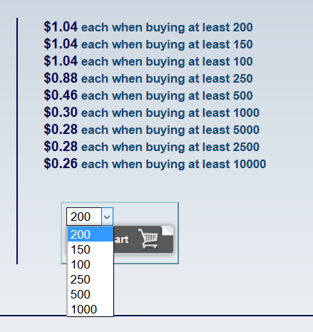

When I set this up for a product to limit purchases to specific quantities, the display doesn't look right, and the combo box presented for quantity doesn't include all quantities defined.

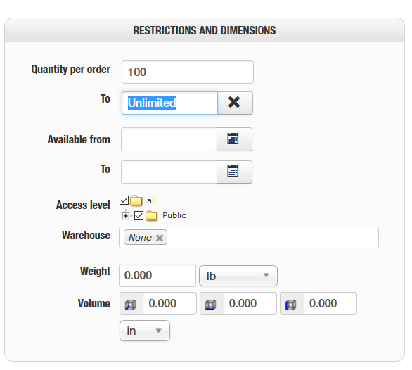

Attached are screen shots that present two issues:
1. The order of the quantities doesn't appear right. I would think these should be in order of: unit price, then quantity.
2. The combo box prompting for quantity doesn't appear properly ordered and is missing some define pricing options, e.g 2500, 5000, 10000
Also attached are portions of the product definition - pricing and restrictions.

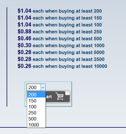

10 years 3 months ago #241673
In your case, there is the same price for different quantities, so this is not correct.
If you remove the prices for "200" and "150" quantities all the problems will be solved.

10 years 3 months ago #241707

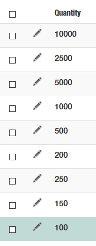

I'm not clear what is meant by "this is not correct".
From a selling perspective, the ability to specify increments and associated unit cost is a requirement.
For printed products (business cards, brochures, flyers) for example, the quantity references the size of a print run. The run sizes (quantity) may be limited by available packaging materials or any number of factors. And the unit price often is the same between quantity breaks.
Regardless, I modified the prices slightly and the order of display is by price from highest to lowest. Though cleaner, I would still maintain that ideally the order should account for both price and quantity.
Additionally, the values presented in the combo box when "SHOW_SELECT_PRICE" don't make sense to me. In the initial screen capture provided, it doesn't include all of the quantity breaks defined. At present, I'm only seeing three out of nine defined quantity breaks as seen in this screen capture.
The screen capture is from the product page, from the listing page the user can select any multiple of the minimum quantity. It appears the user can get around the quantity breaks by modifying the quantity in the cart. Perhaps there's something else I need to do for the "SHOW_SELECT_PRICE" to work from the listing page.

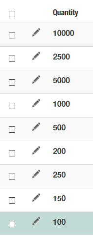

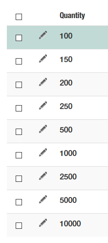

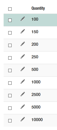

I did come up with a way to present specific quantity breaks and associated price using variants - but this isn't ideal. The quantity breaks (e.g. "Run Size") are characteristics applied to the base product, each variant has a minimum and maximum quantity associated that reflects the run size. This works well enough, though the quantity is displayed twice on the product page, once from the variant selection combo box and once in the quantity selected box.
In this scenario, maintenance is cumbersome as the order of variants appears to change during maintenance. The order is correct when the product is initially displayed. Clicking on the "Save" button on the right of the variant editing screen changes the order. Clicking the product Save button above the product restores the order.
Initial display of variants:
Display of variants after saving a variant
Perhaps I'm not understanding the intent or how to use "SHOW_SELECT_PRICE", or perhaps there's a better method to control / limit the quantity breaks a customer can select, and to specify the unit cost per quantity.

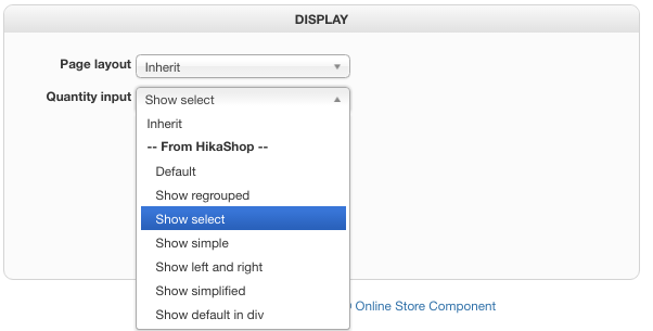

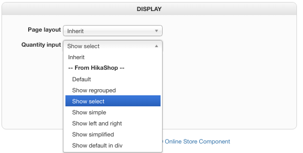

Rephaelr: If I understand your intent, change the "Quantity Input" in the "Display" section to:
"SHOW_SELECT_PRICE".
Yours is configured with "SHOW_SELECT" in the lower left of the first screen capture attachment.

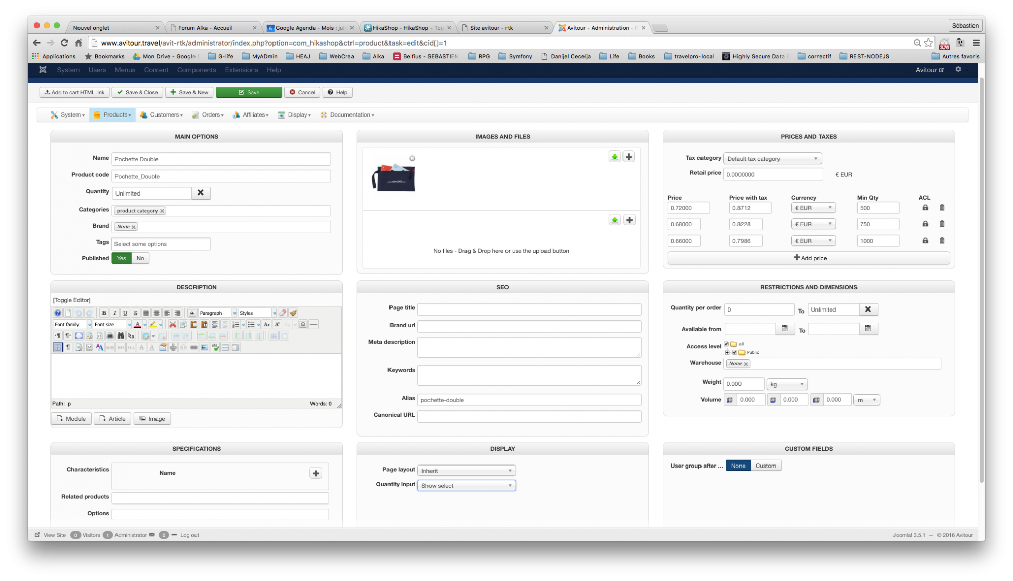

  • Posts: 12
10 years 3 months ago #242127
csymmonds wrote: Rephaelr: If I understand your intent, change the "Quantity Input" in the "Display" section to:
Hello, thanks for the answer. I can't find SHOW_SELECT_PRICE in the list... :s

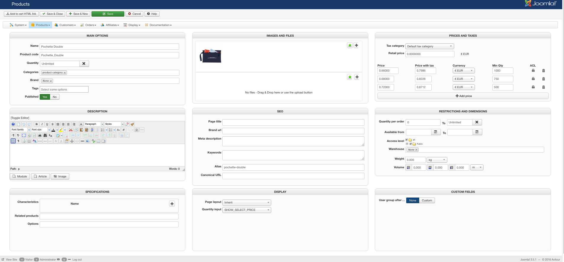

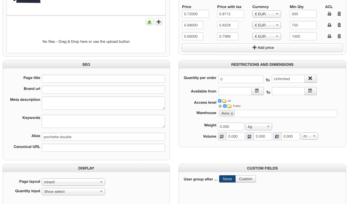

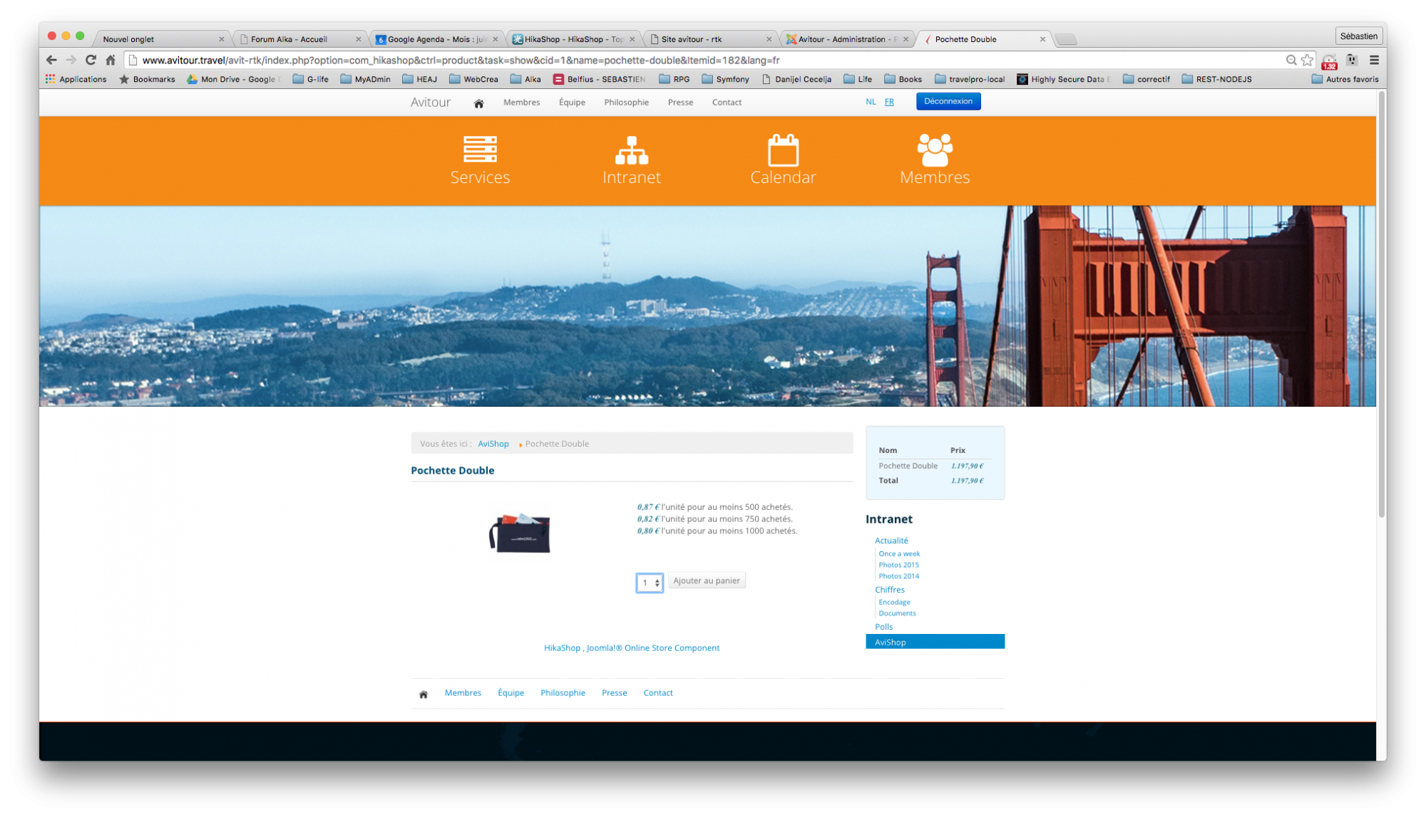

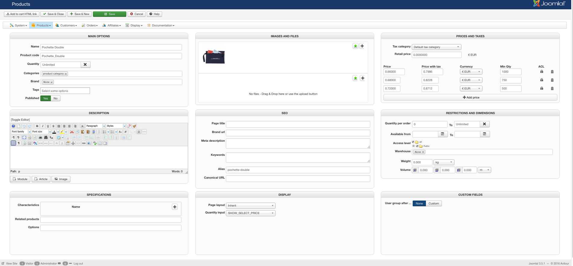

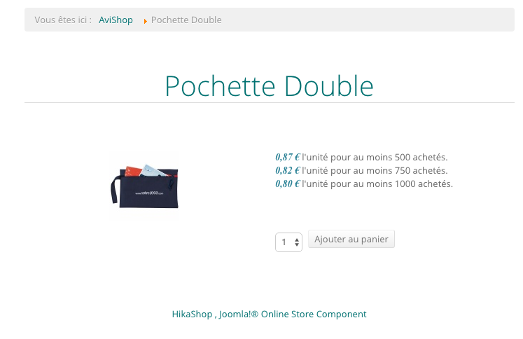

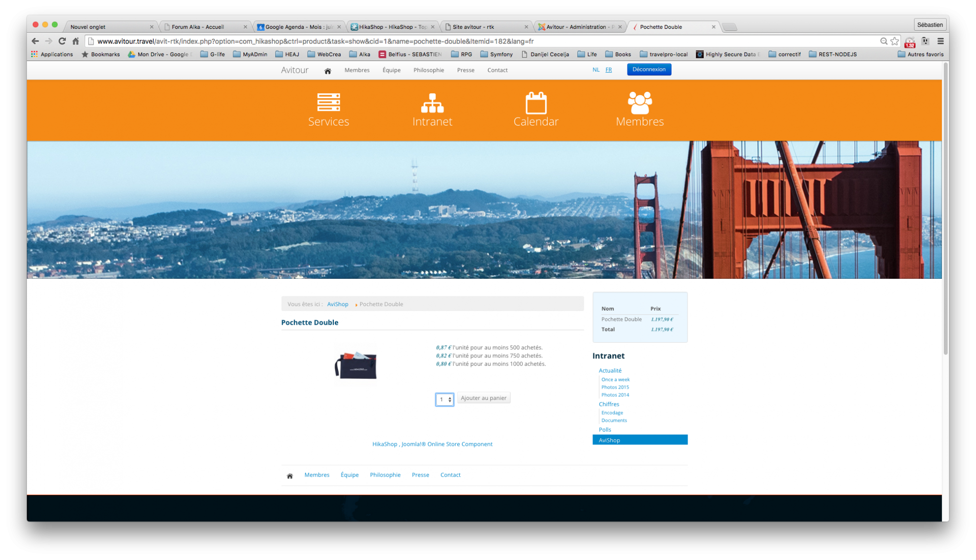

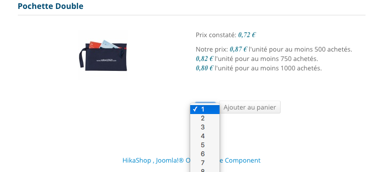

Philip wrote: Hello,
Can you provide a backend configuration of your product price AND a screenshot of an product page example to see the results.
Awaiting news from you.
Regards.
Thanks for your help.
Here is the two screenshots.
Last edit: 10 years 3 months ago by raphaelr@alkaonline.be.
  • Posts: 86104
  • Thank you received: 14203
10 years 3 months ago #242128
After the "show select" choice, you should have a show select price:
take.ms/Nk2xW
That's the one that needs to be used as I explained in the beginning.
Since you don't have it, It's possible that the problem is that you're using an old version of HikaShop.
Please make sure that you're using the latest version.

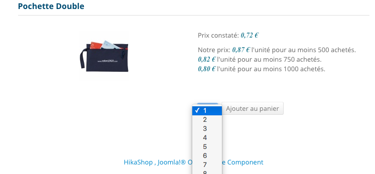

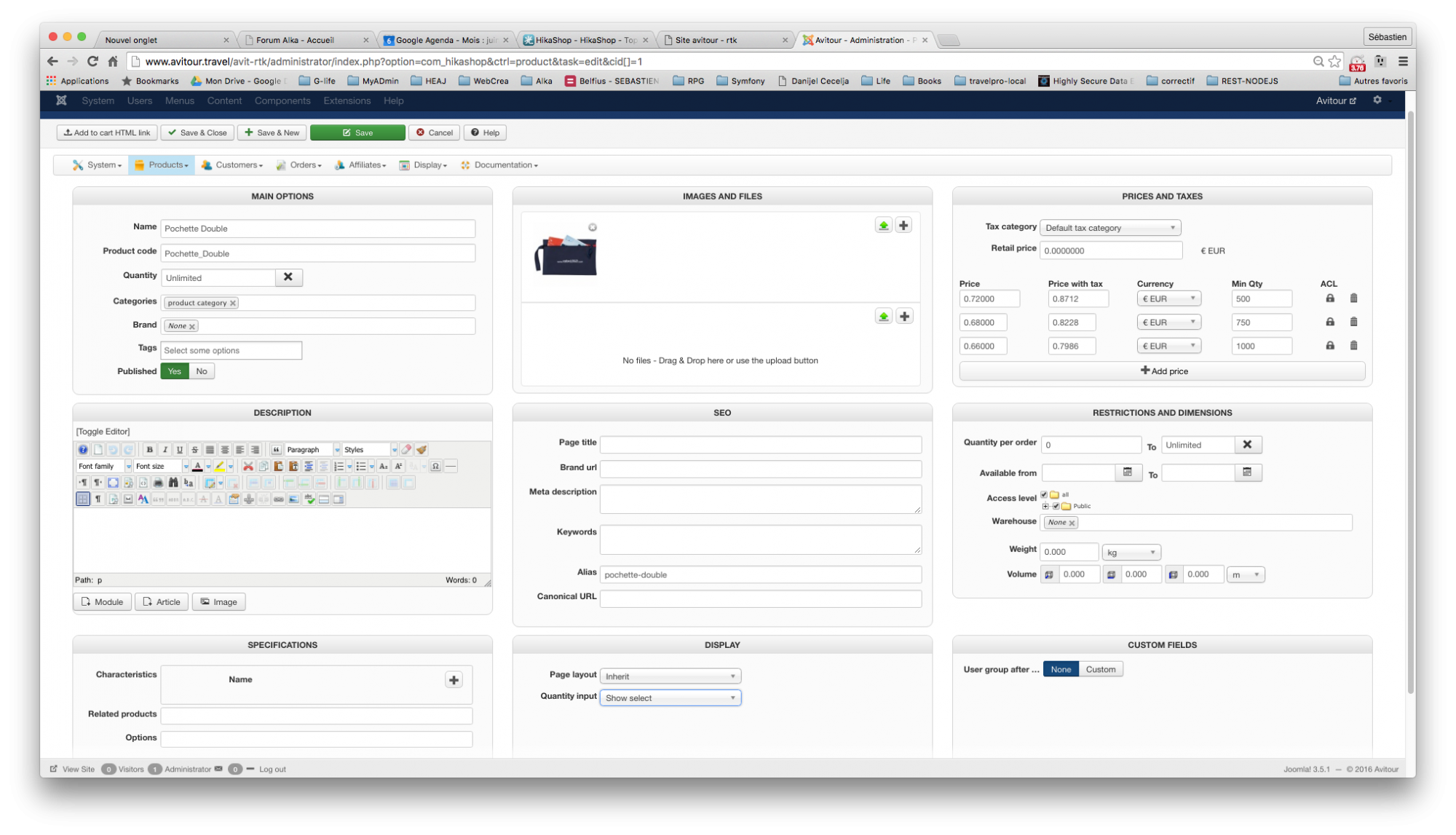

  • Posts: 12
10 years 3 months ago #242242
OK i've upgraded Hkashop with the latest pack.
Now I see "SHOW_SELECT_PRICE" in the list. But I still have the same quantity field.

10 years 2 months ago #242559
Problem solved, we had a fix on our side but not yet in the latest release.
I have edited the view "product / show_quantity" to solve that issue until we release the next version.
The following user(s) said Thank You: raphaelr@alkaonline.be

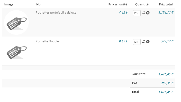

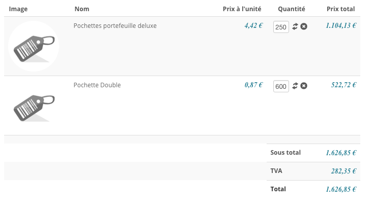

  • Posts: 12
10 years 2 months ago #243641
excuse me ton insist but there's the same problem on the checkout page.
Thanks in advance.
PS: I've a strange error after the checkout : 0 - Invalid address:
I've searched but the only solution suggested is this www.hikashop.com/forum/checkout/883603-4...-process.html#235445
But already done in the latest hikashop version.
Last edit: 10 years 2 months ago by raphaelr@alkaonline.be.
10 years 2 months ago #243697
Please replace the content of the view "checkout / cart" by this one:
