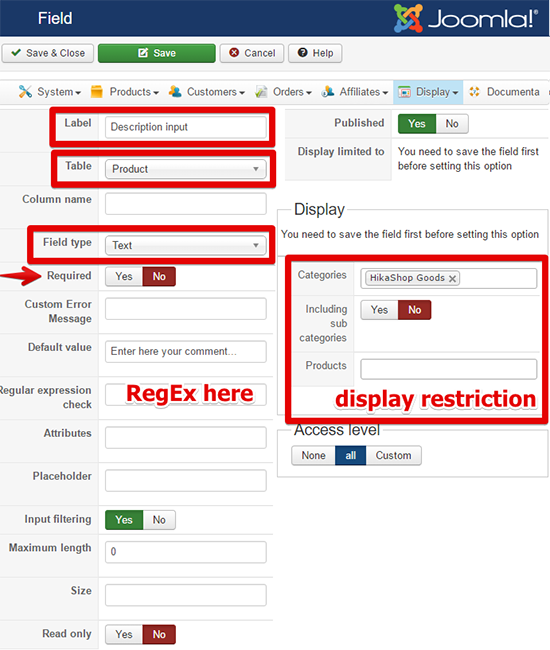

You can see here some information for create a text input, for this you must create a product custom fields.
You can reach your custom fields in Components => HikaShop => Configuration, then in Display dropdown select Custom fields.
And create a new custom fields, and reproduce this configuration, and especially part in red border.
Hope this will help you.

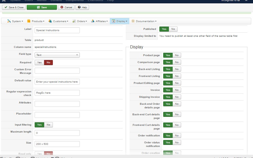

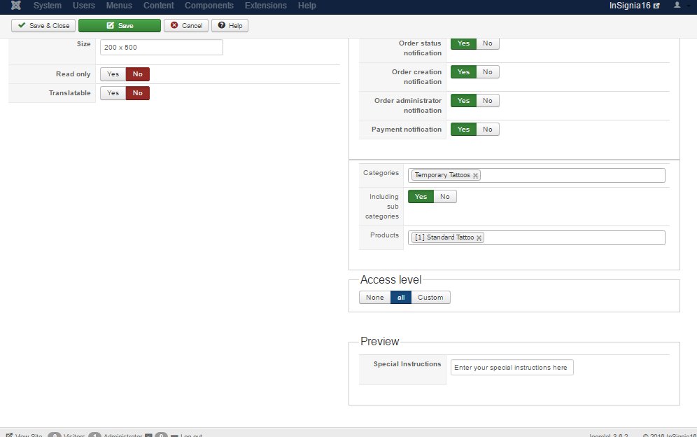

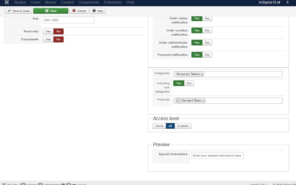

9 years 10 months ago #252916
Have attached screenshots of the set up, have I missed something as it does not display in the product?
9 years 10 months ago #252905
The solution will be to set the "table" option of your custom field to "Item"

9 years 10 months ago #252998
Perfect, thank you

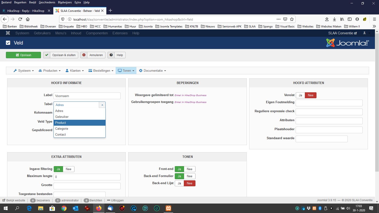

6 years 7 months ago #315209

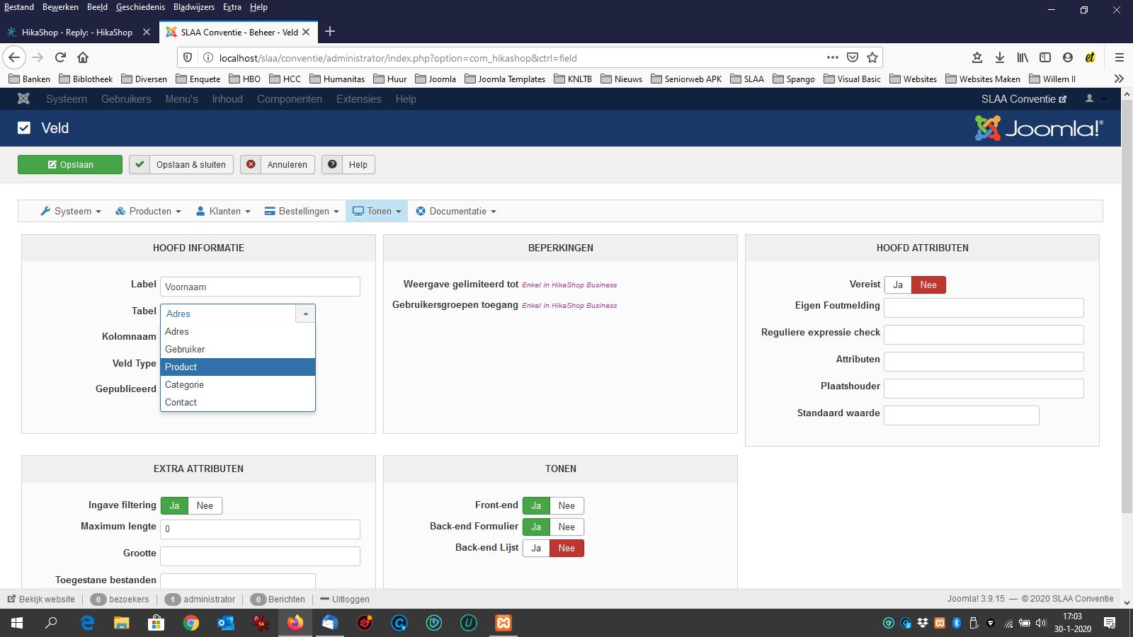

When I try to add a text box to a product there is no "item" in the "table" option as Mohamed mentioned. How do I show the field?
We use the latest stable version of HikaShop Essential: 4.2.2
6 years 7 months ago #315231
It's normal, the custom field type item is only available in the Business version.
