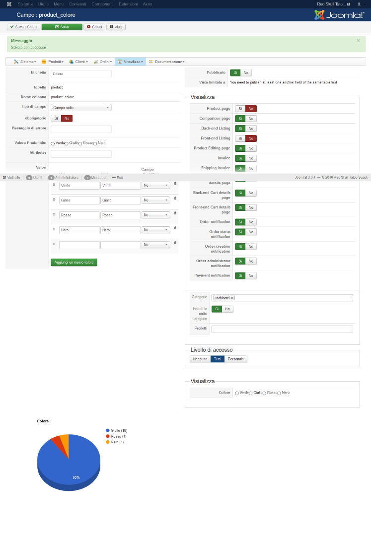

A custom field of the type checkbox or radio. And no, only one, with all the images HTML tag as values of the custom field.

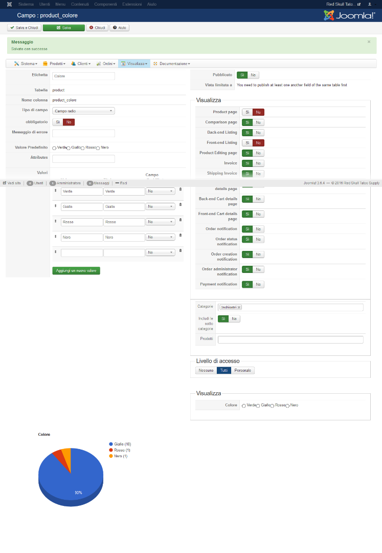

9 years 10 months ago #254774

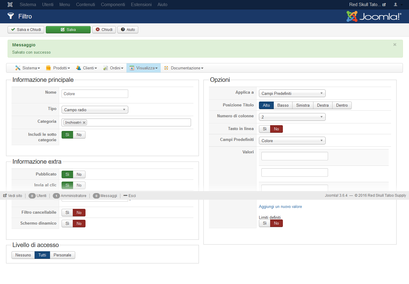

OK i understand about to use the custom fields by checkbox to selct the colour in product.
So after that I associated the inks to the colors, but I dont understand what you mean with "And no, only one, with all the images HTML tag as values of the custom field."
However I created the custom field and the filter and the module connected to the filter , but i donìt know why when I select a color in the filter(by front-end) it shows me a lot of product also of the others category.
I attach the screen shot maybe there is something wrong.
Frank
Last edit: 9 years 10 months ago by francota.

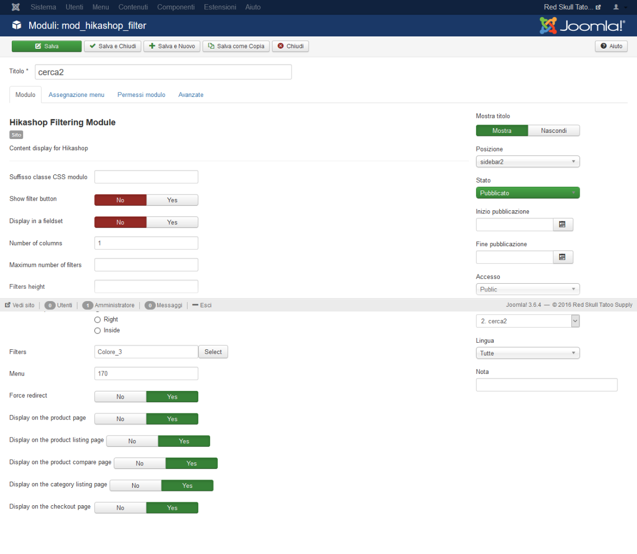

  • Posts: 86101
  • Thank you received: 14203
9 years 9 months ago #254816

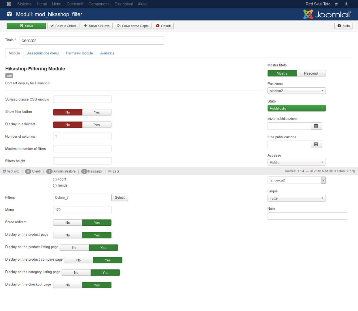

That's because you have the "force redirect" setting turned on for your filter module. So the filtering will be done on all the products of the menu with the id 170 that you set in the settings of your filter module. If you turn off that option, and that you're already on a products listing menu item, the filtering will be done on the products of that listing.

9 years 9 months ago #254856
If you want to have a filter which apply to all the products then you can have a HikaShop filter module with the "force redirect" option activated.
Remember that with Joomla, you can create several instances of the same modules. And with an extension like Advanced Modules Manager, you can fine tune the display of such modules where you want them.
So you could for example have one filter module on the categories listing which would redirect, and another one on the products listing which wouldn't redirect.

But If I turn on "force redirect" it doesn't filter anything, If I try to chose the color black in the page that I suggested you before,It seems that the filter is not applied.
Frank
  • Posts: 86101
9 years 9 months ago #254912
Apparently, you've configured the filter module to not display on the page aghi-cartuccia-2/product/listing where you told it to display the results.
It's probably why it doesn't filter anything on that page since the filter module is not enabled there.

  • Posts: 86101

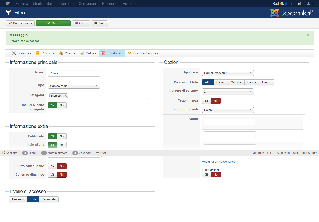

9 years 9 months ago #255219
The other problem was with the category selected in the custom field.
It had to be the "product category" category.
  • Posts: 281
9 years 9 months ago #255250

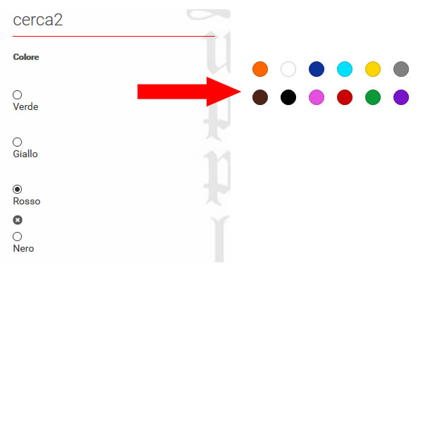

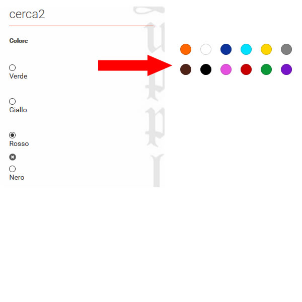

I am happy to say that now it looks working :)
Second step can i change the checkbox with example of color, same in the image??
How can i do that?:blush:
FRank
  • Posts: 86101
9 years 9 months ago #255276
It should be possible yes.
You would have to enter the img HTML tag of the image in the title of the values of your custom field and the label would be replaced by the image on the filter. Then, with some CSS to hide the radio and have each image one next to each other, you'll get that display.
