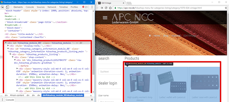

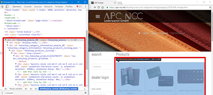

On the page:
apc-ncc.de/hikashop-menu-for-categories-...28-damenboersen.html
I see that it's not the categories listing menu item which displays the products listing, but a module which is positioned below the main area of your template: take.ms/qU7GG (the title should normally be before the green comment).
So it's normal that you don't see any pagination on that listing.
You should instead disable that module, and configure your menu item with the alias "/hikashop-menu-for-categories-listing" to display the products properly. And if the menu item is properly configured and you don't see the products listing, then the problem is probably coming from the view override templates/YOUR_TEMPLATE/html/com_hikashop/category/listing.php coming from your template and you can try renaming it via FTP to fix the issue.

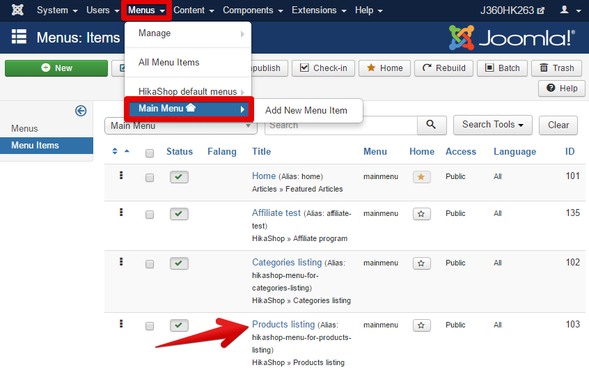

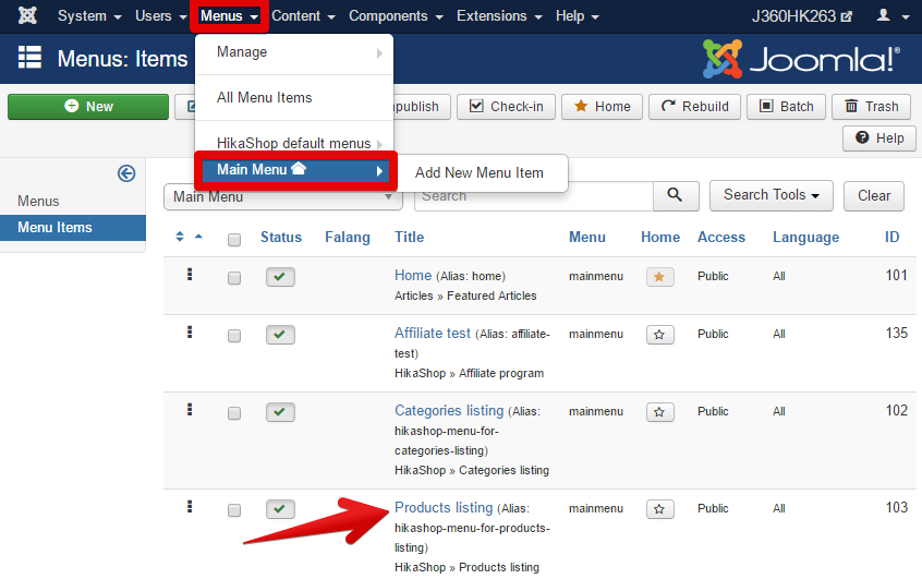

9 years 9 months ago #255198
Right now when I go to your link and by using the inspector tool, and I see this :
So right know, you already use a module, instead of an Item Menu, that you can create here :
There is a tutorial in order to define and understand different method to create and manage modules and Item Menus.
Hope this will help you.
