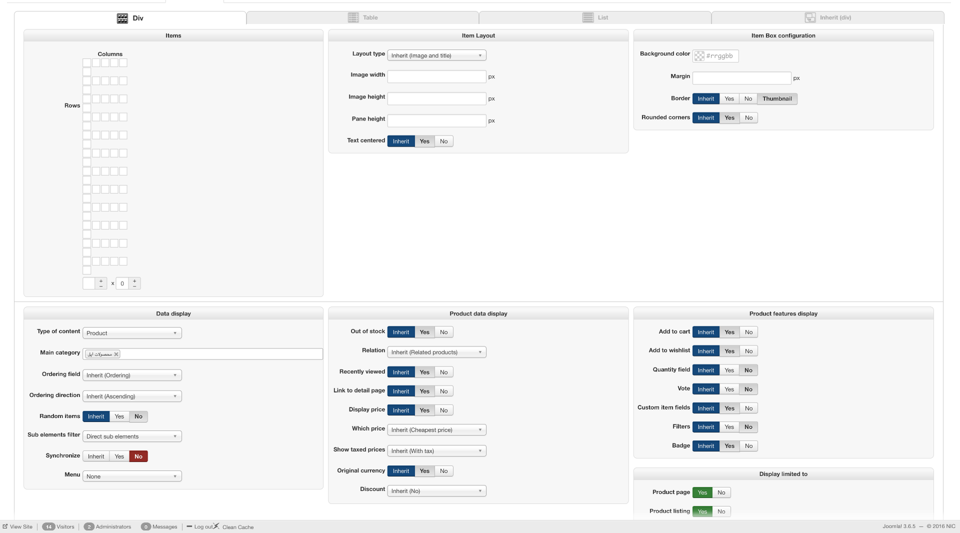

  • Posts: 129
9 years 8 months ago #258310
here is the screen shot u want.
please tell me after fixing the setting on this page what should i do next !
thanks
  • Posts: 86095
  • Thank you received: 14199
9 years 8 months ago #258339
By default after you installed HikaShop, there is nothing to do. You just add related products to your products and they show on the product page.
If they don't, it's either that you've disabled the related products module in the "modules under the product page" setting of the HikaShop configuration, or that you've modified the settings of the related products module in an incorrect way.
Regarding your screenshot, if that's the screenshot of the settings of your related products module, then the "synchronize" option should be turned on and the recently viewed setting should be turned off. The "sub element filter" setting shoule be set to "all sub elements" and the "main category" setting should be set to the main category of your shop.

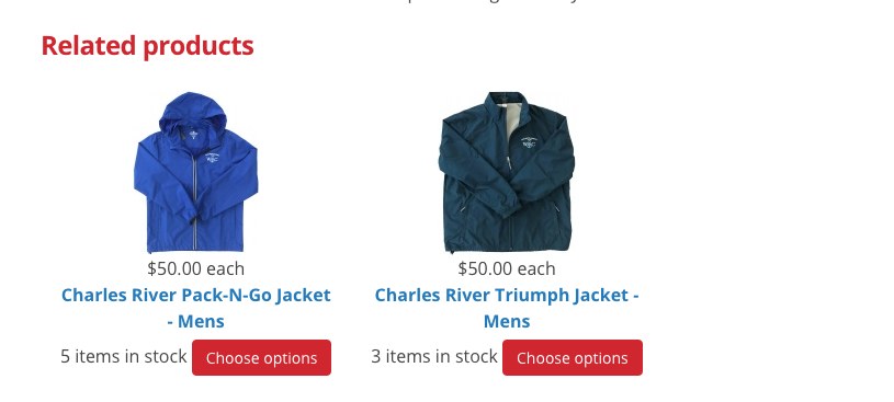

  • Posts: 109
7 years 7 months ago #303121
While I am able to display related products, I would like to know if there is a way to configure what details are displayed with the related product? For instance (see screenshot) I'd like to NOT display the bottom lines of text "5 items in stock-choose options"

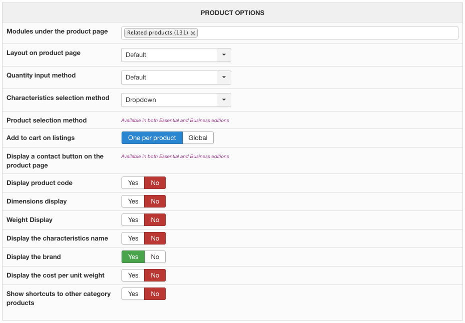

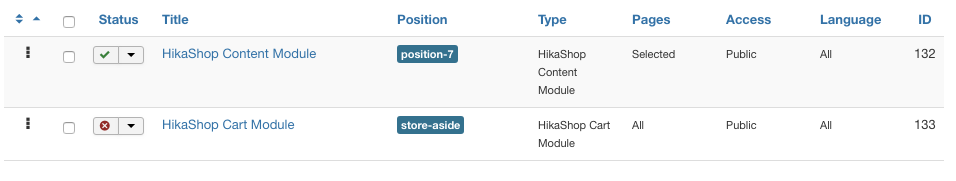

7 years 7 months ago #303250
Yes, I do have 'Related Products' entered in the field for "Modules under the product page" (see screenshot) and it's ID 131. When I go to the Joomla Modules, that module (ID 131) does not appear there (see screen shot).
Also, when I make changes to the settings under "Modules under the product page", it changes the appearance of the 'Product' and not the 'Related products'.
  • Posts: 86095
7 years 7 months ago #303251
Then you just have trashed that module and that's why it doesn't appear on the listing or something like that.
In the filters of the modules listing, select "all" in the "select status" and that might help finding it.
Anyways, if it appears in the "modules under the product page" setting, it means that this module is in the database so you must be able to find it via the modules manager of joomla, one way or another.

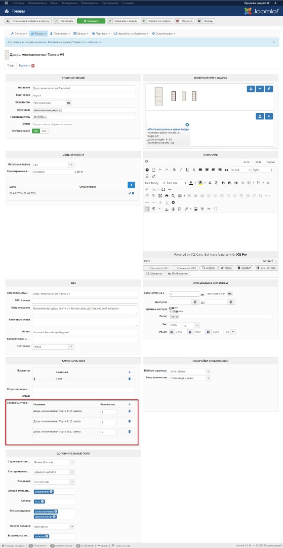

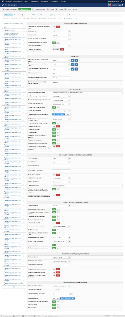

  • Posts: 220
  • Thank you received: 10
6 years 3 months ago #319315
Hello. I can’t display the related products, tell me, am I doing everything right?
  • Posts: 86095
6 years 3 months ago #319405
I don't see your screenshots properly. However, it looks like you didn't add any related products in your product. Instead, it looks like you added "bundled products" (products inside the product) to your product.
It's the setting above the "bundle products" area that you want to use.
Please double check.
